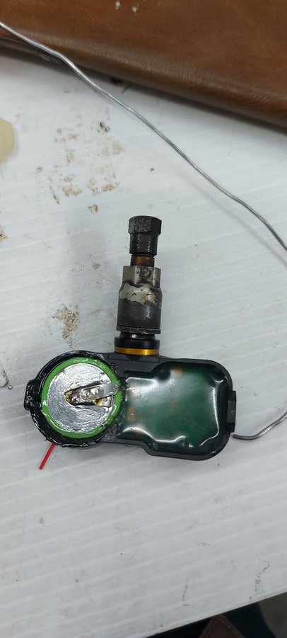

For those with GS that are approaching 10 years old, this is a cheat for when the TPMS sensors fail. Super easy, all you need is a battery, stanley knife, a soldering iron, silicon and any two part glue. Battery is a BR2450A $10, TPMS service kit 0442333060 is $4.
All you need is a tyre shop to remove the sensor for you and install a normal valve, mine did it for free. I had it reinstalled free when new tyres went on.
Cut the silicon out over the battery with a knife
Use a knife to cut the welds off the old battery one by one, saving the tab from the circuit board. Just requires a little pressure.
Once the top tab is off, cut the bottom tab off too, straighten it out.
Apply solder to the both tabs of the battery and both tabs from the circuit board separately. Then solder it in place.
Once you are happy with your soldering, mix up some 2 part glue and apply underneath, squishing the battery against it and wiping up the excess. I used Araldite. It will never again be repairable!
Once that dries, fill with silicon to seal it all up!
I know new parts are cheap in the USA and you'll probably just buy a whole Denso sensor for $60 but I enjoy reusing what I can. By the time I eventually buy all 4 in AUD, shipping, GST and import tax.....that money could have bought 2x new front tyres! Repairing also prevents the need to programming a new sensor.

Ok, so I planned on doing this on my car within a few weeks when I’m going to change the tires but I thought it was made to be serviceable.
not only that but it seems that, yet again, BR2450A is nowhere to be found in Europe…
Well this turned out to suck quite bad.
