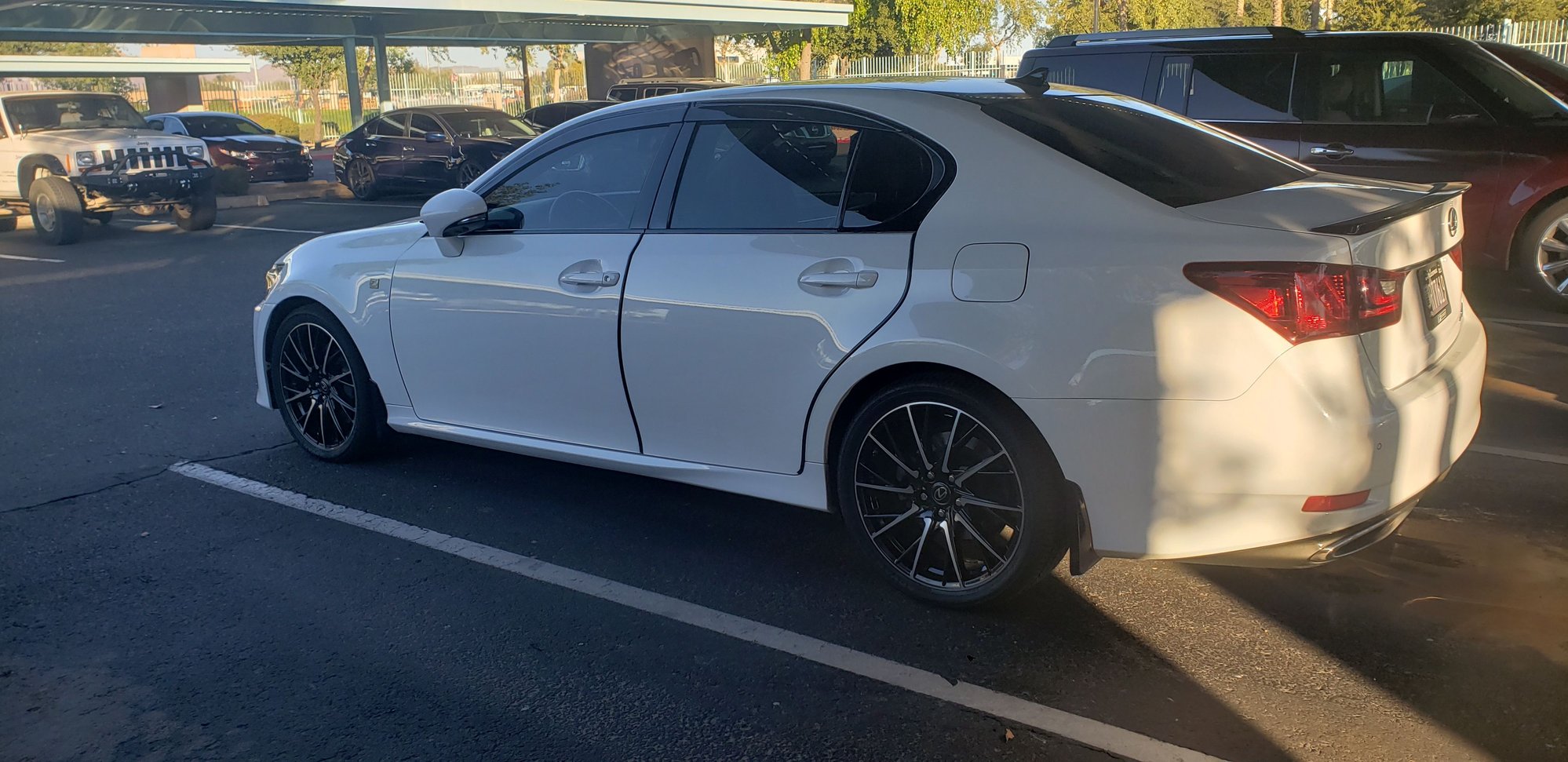

Hi all, long time lurker. I'm part of the Facebook group GStars (Lexus 4th Generation GS). Here is my car (2014 GS350 AWD F Sport). I bought it over a year ago with 86k miles, currently has 111k with no issues! The roof and bumper wrapped gloss black, chrome delete on window trim, I installed Wellvisor window visors and did a chrome delete on them as well. I have the amber delete on the tail lights, HPS intake with heatshield, and some gloss black mudguards. Currently running 255 35 19 Yokohama Advan A/S Sport + (square because AWD) which greatly improved handling. There is another cosmetic mod I am working on, will post pics when done. I have plans to lower the car 1 inch and to also get adjustable camber in the front and rear so I can set it to 0 degrees for better tire wear.

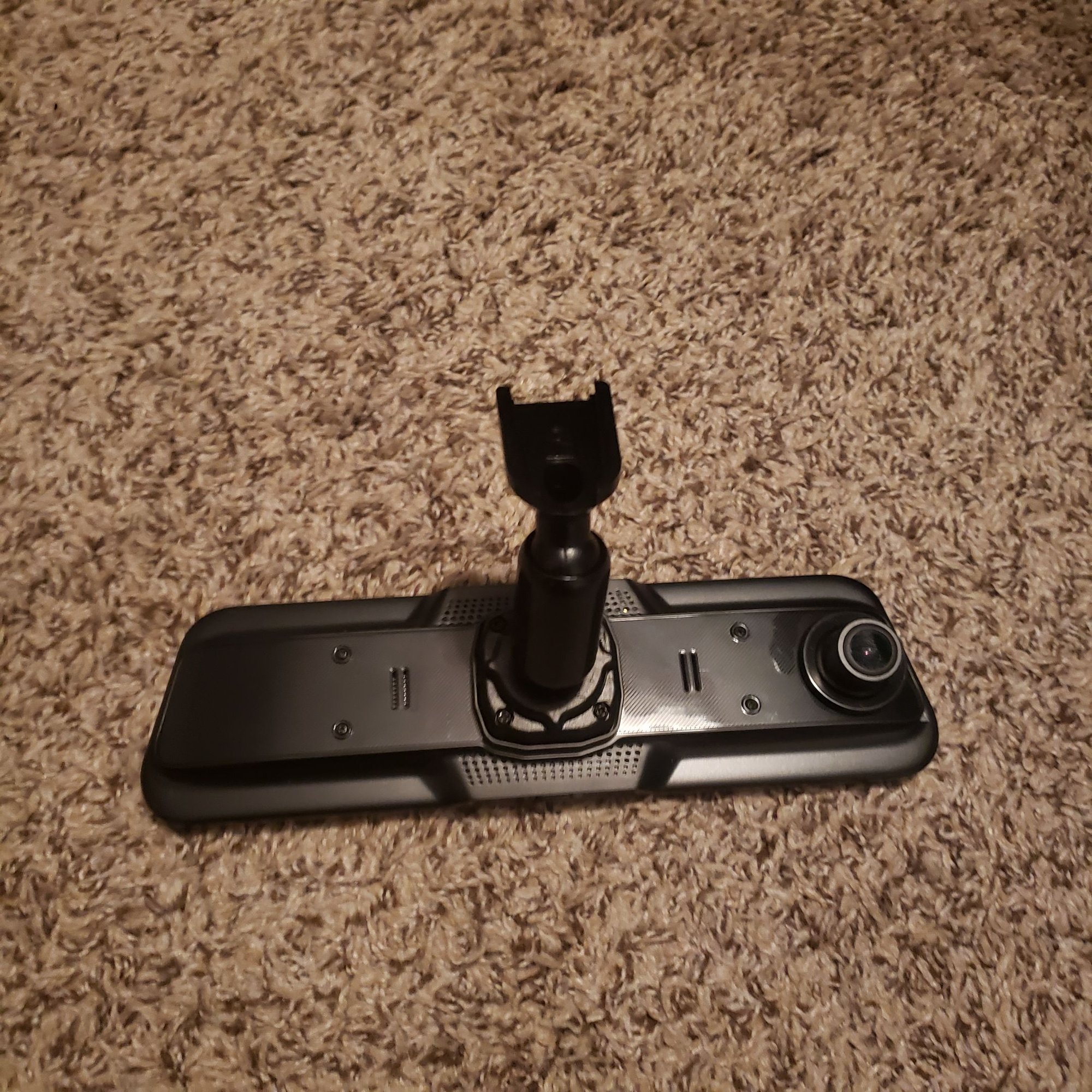

Pic of where the left and right cameras are mounted for the birds eye view camera system. This is literally the only spot they would fit due to the internals of the mirror.
Dashcam
Much wider field of view than a regular mirror and has a dash cam built in. All wires are hidden. It will also record when the g-shock sensor is triggered while the car is off (just like my other camera system). The rear sun visor has a 3mm clearance on the rear camera, so perfect fit. I can also see my blind spot because of how wide the view is. Make sure you watch the included video. One of the other benefits of this device is that you no longer have strong glare in your eyes at night from idiots with their high beams on or stupid squatted trucks.
I have included a pic of the use of the mirror with the screen on and off to show the benefit of using the 140 degree rear camera in the windshield. It is also nice being able to have the rear sunshade up all the time.

Android Auto, 360 Camera and Rear View Mirror Dash Cam turn on to record while parked are the best mods on the 4GS, and should be in every vehicle from the factory. What wheels are those?
Old Dec 6, 2020 | 09:41 PM
TheSandman's Avatar
TheSandman
Joined: Dec 2020
Posts: 2
From: Arizona
They are RC F 20 spoke reps
