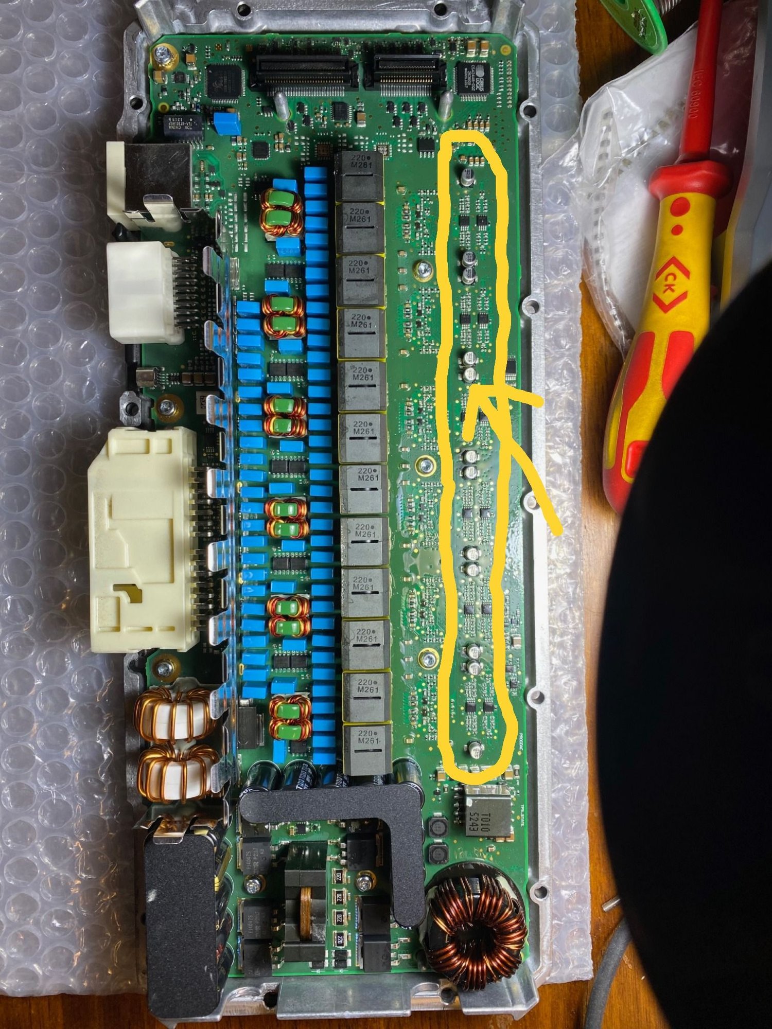

I have a 2012 GS450H (its the newer shape) with the Mark Levinson sound, a few weeks ago there was no sound. Turned the car off and on and the sound came back. Problem got worse as the weeks went on until it would take 4 or more on/off cycles to get the sound working. It was fine once it was running though.
Had code B15C3 as a memory code (hold menu button and cycle headlights 3 times) and it would appear as a current code when the audio didn't work.
I work as an electronics repair tech so I pulled the amp apart - had no signs of water damage on mine as many others seem to get but there is a row of 12 small electrolytic surface mount capacitors on the back of the D class amp chips. These are a 22uf 16V caps. They should have an ESR of about 3.5milli ohms which 10 of mine were close to that but one was at 6 milli ohms and another at 11. I temporarily replaced those two with something I had that was similar and so far the issue is gone. I have ordered the correct ones and will change them all later.
Otherwise they seem to be a very well built amp, even with conformal coated PCBs and Rubicon capacitors in the power section etc.
I think for most of them it would be a relatively low cost, straight forward repair
There are places who offer repairs but its not cheap, especially if you are handy with a soldering iron

I can't find a part/datasheet which exactly matches the amplifier IC's used (it may be a proprietary IC that they have used) but I've looked through some similar ones. Since they are a D class amp which is basically a switched mode power supply there are high frequency currents/voltages which electrolytic caps are usually not the best choice for.
My best guess currently is that those 22uf caps are used to buffer a 1/2 supply voltage point for the D class amp chips which are doing multilevel pulse width modulation as a way to make cleaner outputs. I doubt they are directly in the audio path, but a more stable supply could improve the sound quality somewhat.
The datasheets for other similar ICs go into a bit of detail around the capacitors required as they work pretty hard in that part of the circuit - a lot of high frequency current. They usually recommend 2X ceramic capacitors in parallel with a reasonably high voltage rating and an X7R or similar dielectric type which is pretty standard for an application like that (X7R caps stay pretty constant with applied voltage and temperature variation where some other dielectric types don't). Using one physically small/ relatively high ESR electrolytic cap in that location (as in the original design) will see the caps run pretty warm and fail fast.
I'm going to try a stack of 2X 10uf ceramics soldered on top of each other to replace each 22uf electro cap. In theory they should have a much lower ESR/Hence much less heat, should perform better and pretty much last indefinitely
something like these from Mouser: 810-C3216X7R1HK160AC
will report back if it works..
