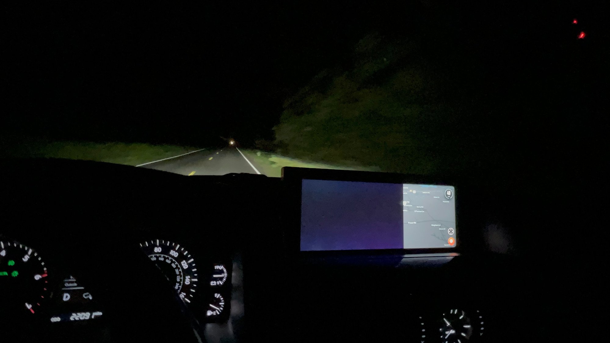

Quote: I installed on my lx570, having a constant issue with screen. Lx has front and side cameras they auto activate when you slow to stop or park. 8/10 times grom cannot go back to full screen and gets stuck in a split screen, and I lose controls to switch back to oem or grom (media) button. Only way I figured it keeps working is I disable the auto the front and side cameras which I need for a big car like lx.
updated, firmware etc disable the auto map feature. It just don’t work.

Was this issue ever resolved?
