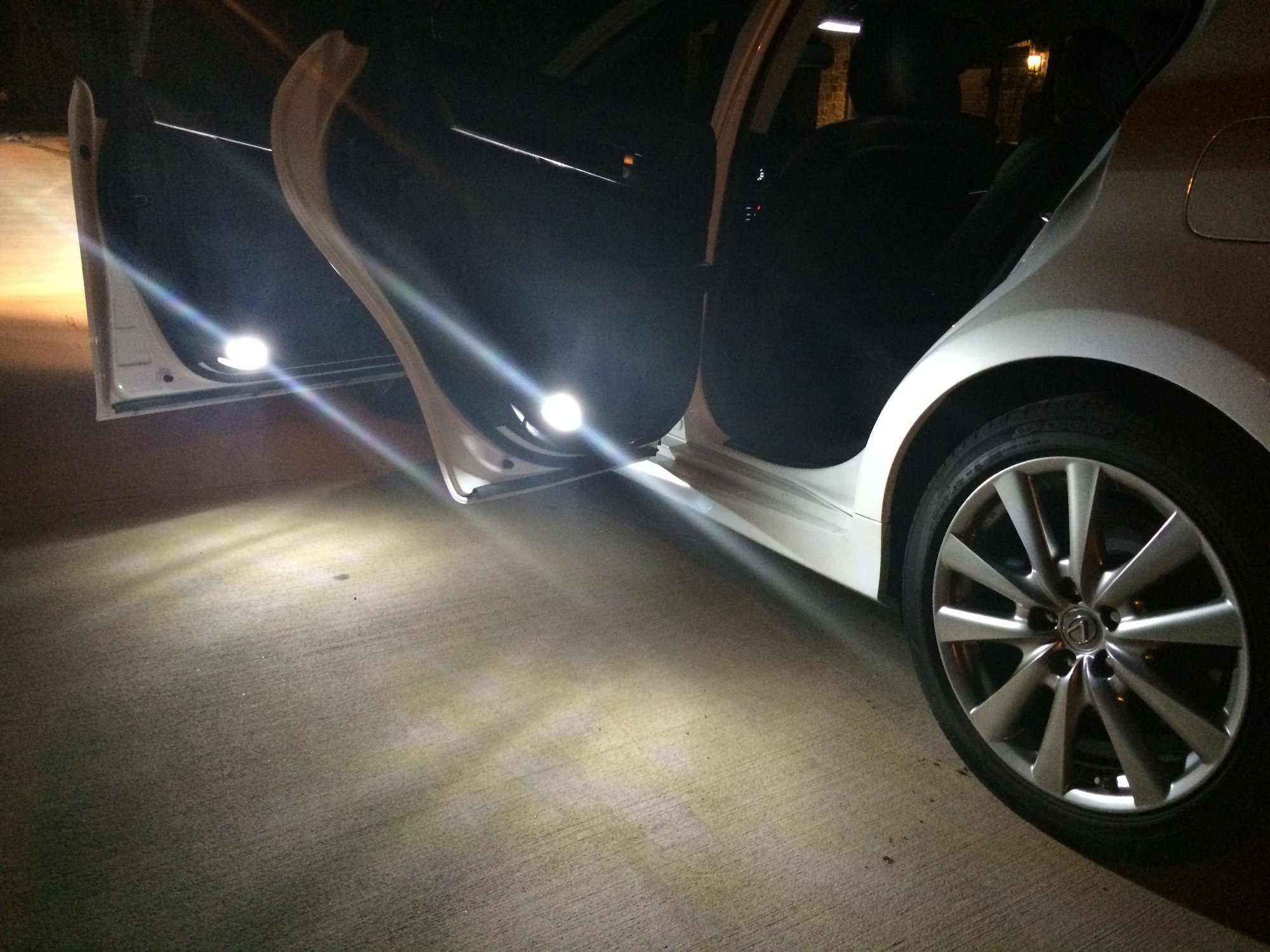

Just received and installed mine... The projector needs to be moved a bit as the image is cut off my the door jam weatherstripping. I fixed one on the spot. I'll go back and fix the other when I'm not so lazy... Pleased with how they look. Wish it was brighter and sharper, but happy non the less.
Attached Thumbnails Changing the door welcome courtesy light.-photo703.jpg   Changing the door welcome courtesy light.-photo591.jpg

Well, yardie beat me to it. I had the same issue with the angle of the projector being off (and the door cutting it off). It took a few minutes per side to get them where I could live with them. Not the best design (at least on mine), but not hard to correct. Steps below
The keyhole slots used for adjustment were too narrow to get a screwdriver fully into the slots (Used a 00 Phillips). Didn't want to risk stripping them so I removed the clear plastic cover held on by 3 screws.
WIth the cover off you can see another set of holes.
I moved to these holes and skewed the projector as for toward the door opening as it would let me.
Before
After
I am pretty happy with the outcome. Like yardie said, wish they were sharper/brighter, but what can you expect for $20....
