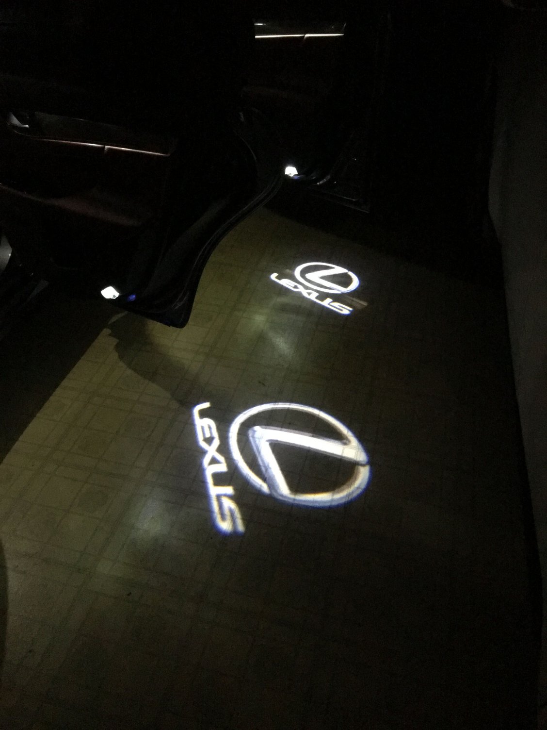

Late to the party - but just got these "Forever-lens door projector Fits Lexus Models(TE006-L)" from Wind Fire Auto. Look pretty slick and project a very crisp logo (please don't mind what looks like dirt dust - there is heavy pollen everywhere right now in my area):
