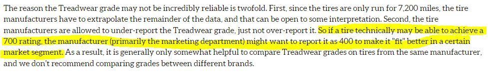

Small point but potentially useful when doing tire comparisons... Tread wear numbers are not exchangable between brands. Odd I know but Pirelli's version of, say, 700 and Michelin's will be different. Like-brand is a lot more predictable, and I've found that brands with sub-brands (like Firestone/Bridgestone or Goodyear/Kelly) are still matched up pretty well. Really one thing I'd like to see out of a tire is a durometer number, that would be interesting to see differences maybe.

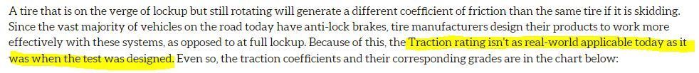

A couple things I found interesting on the "official" tread and traction ratings are below. They are quoted from TireRack. Seems strange to me why anyone would under report tread life but I'm sure there's logic in some marketing folks minds. The traction rating quote makes sense to me.
I dug around in threads a bit more for discussion of the 245/40R19 fit and it seems like for most folks it works fine. The 245/40R19 also come up as alternate tires at Discount Tire and chatting with their Rep online, any alternates they list should fit without any issues at all. For those wondering, here's what the difference is between the two.
These couple of posts about the 245/40R19s rubbing seem to just be anomalies and possibly related to spacers or something else strange going on - I've included them just for folks who might be researching. I did find a lot more folks confirming the 245/40R19 on the front work (in a mix of RWD and AWD scenarios).

Thanks @fourthmeal ! From what I read there should be at least some logic behind how the tread ratings come about but I completely agree that they often don't seem to correlate to the tread ware warranties. The Yokos being 440 while the Pirellis are 740 seems off. I'd expect the Yokos be be a bit lower since they have a 55k tread warranty but not that much lower - something in the 590 range would seem to make sense. The question I wasn't sure of when I read about how the test was done had to do with the "reference tire" used and whether it's a reference tire used for testing all makes/models or if a brand uses one of it's tires as the reference.
I hadn't seen your post as I was writing the one just before this - but it also seems like some companies might play with lowering their numbers artificially even though that doesn't make sense to me why a company would do that.
