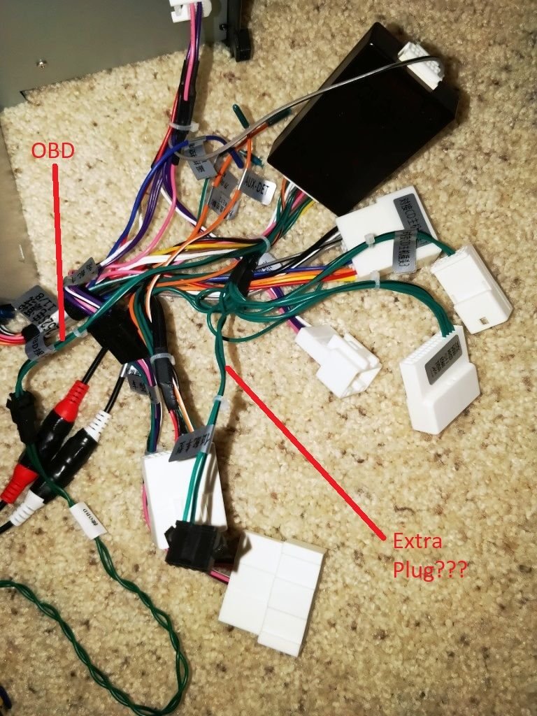

Originally Posted by MX73
If you haven't installed the unit in the car, what harness on the HU did the OBD2 cable come off of? I don't know what the 5 pin harness is for, obviously it pulling data from the OBD2 system and displaying them on the screen.
I haven't installed yet, still waiting on my backup camera.
Here is a photo of my harness. Still confused of that extra plug.
Looks like the connector is going into the CAN-Bus adapter. I'll have to look at mine.
The Extra plug, I left alone for a few weeks until I decided that maybe it was the OBD2 connector. It didn't hurt anything and I didn't notice any missing functionality.

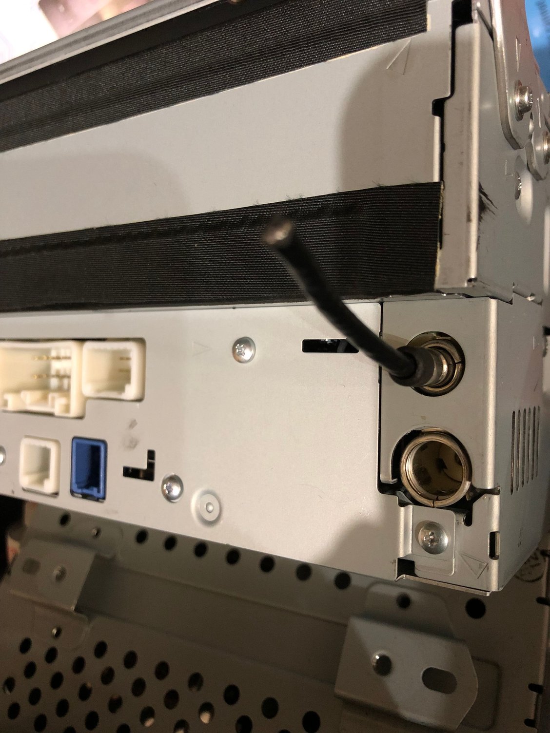

Do you have a photo of the factory GPS antenna wire/plug? Can't seem to find it, I don't mind try splicing as a test subject, just need to know what it looks like.
I’m pretty sure this is it, but I’m not positive. I cut it because I couldn’t get it unscrewed. I would tie into the other end that is still under the dash. What do you think?
Old Dec 5, 2018 | 06:06 PM
  #100
MX73's Avatar
MX73
Joined: Mar 2015
Posts: 1,631
Likes: 299
That's the factory radio antenna. Lexus has two diversity antenna.
Ah. I don't have the OBDII plug on the Tesla harness. I'm going to email the vendor. Ahhh. the joys of being 1st. lol.
Oh, I thought just the big one below it was the antenna. There wasn't a connection for the one I cut. Where is the GPS antenna then?
