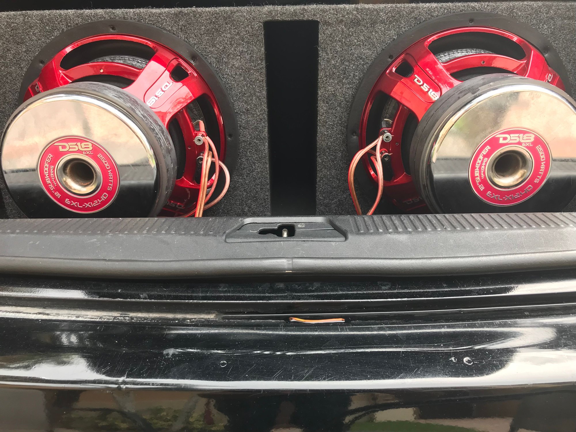

What’s up crew?? I have a question I’m pushing two amps subs
mid highs etc. my alternator is charging low but even when it wasn’t still had issues with the system cutting off. Has anyone here ever upgraded there unit and can recommend a brand? I’ve seen some online 400$ but also seen some on here saying the cheaper eBay ones were decent. I found one for a little over 200$. Any direction pointers or advice is greatly appreciated. Thanks in advance
