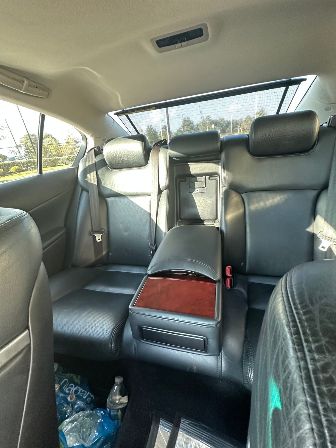

I retrofit an LS 460 rear armrest into my 3GS
Had to widen some one bolt hole.
cut about 5 inches off the bottom of the one back plate door. And it's in.

Was wondering which year you got the LS armrest from? Also would you be able to take a pic of the section you removed from the rear access door?

it came from a 2008 I just unplugged the wiring harness attached. Only con it doesn’t fold up completely but it will stay folded up. May have the foam cut and redone to make it fit down the road. It other than that I love the extra wood grain and extra storage. Here how much I removed. My key fob for size reference. Thanks for the interest!
