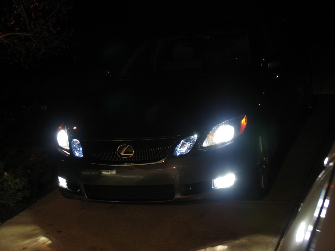

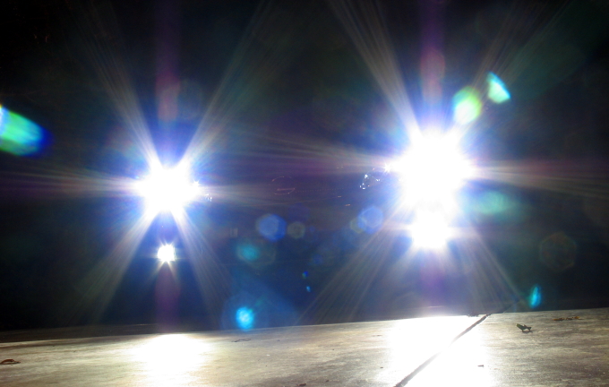

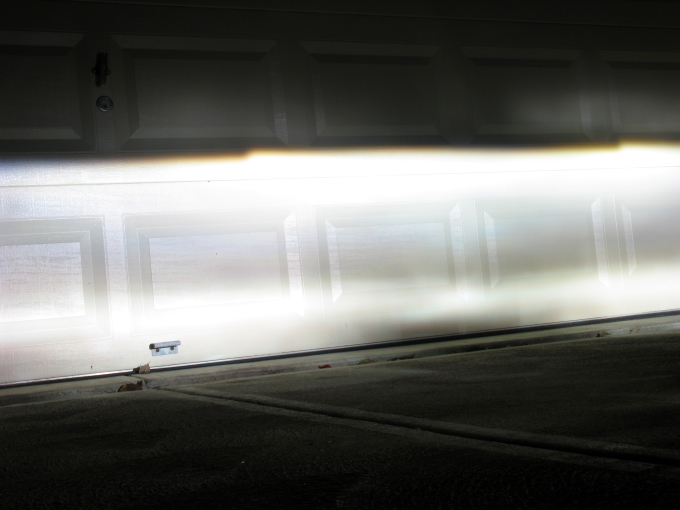

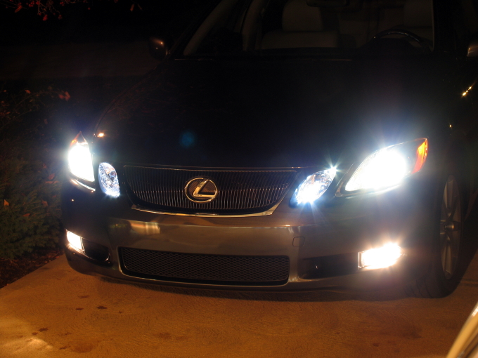

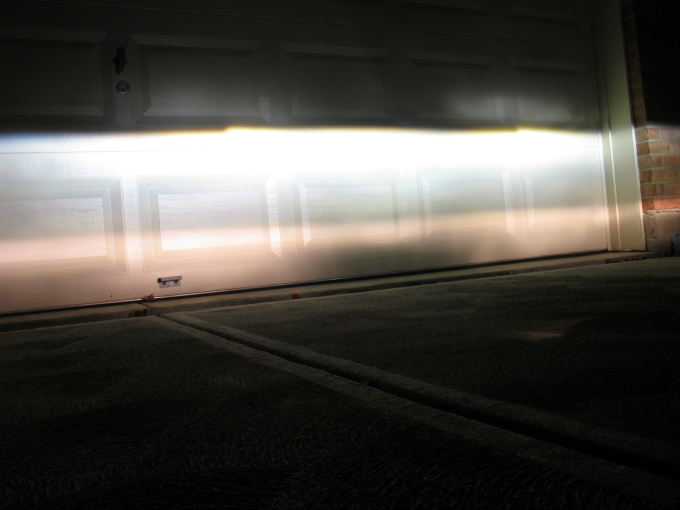

Installled the Xenon Depot 4300k fogs last night.. took about 2hr taking my time and removing all the plastic sheilding under the front for easier access. Very happy with the results.. Fogs match the Low Beams perfectly now and are much brighter.. On the drivers side i just stuck everything to the side of the window washer fluid tank.. it was a clean flat surface and looked like it stayed dry as there were no water marks/stains on it. On the passenger side it's all stuck to the top side of the wide square plastic tubing of the brake vents.. again another flat area that looked like it stays pretty dry. Ran the wires (lead to positive on battery) along both sides and lock-tied them where i could.. Pretty clean install, can't see anything at all once all the plastic engine covers are back on. I used industrial outdoor 3M double sided tape in addition to what was included to secure everything.. Results below.. Now, what's the hack to get the fogs to stay on with the brights ?
Before (with PIAA White Bulbs)..
After..
After..
After.. cool effect
