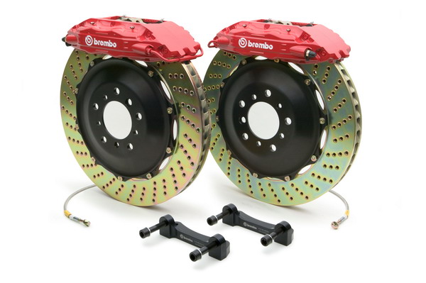

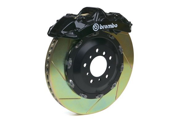

Brembo:
Brembo currently has not released the production pieces for the 06-up GS Series as of yet. They require 3 kits to build "special orders" or 6 kits to finalize full-production pieces. I've been speaking to them concerning applications. Here are some options:
A) -355mm (13.98") (Cross Drilled or Slotted Avail)
-If Production - MSRP: $3,295.00
-If not Production - MSRP: $3,875.00
-4 Piston Cast Caliper
-Std. Colors: Red, Black, or Silver
-Custom Colors Available at $375.00/axle
-2 Pads/Caliper
B) -380mm (14.96") (Cross Drilled or Slotted Avail)
-Brembo Will determine 4, 6, or 8 Pistons required
-If Production - Approx MSRP: up to $4,295.00
-If not Production - Approx MSRP: up to $4,995.00
Brembo Assorted Colors:
Brembo Silver 8-Piston (Drilled)
Brembo Red 4-Piston (Drilled)
New Brembo 6-Piston (Slotted)
