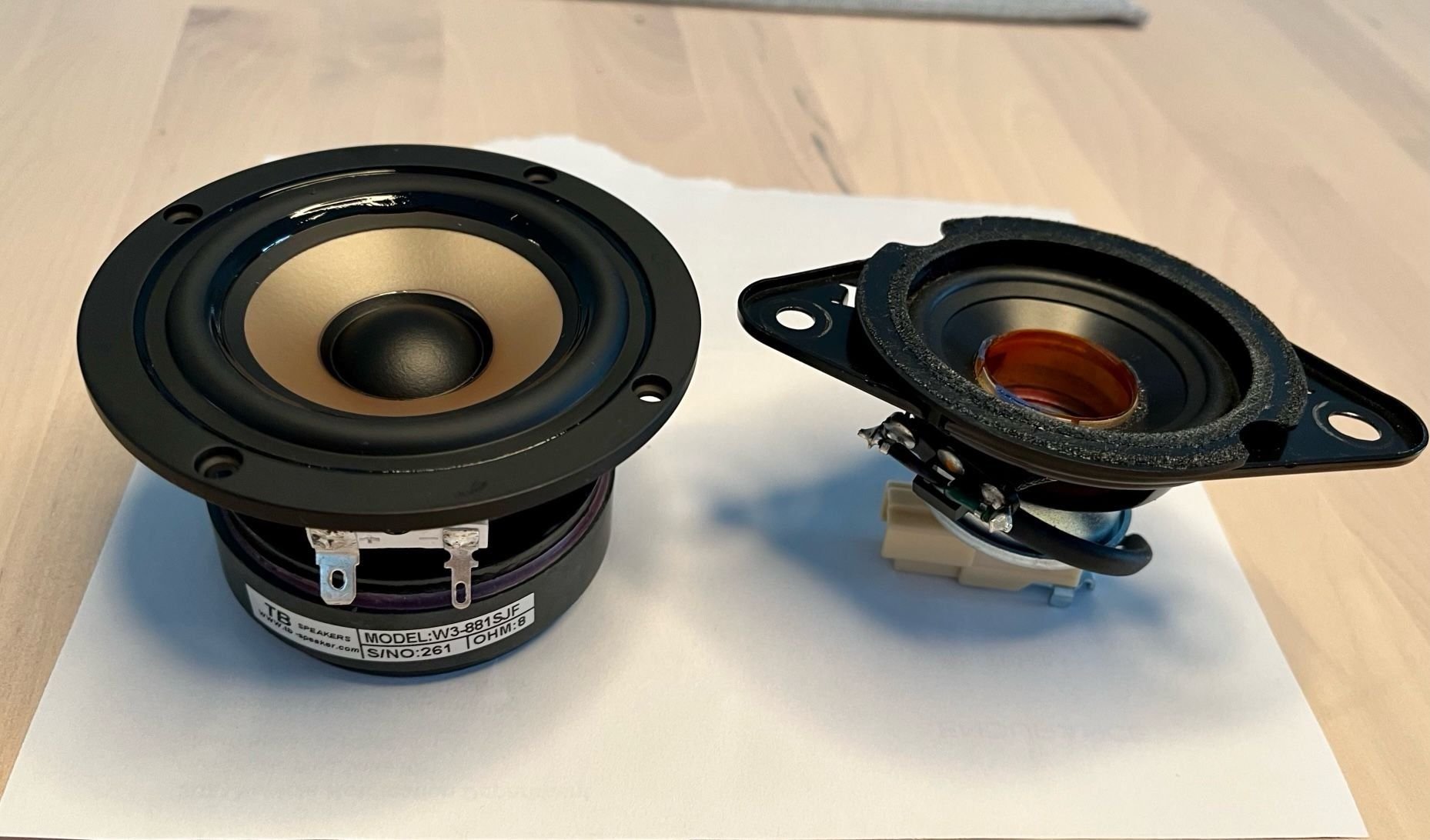

And this one for central dash (model # in pic). Side dash I used OEMs

I ordered and received new sub (Goldwood), am planning to install it by myself. can you help me about using the original bracket for the new sub? any tips for a proper installation?
and also am planning to replace center dash with the same brand as you posted, will it fit? it looks much bigger than OEM
