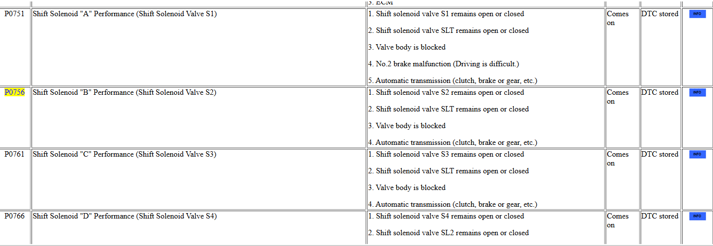

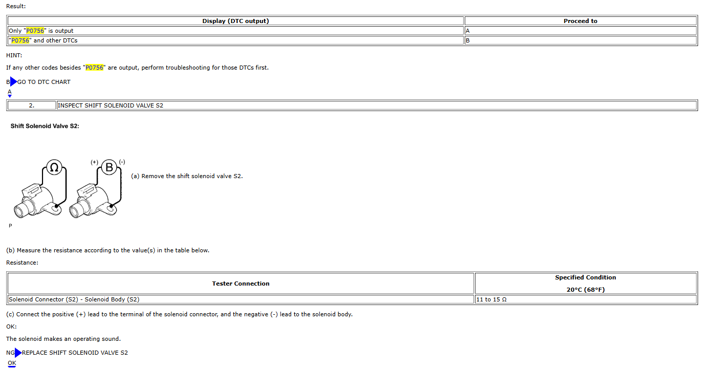

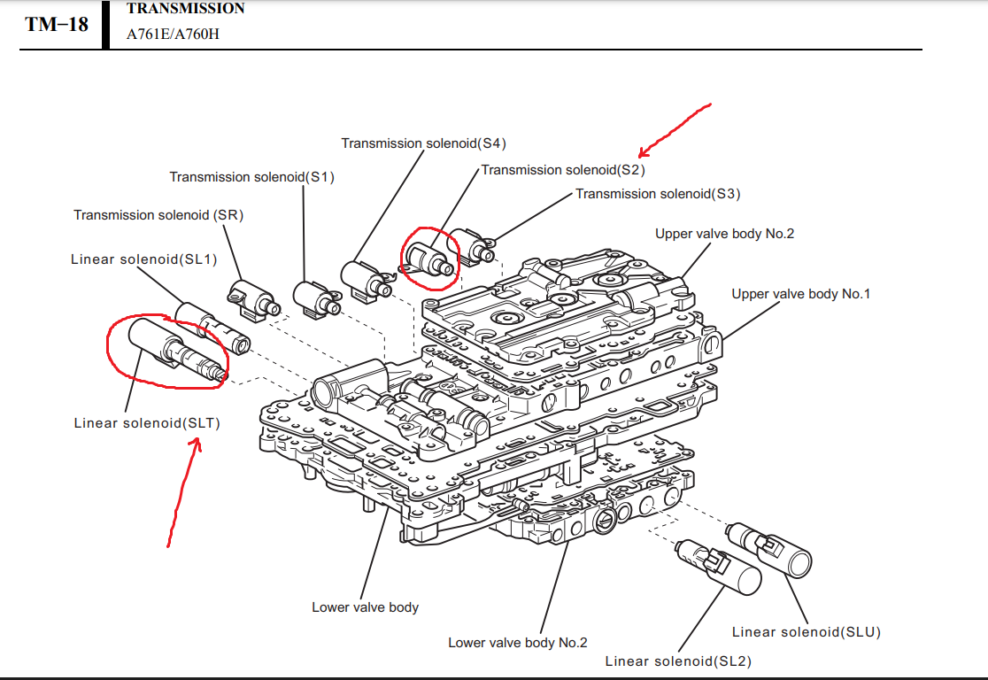

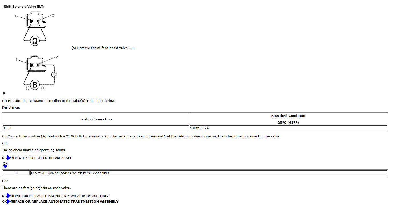

Code saying "shift solenoid B" stuck. I changed transmission fluid as step 1 but did not help. Car jeark when i am slowing down to 5-0 mph (gear 1 i think). While driving it is fine. Step 2 for me was change transmission pan gasket and filter plus the solenoid. But i dont know which one is solenoid B. I called dealer and they gave me diagram which i am not sure. Do all solenoids are same? But in diagram their orientation looked different.
I attached pdf. Can someone direct me?

It's not solenoid B. It's solenoid "B" performance!
