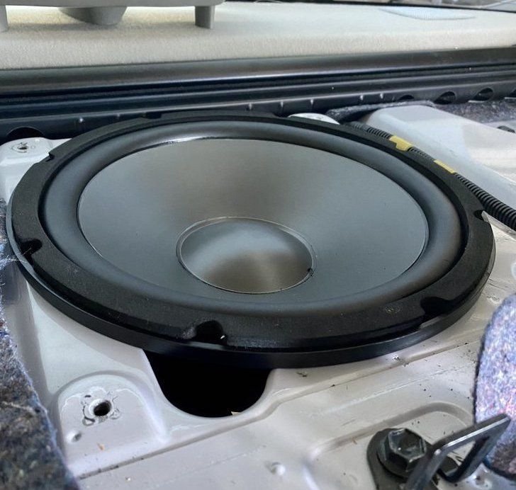

Hi, I have a 2007 GS350 with the mark levinson audio. I believe my subwoofer is blown since it flutters with moderate bass. Now I'm aware of the people who chose to replace the foam instead of replacing the speaker completely. Instead, I actually would like to replace it with an aftermarket unit, and I believe I found one that could work, granted with some minor modification. I'm aware of the specs of the oem sub, so I found a sub that looks similar and has similar specs. Would I just be able to remove the oem sub from the mounting bracket and drill some new holes and screw the aftermarket sub in? Could I also use the stock amp to power the new one if I reattach the harness to the new speaker? Here is what the speaker looks like. I also made sure it was a free air sub like the oem one, the same size of 10 in, and same ohm rating of 8. https://www.crutchfield.com/p_130TSD...-TS-D10D4.html
For reference, this is what the stock sub looks like. Like I said, would it be possible to drill some new holes into the bracket to secure the new sub in place?

If the sub physically fits then sure it will work. But that Pioneer has an extremely low efficiency rating, 76 dB that might be the lowest I've seen on any 10" sub. How about this, I sorta randomly selected.
https://www.crutchfield.com/p_091RSB...50.html?tp=111
Key is knowing the cut-out diameter of the replacement and what the car has.

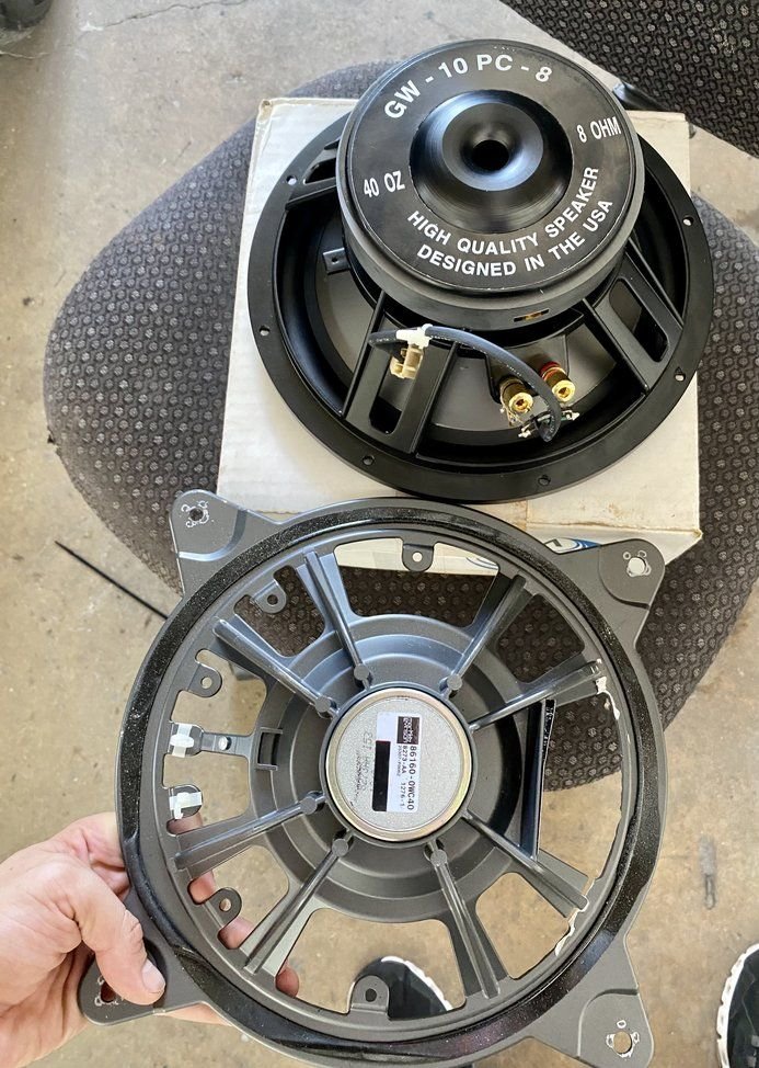

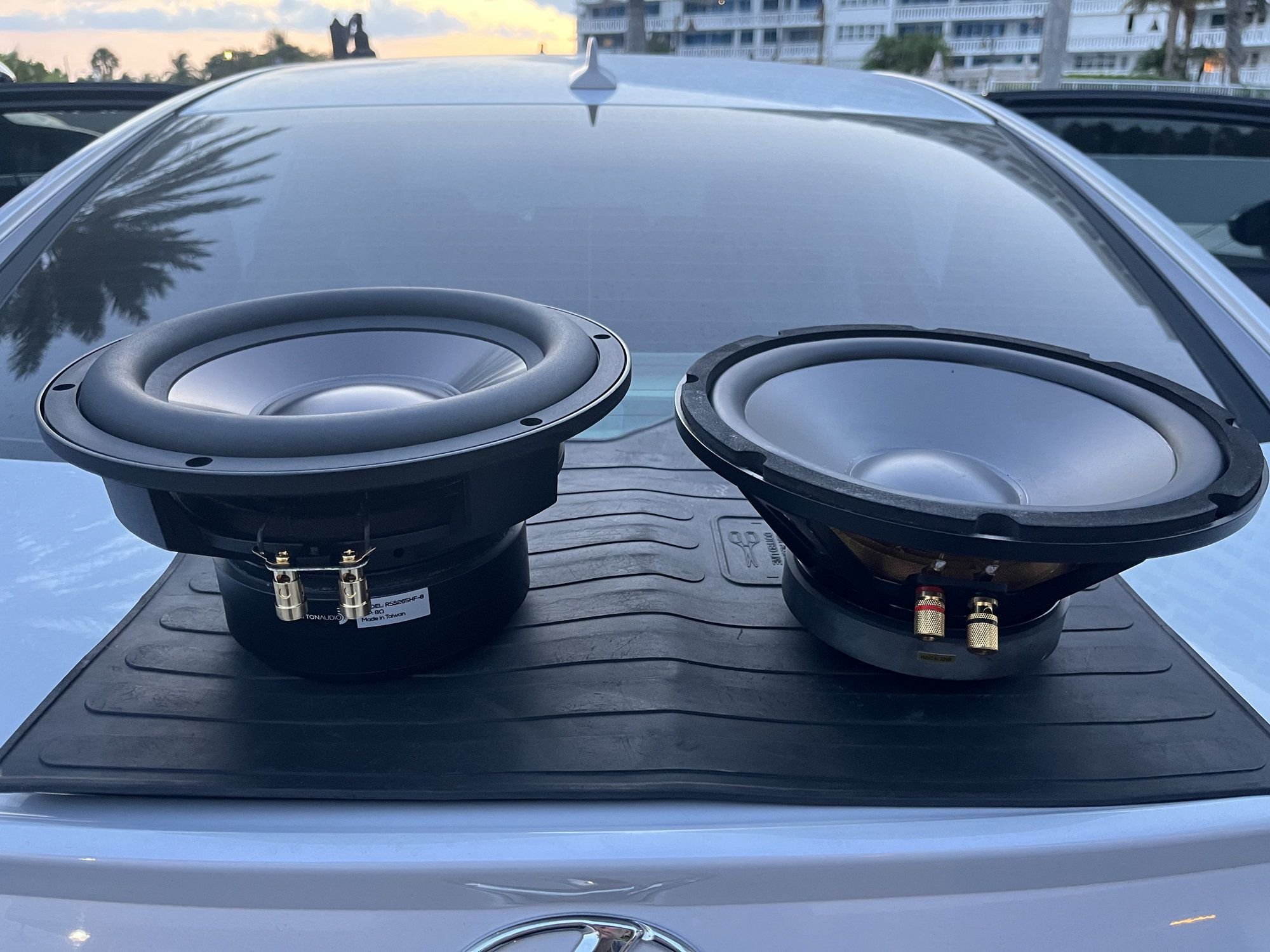

I have the ML system in my 460, which had a blown sub. I did what most did, and replaced it with the 8ohm 10" Goldwood. Paid abound $50. Had it for a couple years until that blew as well. Replaced it with a Dayton Audio, been fine so far. Had to adjust the trunk liner a little to fit it, since its larger (see last pic)
Dayton Audio left and Goldwood right.

The stock one was metal. Some people took the time to drill it out to make the new sub fit but I found it to be a weste of time. I simply swapped over the rubber ring gasket from the bracket to the underside of the new sub, and just dropped it in. The weight holds it down without an issue. And I had others in the FB group follow my example without issue as well. Up to you.
Also, carefully remove and save the old connector. You can just screw the new sub wires into it.
