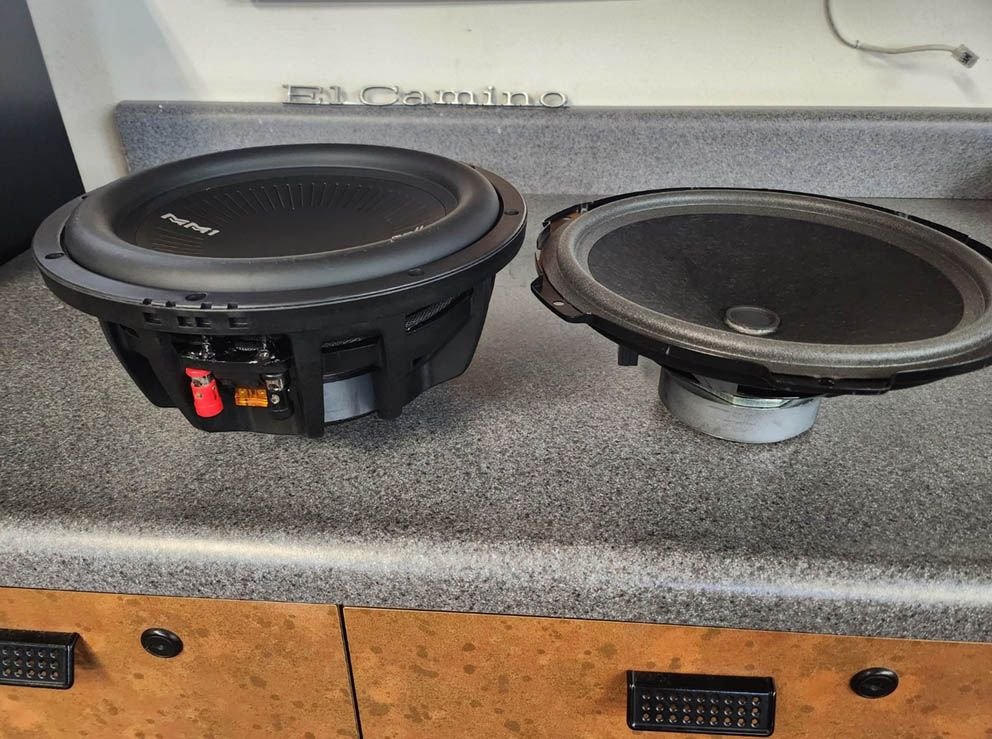

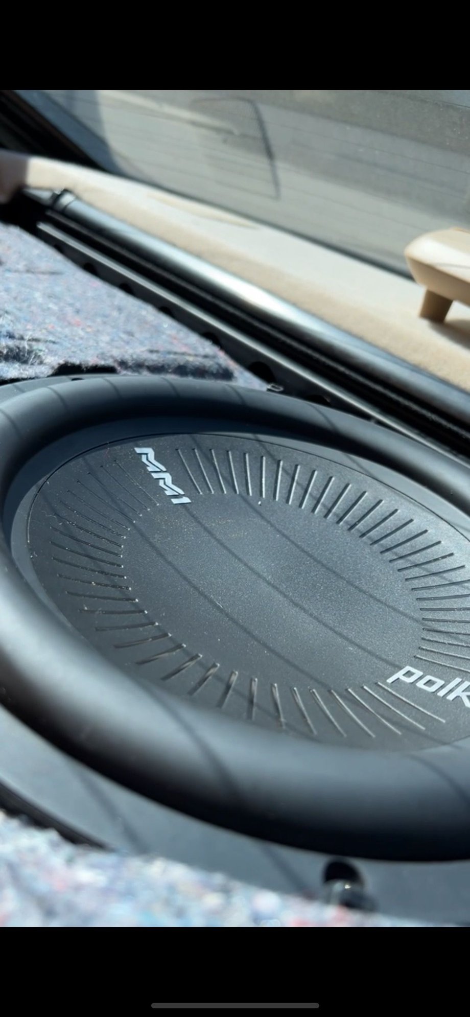

No, I did not reuse the gasket, and I got the polk audio mm 1042 dvc. What I did was put some foam weather strips on the bottom of the subwoofer instead. I forgot to take pics, but in this photo you can see two of the four zipties. Again, I just routed them through the speaker screw holes and the holes where the 10mm bolts for the bracket went.

Looks good! How's the comparison?
