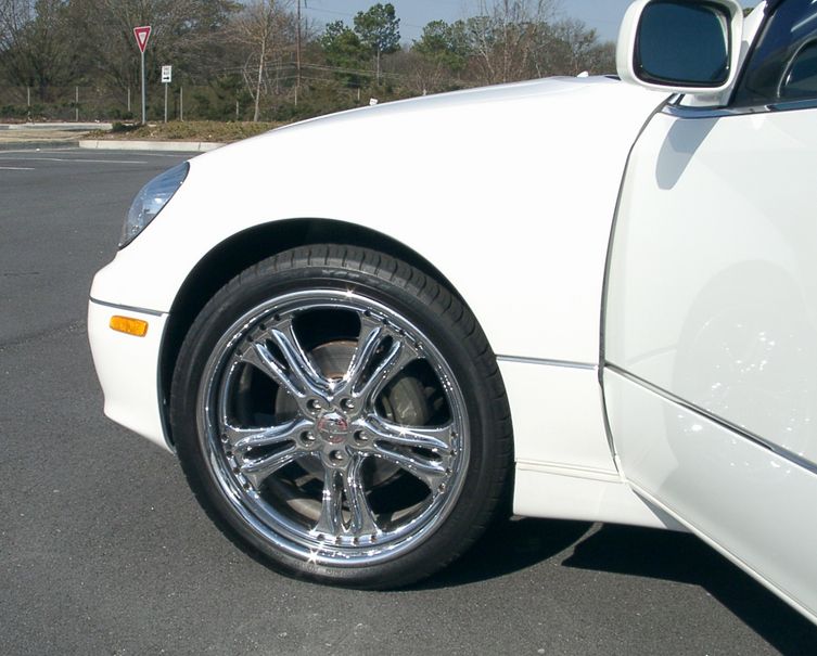

20's are more for show than go, so I think the package you've suggested is great. Wheel looks great, although with so much 'space' the brakes are gonna look miniscule.
You might want to look at some of the pics I took at a recent meet... some shots of cars with 20s.
http://www.higginbottom.com/paul/cars/feb_meet.htm
Here's a hot pic...
