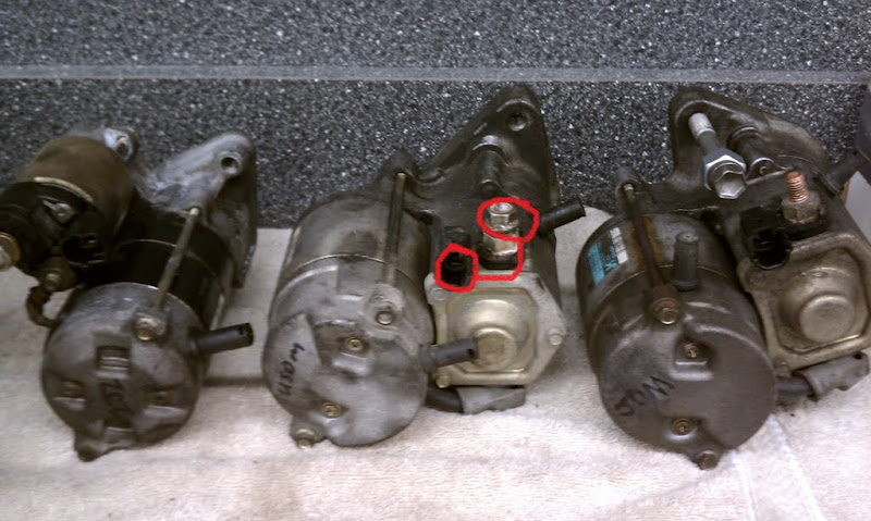

Here ya go, I happen to have some starters on the bench out there so I snapped a pic for you, the middle one is a GE starter should look just like yours.
The bolt will have your hot battery cable going to it. And the black plug just gets a little 12 volts from your ignition to make the solenoid push out and in turn make an internal connection of the battery feed through to the starter. So by touching a wire from the bolt to the pin you are bypassing the ignition system and making it engage instantly. It's safe to do, just make sure the car is in park, since your also bypassing park/neutral safety switches..

If it doesn't work, then verify you have 12 volts to the starter bolt with a multimeter, touch the red lead to the starter bolt and the black lead to any bare metal on the motor or starter housing.
If you have power there, but jumping the wires won't turn the starter let me know, I'll take a starter apart and show you how to fix it without buying a whole new starter.

That would be great man. Yes there are 12 volts going to the nut terminal. I have to try to check out the starter tomorrow because its pouring out here today. That would be great help to learn how to fix the starter myself. Thanks again your help is greatly appreciated. I will let you know how this goes tomorrow if you want to check. Thanks again.
