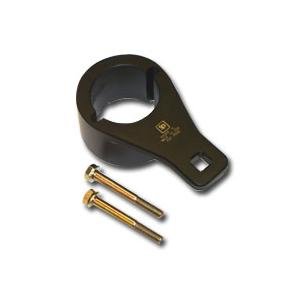

You need the special tool from Schley. It is about $60 from Amazon.
http://www.amazon.com/Schley-SCH6430.../dp/B000I1C9UU

lol i have the tool and still wont break lose..any other ideas
