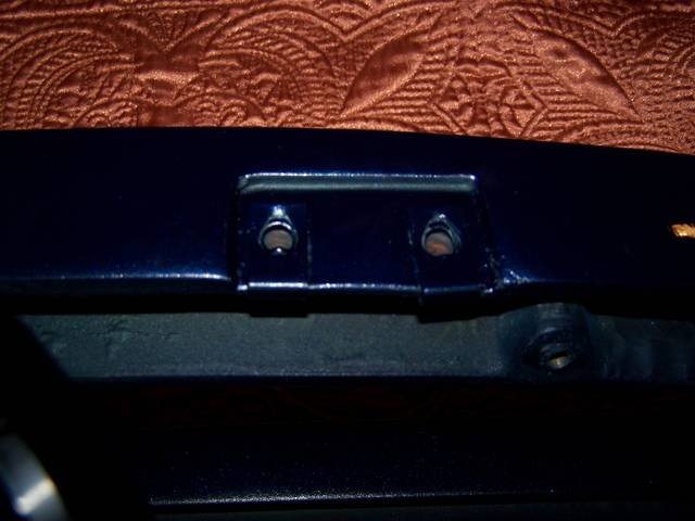

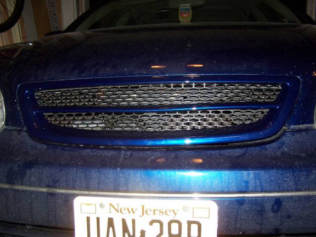

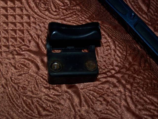

i just got my l-tuned grill painted and dont know to install a bracket.
here are some pictures. please help me out

Remove the clips on the L-Tuned grill,then it should go togeather.(3rd pic)

Had the same problem with mine.
You are missing a bracket and some screws. One end of the bracket will attach to the grill and the other end will attach to the handle.

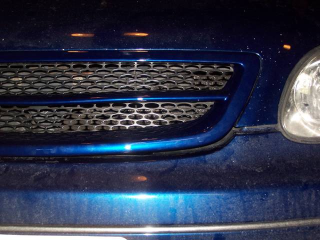

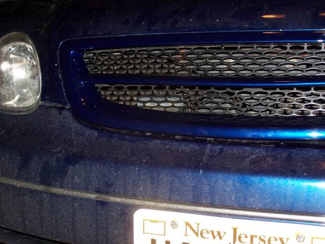

now i have a new problem, the bottom of the grill towards the passenger side doesnt have a good fit with the bumper. the hood is fine, its the grill and the bumper that doesnt have good fit.

here are the pic, sorry the car is dirty from all the salt. please help me with adjusting it, i already tried using a dremel to make the holes a little bigger so i can adjust but it didnt help. how is the fitment usually with these grills??????????

Maybe its the lighting but the grill doesnt look like it fits right on your car. It should fit perfect. It is a Lexus part.

That grill should fit perfect. The L-Tuned fits better than my RMM. I think maybe ur bumper is mis-aligned or something...

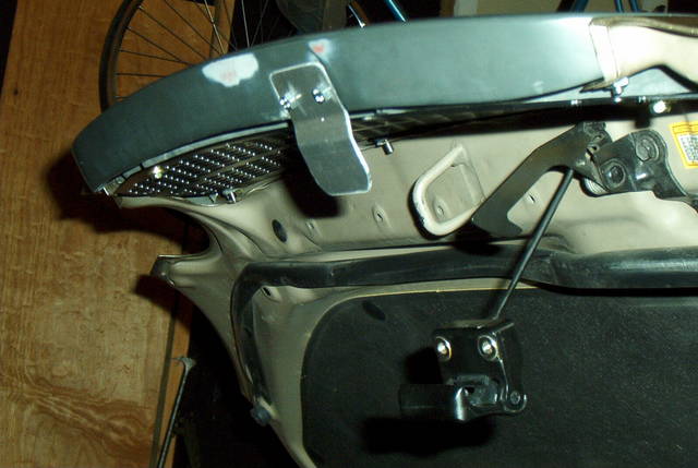

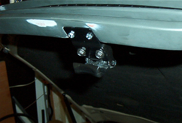

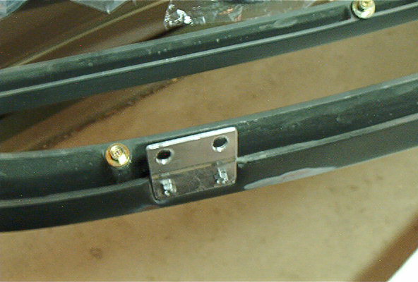

You are missinga latch bracket that attaches to the grill and the hood lever attaches to the latch..
The clips that are on your L-tuned grill is it threaded so that you only need a screw w/o a nut??
LMW sold some close out L-tuned grill w/o hardware latch and mesh screens I think Sewell Lexus sold some also.
The guy that sold you the grill probably never got a latch.
The pics are of how the latch hooks up. I custom made afew latches and was test fitting them.
If you need one let me know I 'm going to send them to get powder coated here shortly. They are not real hard to make . I used some 1/16" or .0625 aluminum . I ended going to a machine shop because I could not get the elongated hole to right where it did not look ghetto.
Latch made to look like ISOLDOUT's original L-uned latch.
latched done painted black
rough finish before latch holes drilled.
