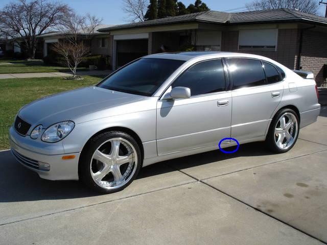

are you talking about this piece?

If so, I ordered both sides, from Carsons Toyota around 4 months ago
22.00$ each side,
Part #'s
75735A front passenger Door
75736A Driver's Door.
They also come painted to match your car... although I havent had a chance to install them on my car yet...

Mine looks exactly like the picture above. I've got a temporary piece of duct tape on the inside part of the trim and door holding it in proper place.
Thats it EXACTLY.
Ted
