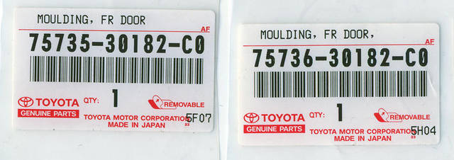

Lightbulb Part numbers for lower door trim (99 GS400 / Blk)
Here is a scan of the labels for the lower door trim in the gallery:
https://www.clublexus.com/gallery/da...TrimLabels.jpg
It took me about 45 minutes to replace both front door mouldings(as stated above I went the external route, thanks for the tip) Make sure you have either a short stubby philiips screwdriver or one of those "S" type short screwdrivers. The screw at the front of the door is hard to get to.
Good luck!
