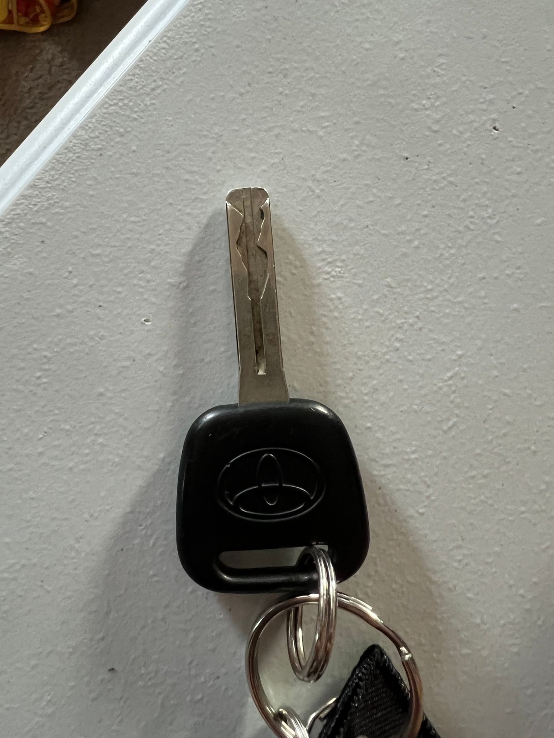

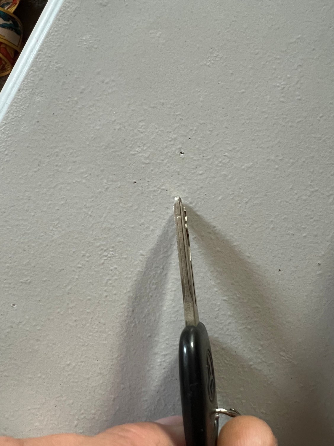

The thing is that JDM cars of that era never really came with Immobilizer system, even if their US counterparts did, hence there is no programming to be done with a new key, and no need to mess with the ECU, any more or less qualified Locksmith in the area should have a TOY48 blank for your Aristo, all you need is to make a copy of your existing key and see if it starts. Post a picture of the key housing you have, if it is slim and narrow, you don't have any chip in the key.

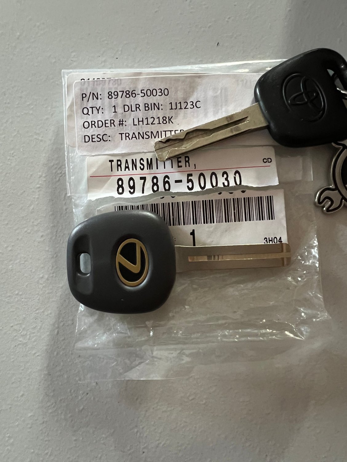

I picked up this Lexus key also to see if I can try and can get it cut.they couldn’t cut me one so I just bought it. I’m going to Japan in a couple days and was gonna bring my aristo key and see if the Toyota dealers can make a copy of it. I emailed a lot of locksmiths in my area and they never got back to me for awhile so yah. Kinda stuck in a pickle. Put here’s the pics
