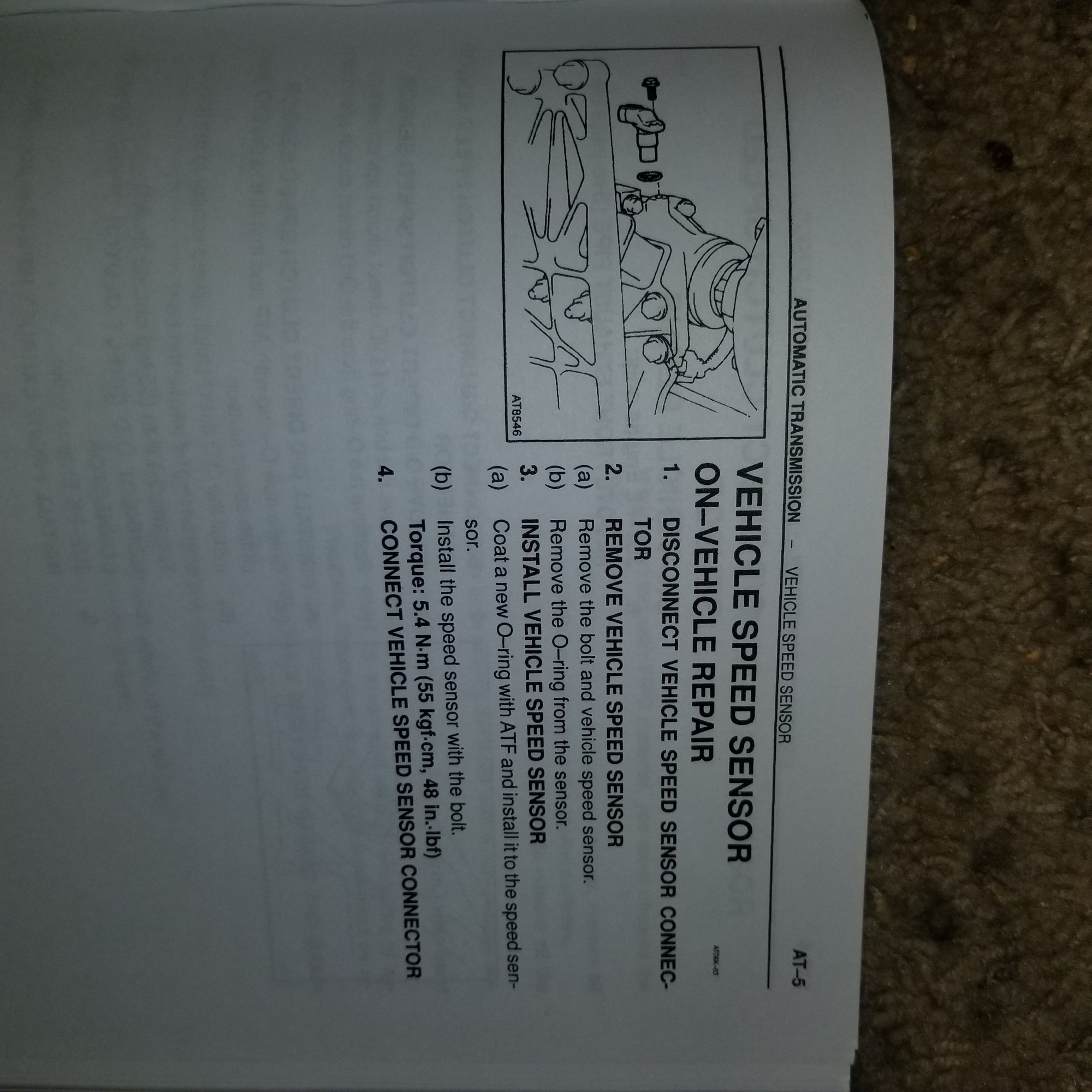

Well, I dont know if this will help or not. There is a vehicle speed sensor that goes from/to the Engine Control Module. But the manual is vague to say the least. It just says "The vehicle speed sensor (electronically controlled transmission) detects the vehicle speed and inputs a control signal to Terminal SP2+ of the engine control module ". Let me dig around some more. I am curious.
Paul
Old May 10, 2023 | 08:38 PM
Raven01750's Avatar
Raven01750
Joined: Aug 2019
Posts: 1,757
Likes: 355
Check this and its wiring to/from the ecm.
Sorry for the sideways image. Good luck.
Paul

Thank you! I will check that out later today, that's the one on the tranny I changed, I'll have to get it out and test the connecter and wire going to the ecm.

Still haven't been able to get it up on a lift, so haven't been able to check the wire, I will update this when I can, T.Y.
