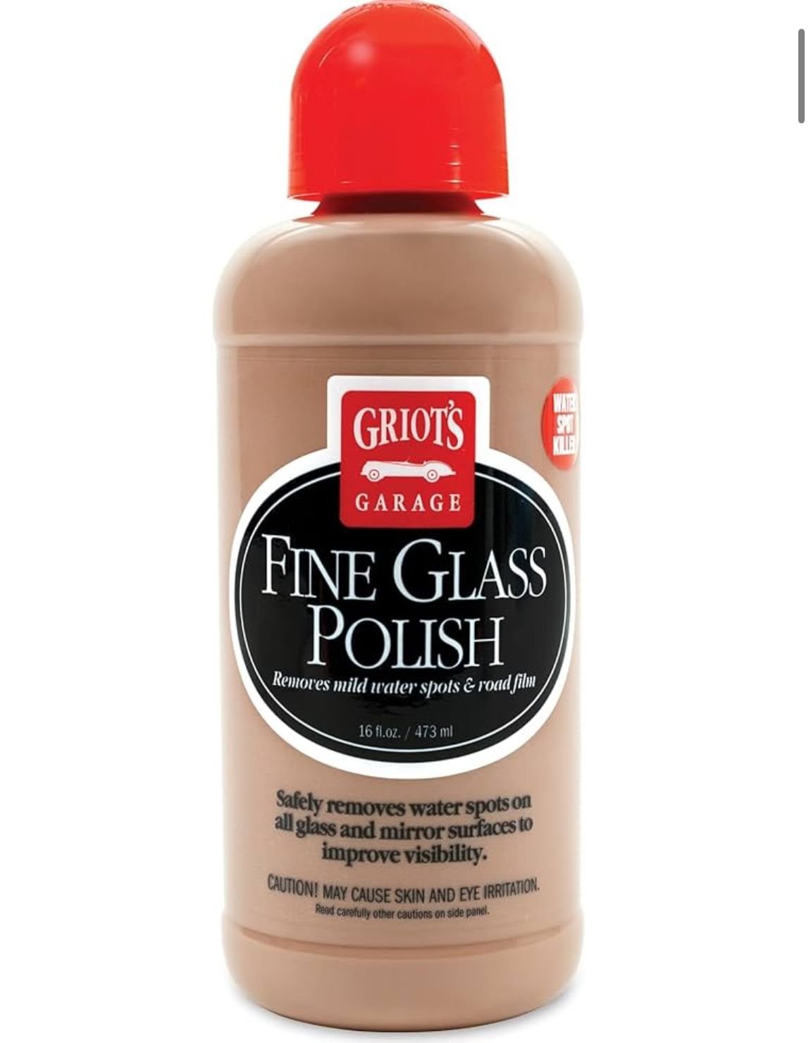

In case anyone else encounters this: Problem solved. A good addition to my car car arsenal

I use the Griot's glass polish, too. It works great. I have the advantage of living about 30 miles from their store and HQ. I run by there about once every 3-4 months and stock up on what I need. Highly recommended!
