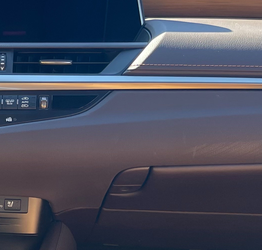

Is this dashboard soft trim replaceable?

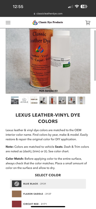

Look, I also have some brown paint that I purchased for the seats and later today I will try to paint the stitching.

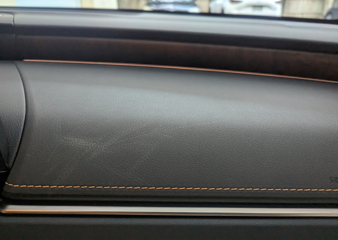

Originally Posted by ESh

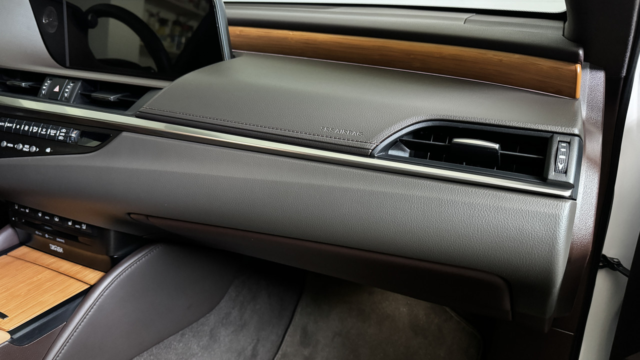

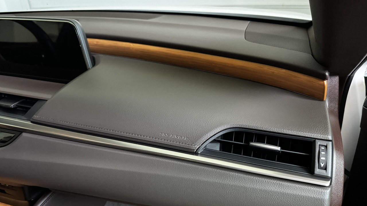

Very easy. I removed the trim around together with the screen, masked the area real nice and put multiple thin layers. You can accelerate drying with hair drier.
I also painted the lower plastic that has many scratches.
Here you can see some of them:
Upper plastic looked similar to this one:
While doing it:
The result (2 years later):
I clean the dash after every single trip and I cannot see any scratches, it is very durable, no way to scratch it.

How is the sheen on that? The factory is more matte but yours looks like it has a some gloss.
Old Mar 2, 2026 | 11:42 PM
ESh's Avatar
ESh
Joined: Jun 2014
Posts: 5,002
Likes: 1,626
From: MI
It is the same as factory but I tend to wipe it with a soft cloth damped in Chemical Guys Sprayable leather.
