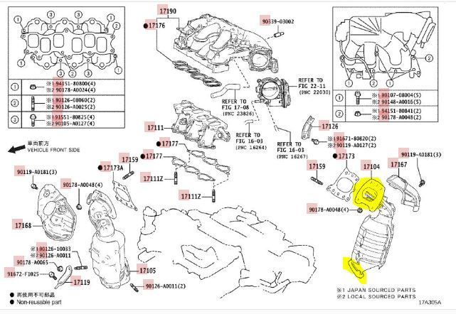

A set of 4 nuts/bolt underneath is a bit puzzling. If he mentioned "header or manifold" it makes me think the connection between the integrated exhaust manifold and catalytic converter or catalytic converter to lower j-pipe exhaust (highlighted).
However, it looks like the cat is connected with 5 bolts to the integrated exhaust manifold (essentially directly to the block).
Usually a missing bolt in an exhaust component comes with an audible noise such as a deep throbbing or rumbling from an exhaust leak. If you're not hearing that, then that's probably not the culprit.
That's a weird one. I'm not sure what else it could be from the limited diagrams that the Lexus parts dealers offer online.
