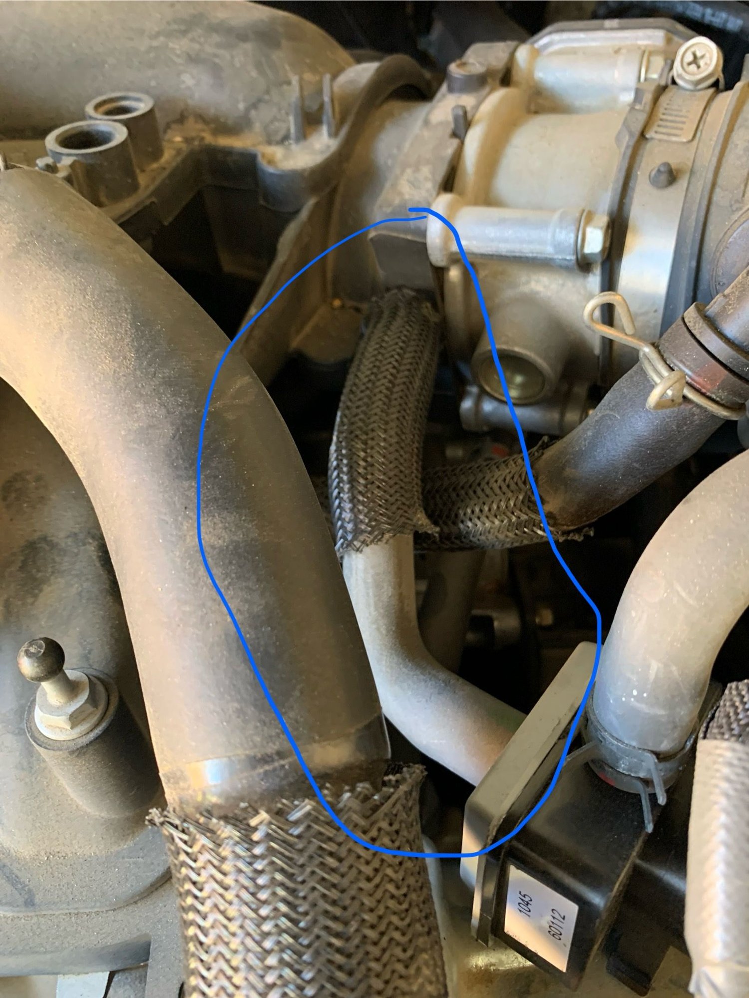

Thank you. Check engine light came on last August, along with brake warning, and a light that appeared to be a rear parking sensor with a light above rear of trunk on right side of dash. Same codes as well. Both banks being lean. Air Filter was past its life, changed the filter and new gas cap. All warning lights went off after 20 minute drive without resetting the codes. The same dash lights returned late March of this year as well as an evap leak code on top of both banks being lean. Definitely wasn't the air filter- replaced nonetheless along with another gas cap. No go. It would then have a hard time starting after each fuel up regardless if it was 5 gallons or full fill up. I recall this post from before and also read up that a purge valve test was something to look into before diving in deeper. Saw your post yesterday and bought some MAF cleaner on my drive home. Pulled the purge valve yesterday and sure enough it was open - I could blow through it from both ends. Sprayed it really well with the cleaner and let it dry for about 30 minutes - made sure no moisture or drops were left. Pulled the MAF sensor as well and gave it a good spray and let it dry. Reset the codes and all good. Went to top it off just to make sure and no hard starting. Thanks again. Dealer would have been a nightmare to diagnose and start to randomly change parts.
update - despite cleaning the purge valve and clearing the codes - the same codes popped up 50 miles later. I bought a new valve and installed it - the one I pulled off appeared to be working as it was not open like when I originally pulled it off - however it does appear to have a hairline crack in the grey part of the plastic. Installed the new one, cleared the codes and all looks good about 100 miles in. Btw - this is the purge valve that is close to the intake tube that goes from the air box to the throttle body and is partly visible with the engine cover on (driver side of engine cover) - not to be confused with the other one that is closer to the passenger side and out of view with engine cover on - that one actually looks more like a canister as it has a cylinder shape - I mention this because the Lexus parts guys will ask which one you need. Apparently the other one gets returned quite often, whereas the one I bought does not and did the trick.

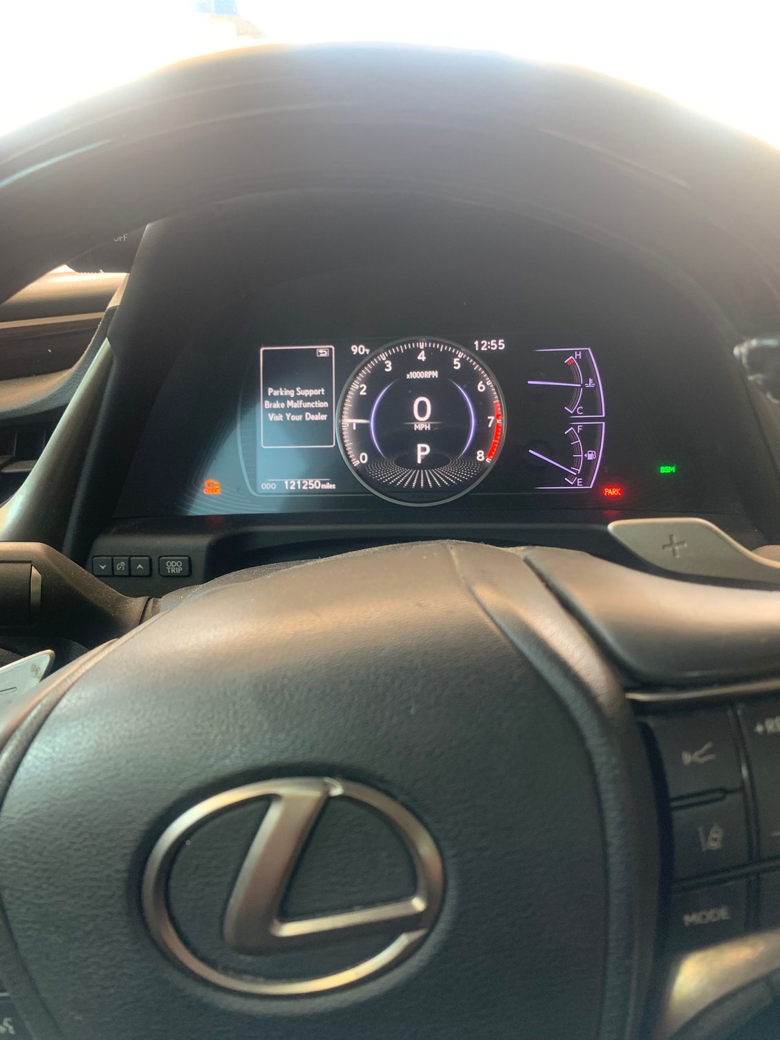

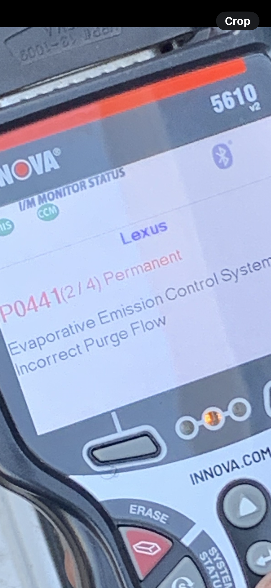

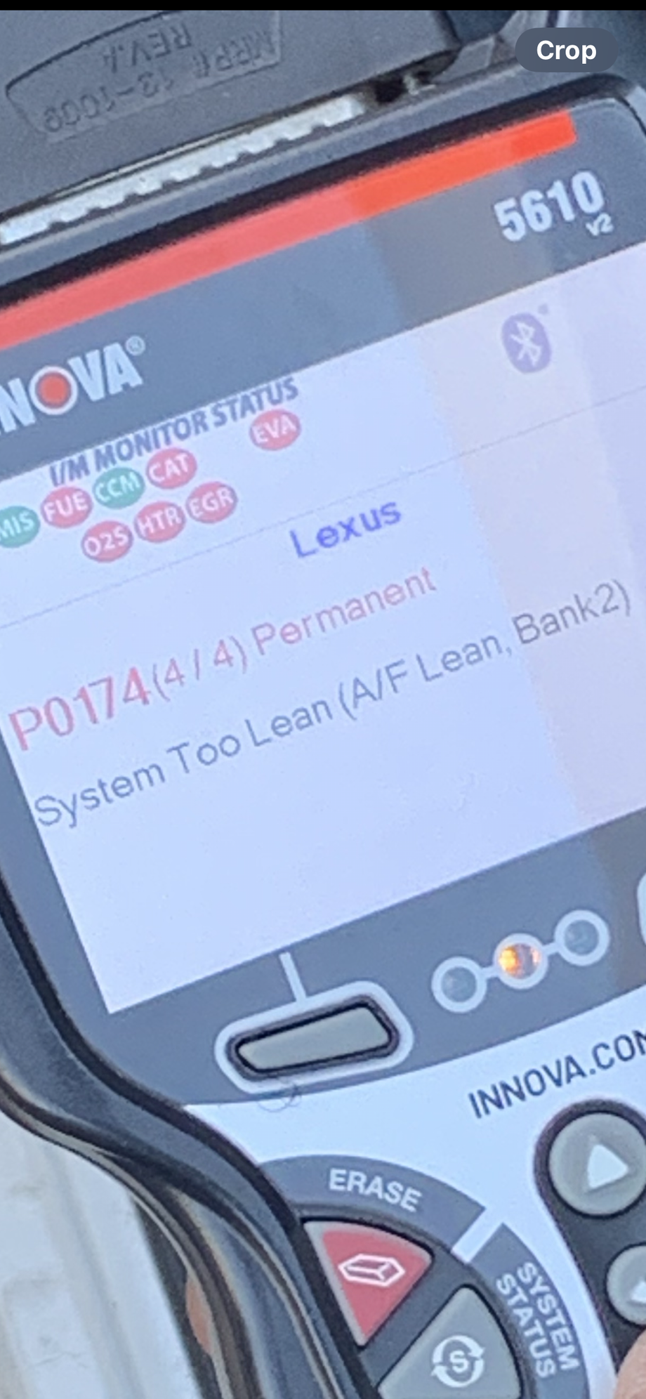

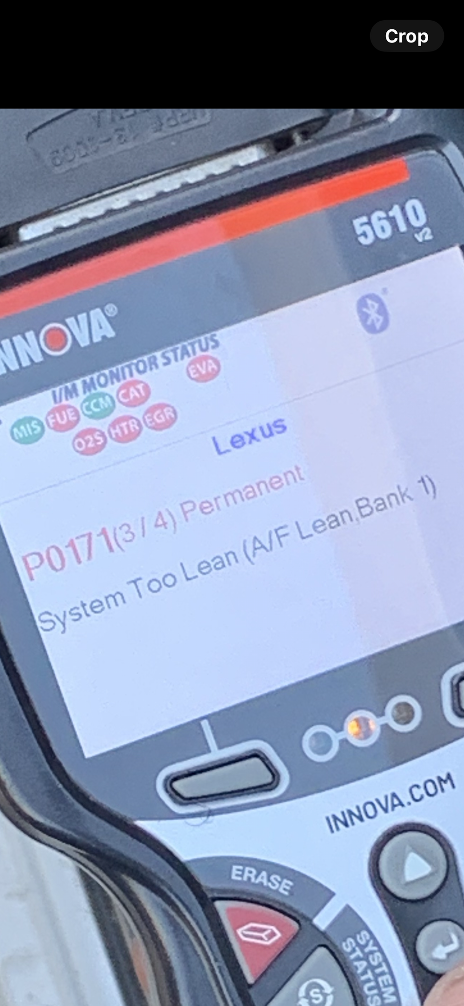

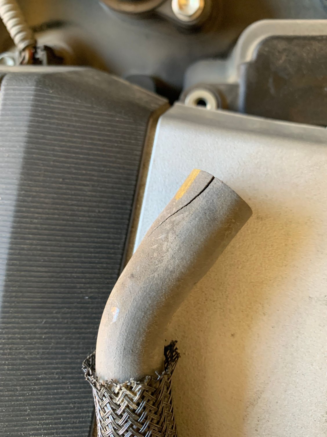

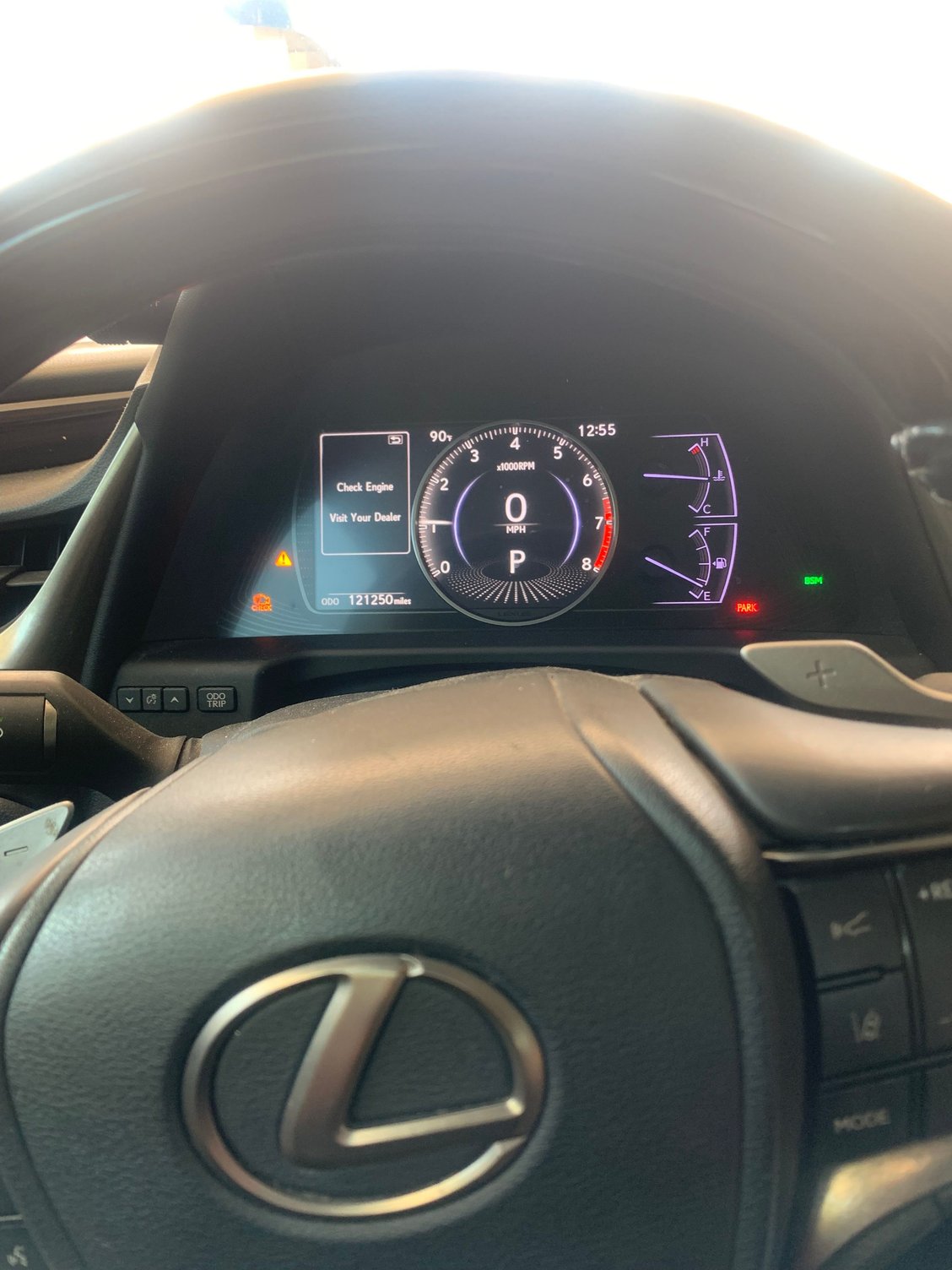

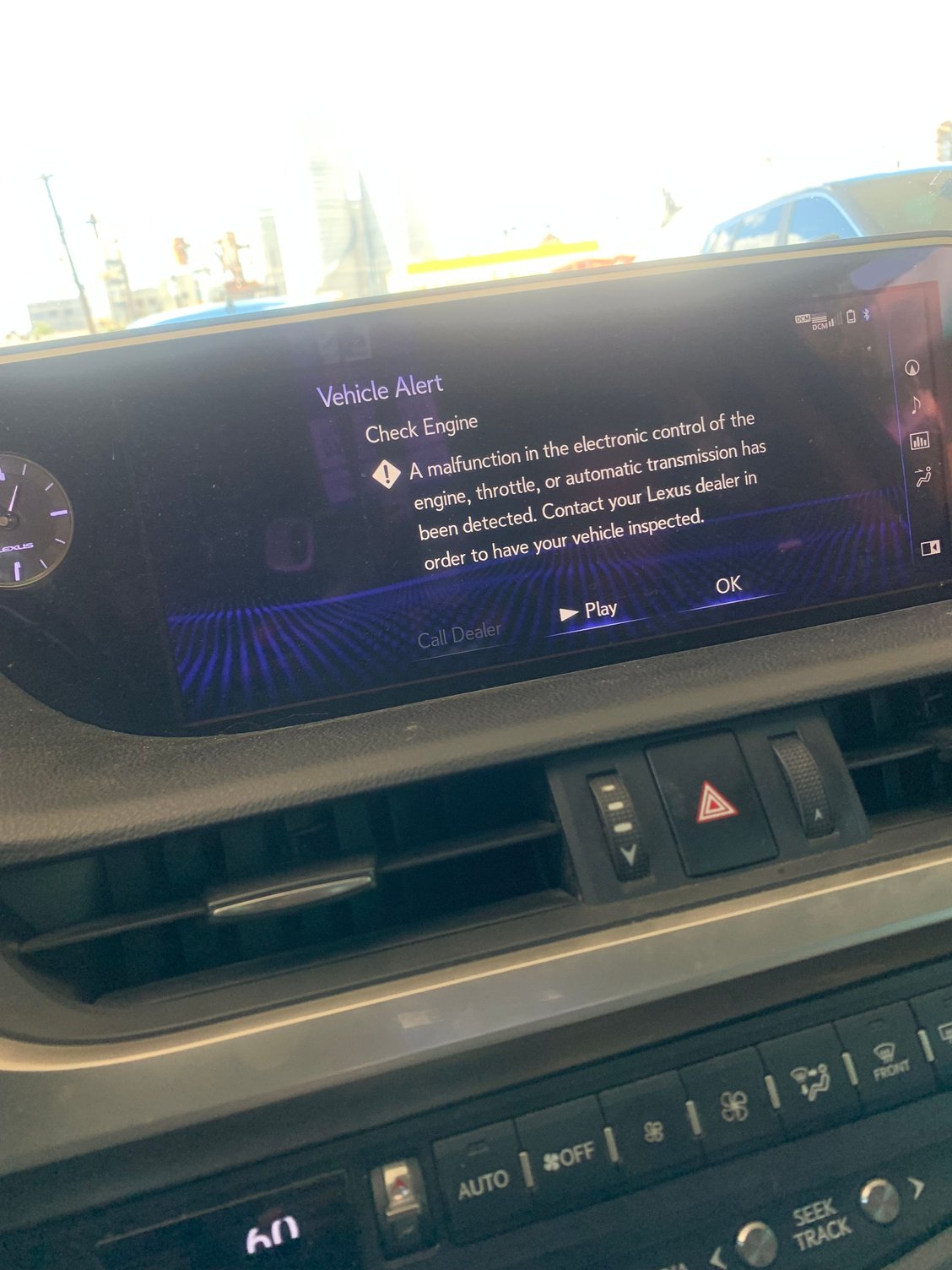

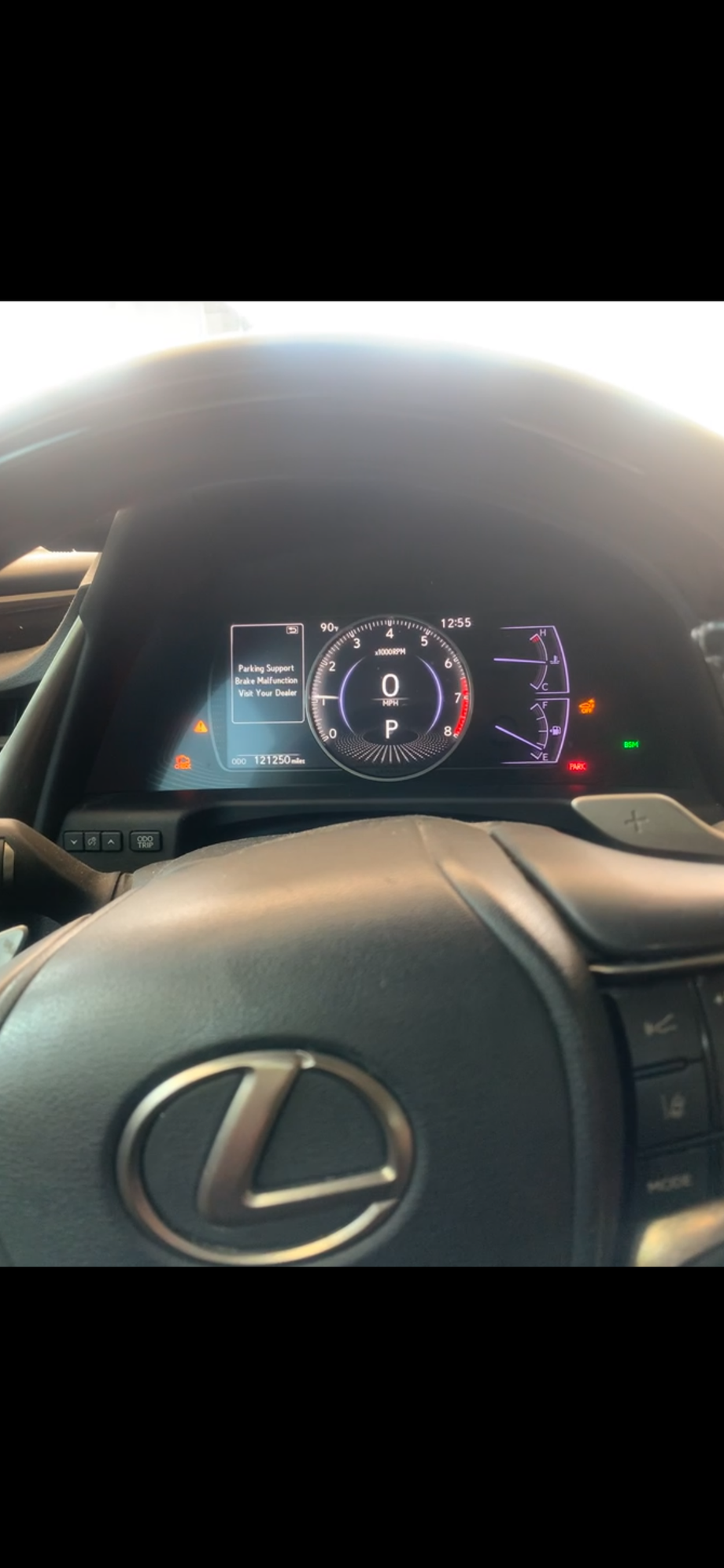

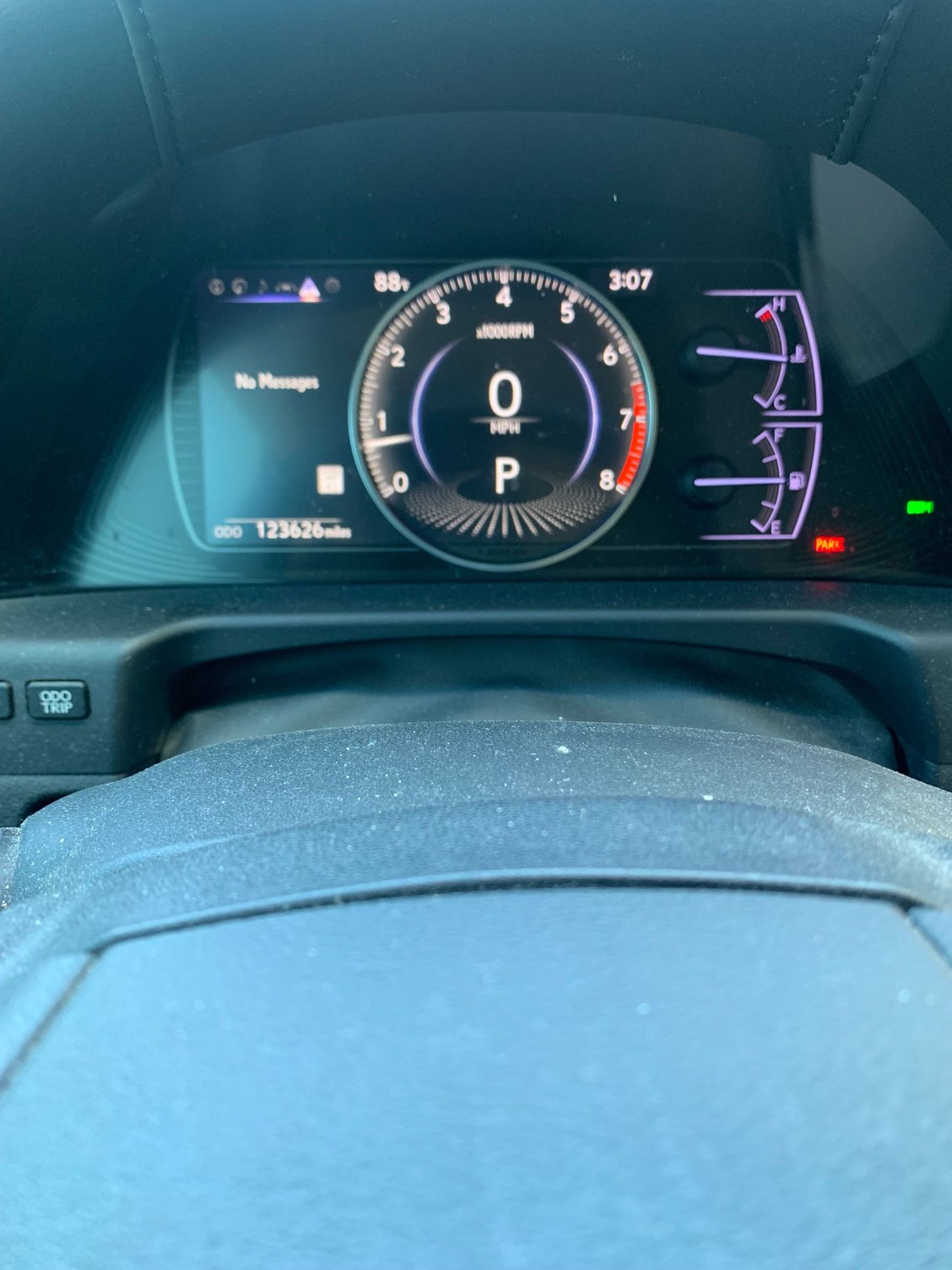

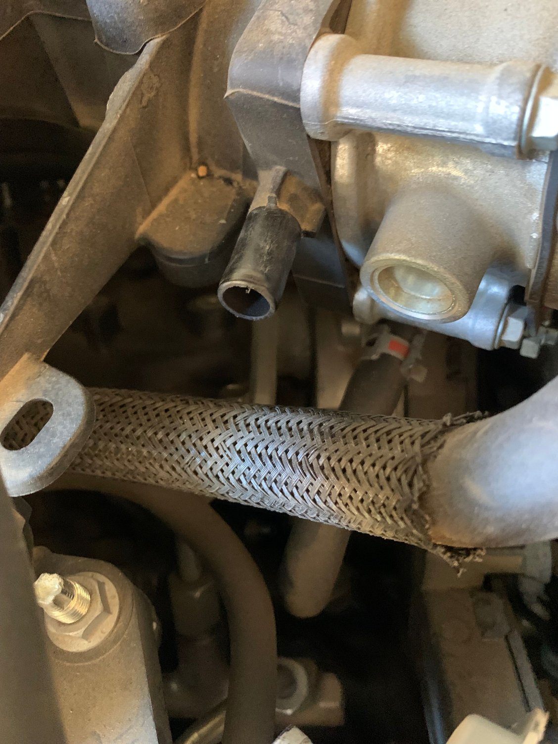

2019 Lexus ES 350 123,000 miles. Im having the same issues. I first noticed that when at the filling station my gas cap was pressurized and whenever I removed the cap it was full of air. After filling the tank I would experience the engine spinning but would not start regardless of the level of gas I pumped. Finally after pressing the start button upon the 7th try it would stumble and start. I replaced the fuel cap from Toyota/Lexus. I Replaced the purge valve along with the short vacuum hose that was dry rotted leaving the purge valve going into the throttle body. When I was checking my old purge valve I tried blowing air through it and it wouldn’t let me blow air through it. But after replacing the purge valve I noticed that the fuel cap didn’t have pressure when unscrewing the cap. I had my codes cleared and drove 500 miles no lights. I guess we will see! If the light comes back on I’m going to clean my mass airflow sensor. About two oil changes ago the Lexus service advisor told me that my air filter was needing attention so I had it replaced. I guess we will see how it goes
