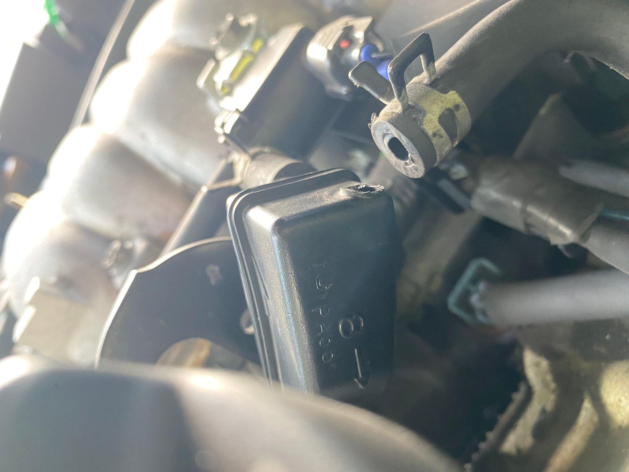

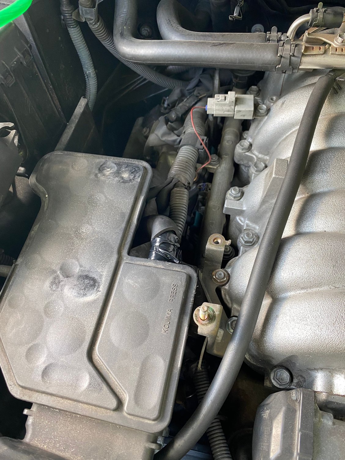

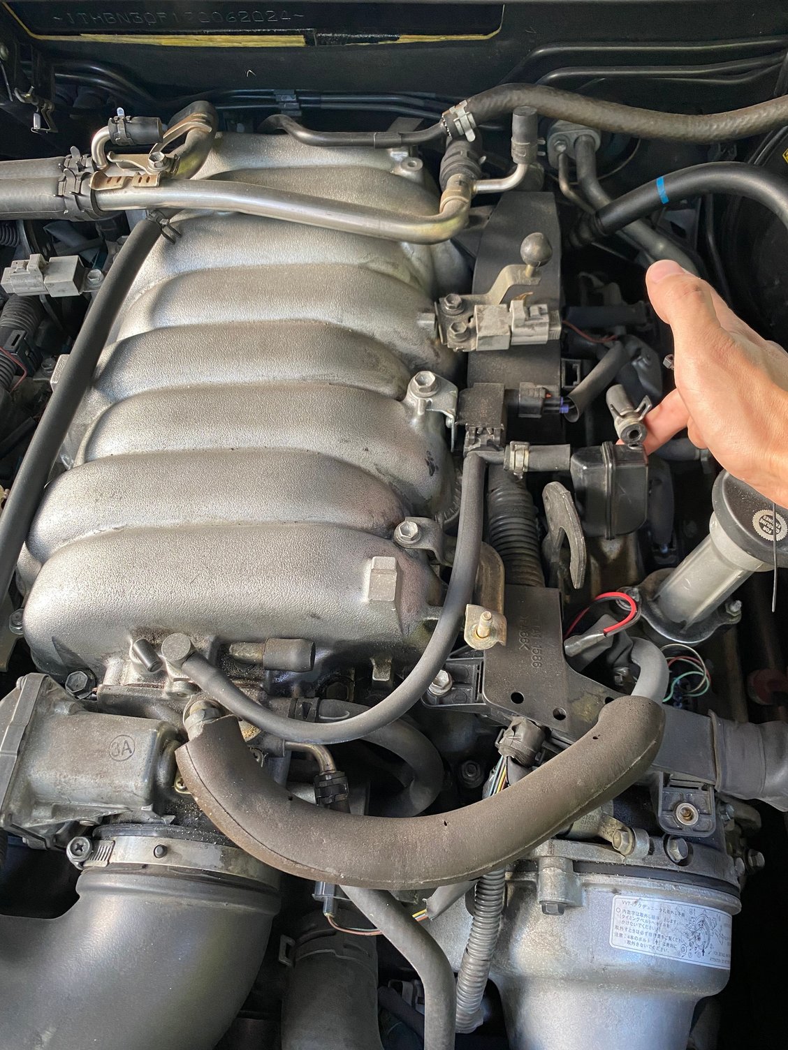

Vacuum hoses are not in great condition. I immediately noticed two that need to be replaced immediately.
The first is on the passenger side of the engine. You can see about the middle of the photo is a cable taped up with electrical tape. This piece was cracked and open. I temporarily taped it until I find the proper hose to replace it with.
The second is the hose above my finger. It is supposed to be connected to this box. (EDIT: I ordered this part. it's part 23818 for anyone curious. Still searching for the other hose part number)
second angle
After electrical taping both of these cables back together (temporary until I find the proper parts) I noticed in neutral the car does rev up past 3000RPMs

Sounds like great progress. Those hoses have certainly reached replacement age.
In my car that little box, where the connector snapped off in the hose - it was deleted before I bought mine. It runs fine without it. I'm not even sure what is is there to do but they have a reputation for snapping just like that. We removed it in my friends LS when his snapped there and it is running fine without it too.
You may not even need to replace the vvt valves yet given the cracking vacuum lines, but as you say they are simple to replace if you want to do them anyway for peace of mind.
