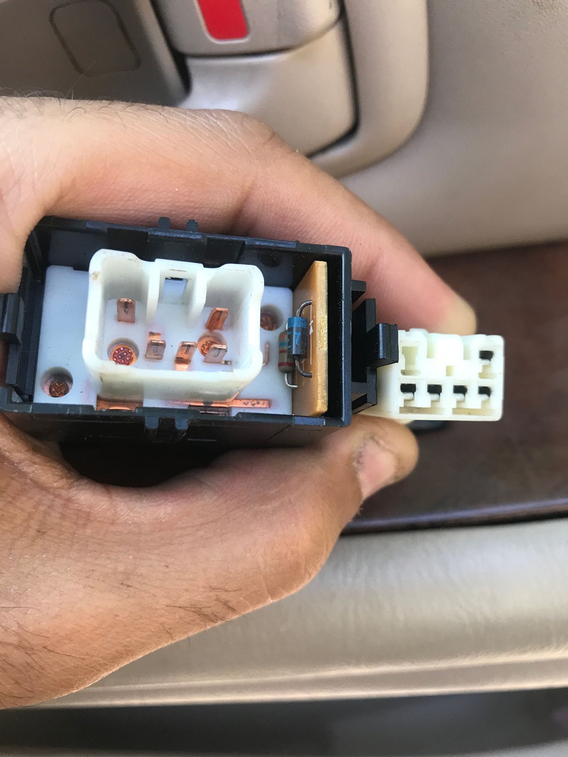

i looked through all the wiring, nothing looks bad. I dont have a voltage meter but will pick one up tomorrow while im at Honda Toyota Heaven, getting a master control and a control for passenger side. Any idea what i should set the meter to and what readout im looking for?

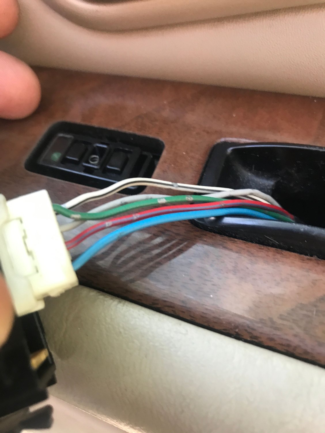

I would rather suggest using a Test Light for this one. On the Window Regulator, you should see Green-White (Window Up) and Red-Blue (Window Down) wires, when you press the switch up or down, you should have the 12V signal on the respective wires when the Ignition is in the ON position. You should also check that you have 12V on the Blue and Yellow wires when the Ignition is on. And lastly, just in case, check that Black-White wire has a good Ground.

also idkw but my wiring isnt exactly like that.. i have no yellow, there is a grey.
i did just notice this difference 😒

By the "Window Regulator" I am referring to the actual Motor unit that moves your window up and down when you press the switch, which is located under the Door Panel. From the photos you shared, can't help but wonder what happened to all those switches in the first place? The question is whether it has something to do with why your window doesn't operate as expected..
The switch on the picture is definitely not for this car, what was it taken off of?

when i put the new master control in all windows but the driver stopped working from it, also i could not operate the other windows using their switch on the door
What car did you take both the Driver and Passenger replacement switches off of?
If you were to disconnect the Master Switch or use an incompatible one, none of the windows would work, since you would essentially break the Ground supply, which appears to be the problem in your case.
