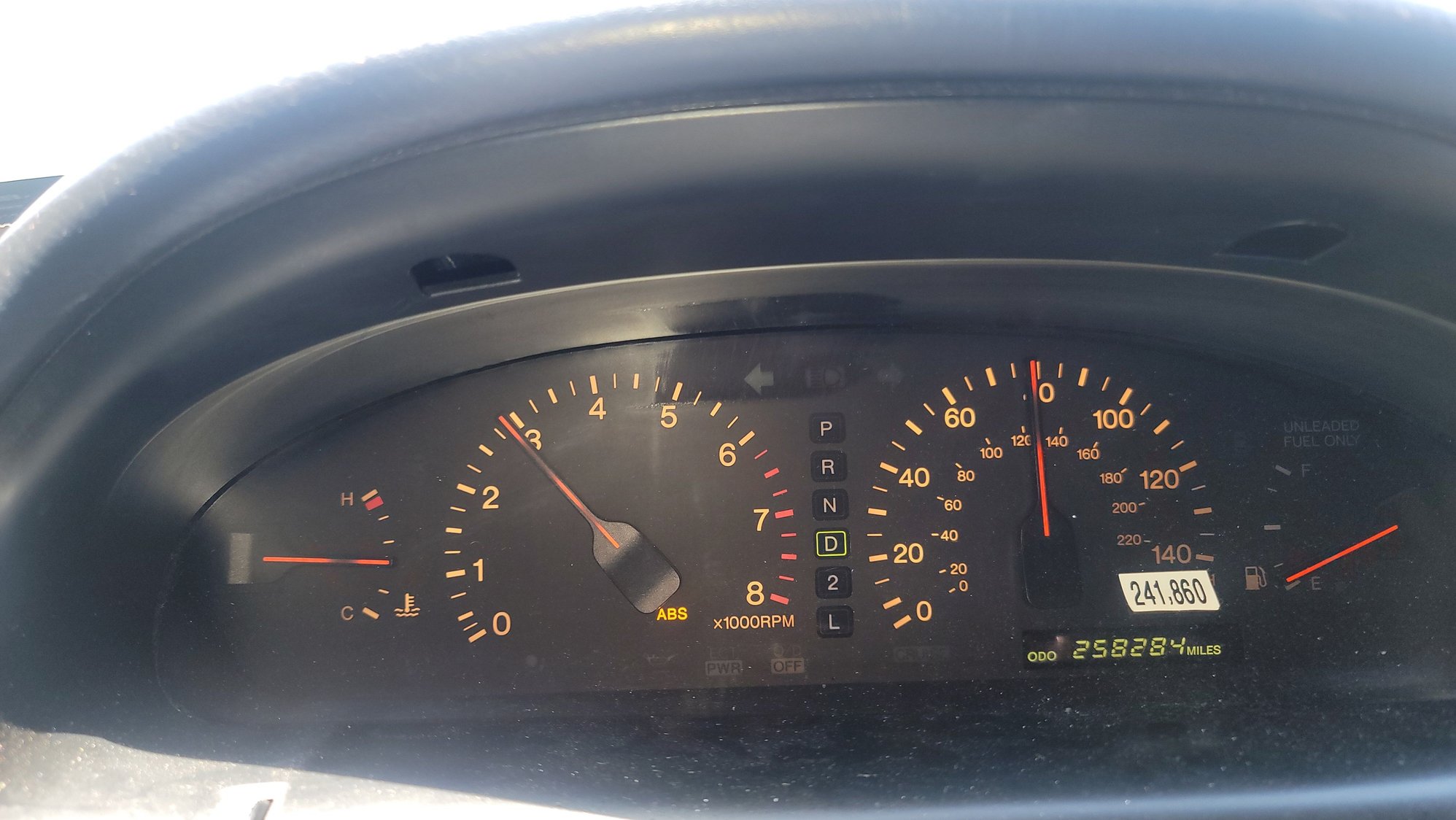

Having issues with the car going 80mph and the Tachometer is on 3. I think there's something goin on with the wiring........the pcm or ecu that's behind the dash has been replaced once........considering they (AAMCO) thought it was the transmission, because it wasnt changing out of 3rd gear so they replaced or rebuilt the transmission and it did the same thing afterwards and after 3 months they figured out it was the pcm.......currently, 3 years later, the speedometer cable broke and it was replaced, and at the same time, the TPS codes popped......they fixed the cable, now the TPS code popped with P0120 Throttle Pedal Position Sesnsor at Switch A Circuit and P0510, Closed TPS. So Ive changed the TPS Twice, it used to thud really hard while changing to 3rd gear and it only changed when I took my foot off the gas. I set the TPS at .045 or .45 at first then I lowered it to .35. Im thinking its not changing into the overdrive gear because when Im driving 80mph, The Tachometer is on 3. Im wondering if the TPS has anything to do with sending the signal to the ECU so it will change into the overdrive gear. What Setting is the TPS sensor supposed to be on if any?

Press the overdrive switch does the tach jump up? There is no speedometer cable on this car, so what was replaced? Also verify the speedo with your phone these clusters are known to go bad.
IIRC ~2800 rpm at 80mph is about right, the ES300 has shorter gearing vs. the Camry.

Thank you for verifying the RPM. Next time I drive it I will press the Overdrive button to see what it does. If this thing doesnt have a speedometer cable, they surely the **** lied and said thats what they replaced because the plastic gear piece on it was stripped. The ticket said inspect and replace broken speedo gear in VSS housing. No vehicle speed signal to computer. so they ordered the speedo gear and replaced it. but the thing about that is, when I first get in the car and take off, the speedometer does not work for about 2 to 5 mins. Then it will pop up and read the speed! Definieily will look into replacing it if its bad and will verify with phone as well. Another mechanic friend suggested to find a mechanic with one of those expensive scanners and have them reset the transmission adaptive learning.......

On your speedometer not working it is likely the cluster itself is bad a common failure on these cars. Another thing to consider is bad capacitors in the ECU. This company does repairs on Lexus clusters not sure if they will do a 1994.

There is 100% no speedometer cable the speedo itself is powered by a tiny motor that gets pulsed based on the speed sensor in the transmission. You should fix your ABS light as well.

In a ES300 with a 3VZ-FE, I can confirm 3000rpm for 80mph is exactly correct when overdrive is activated.

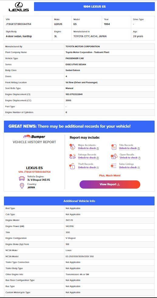

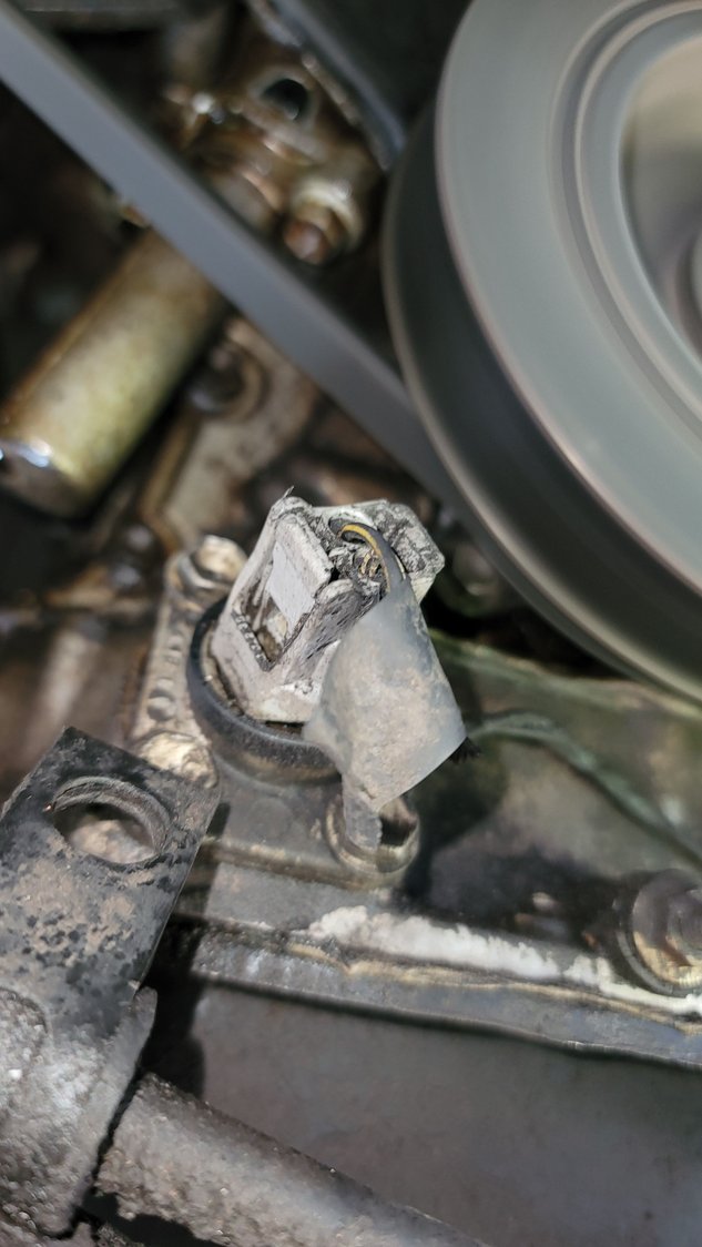

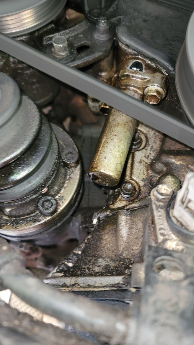

Well thats a relief, I appreciate that bit of information but I can guarantee the engine in this one aint gettin 27 MPG LOL I have no clue which engine is in this one but its definitely the original one but I dont know which nomenclature it is, Can you find out with the VIN? JT8GK13T8R0044764 i Just looked up the VIN and it shows that the engine is a 3VZ -FE. so that does really put my mind at ease that the transmission is doing what its supposed to. Its had this leak for a reeeeeaallly long time and Ive tried to get it fixed and it just wasnt where the mechanic thought it was coming from. He changed all the seals in the area thats behind that black cover that covers the timing belt. because it was visually leaking from that spot, He got that leak fixed and its still leaking from somewhere up there and I dont know what other area it could be leaking from like this but this is the best look I could get when i got up under there to take these pics. Any other Ideas of anywhere else it could be coming from above this area?

Looks like motor oil to me. Crank and cam seals go after awhile and of course valve cover gaskets. PCV grommet can also leak oil same for the hoses connected to it. The oil pressure sending unit (above the crank pulley) also tends to fail and leak given the leak location going by your pics it could be that. You'll never figure out the source until the engine is washed if you still can't see the source dump some dye in the oil and check with a UV flashlight in a few days.
Your car was manufactured in 03/1994 so you have the 1MZ-FE.

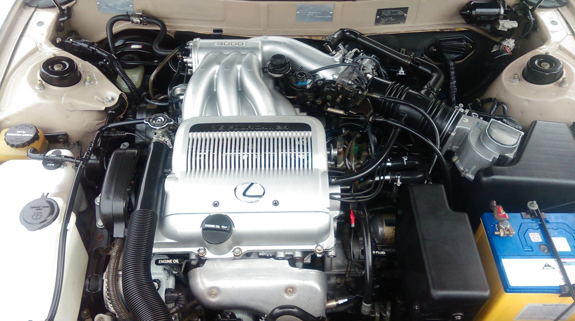

Originally Posted by LeX2K
<snip>
Yes, I agree. It looks like an aluminium block. For the benefit of the OP, a 3VZ-FE has a black painted cast iron block.

Very emmaculate brother!!!! This looks like the engine thats in the 93 ES300 ive been taking parts off of in LKQ mine is a lil different. This VIN look up says mine is a 3VZ

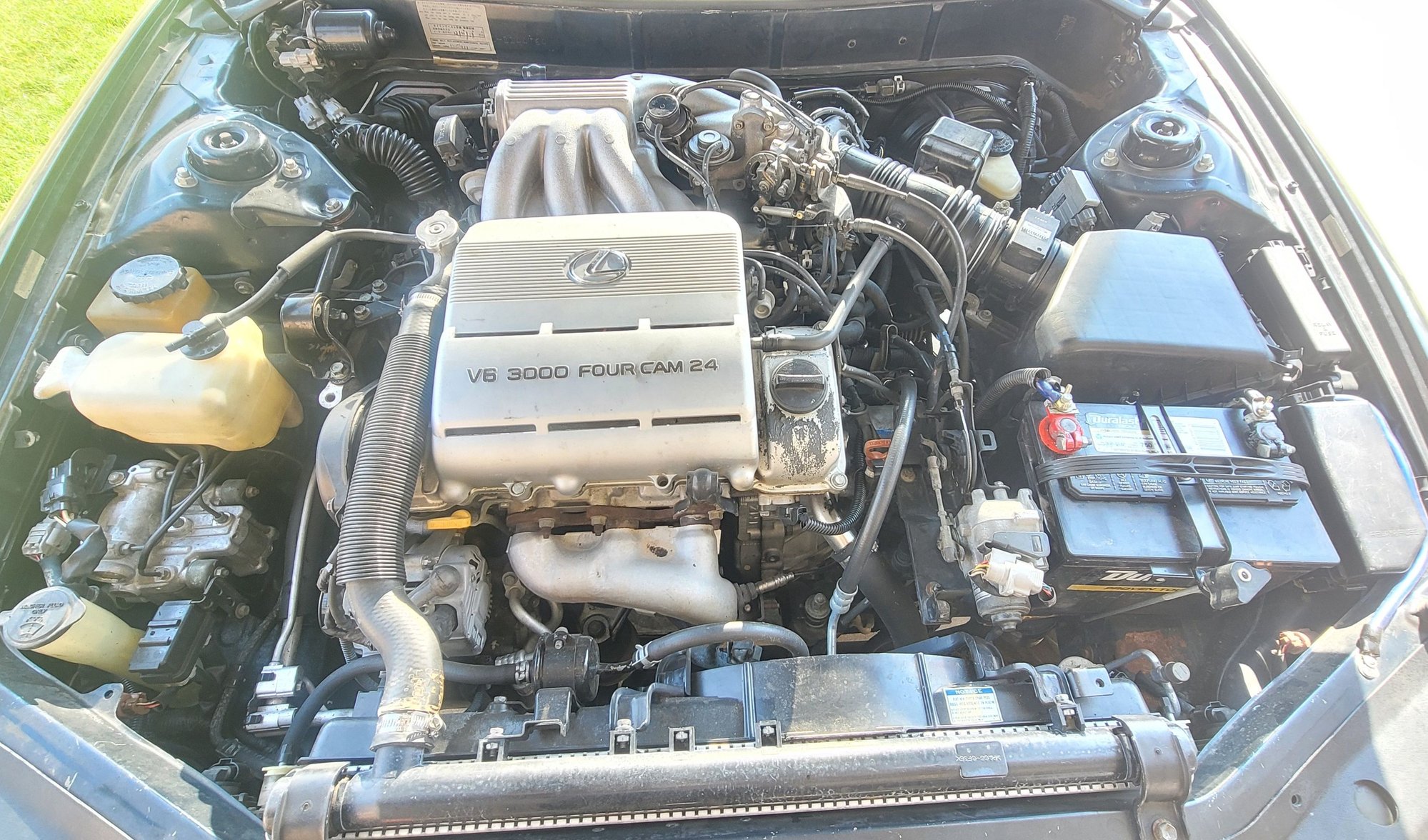

Im all over it, finding the dye and getting those areas looked at to see if thats where the leak is coming from. So this VIN look up site says mine is a 3VZ-FE and set up is a lil different than the gentlemans pic below. Coolant reservoir is a little bigger.
