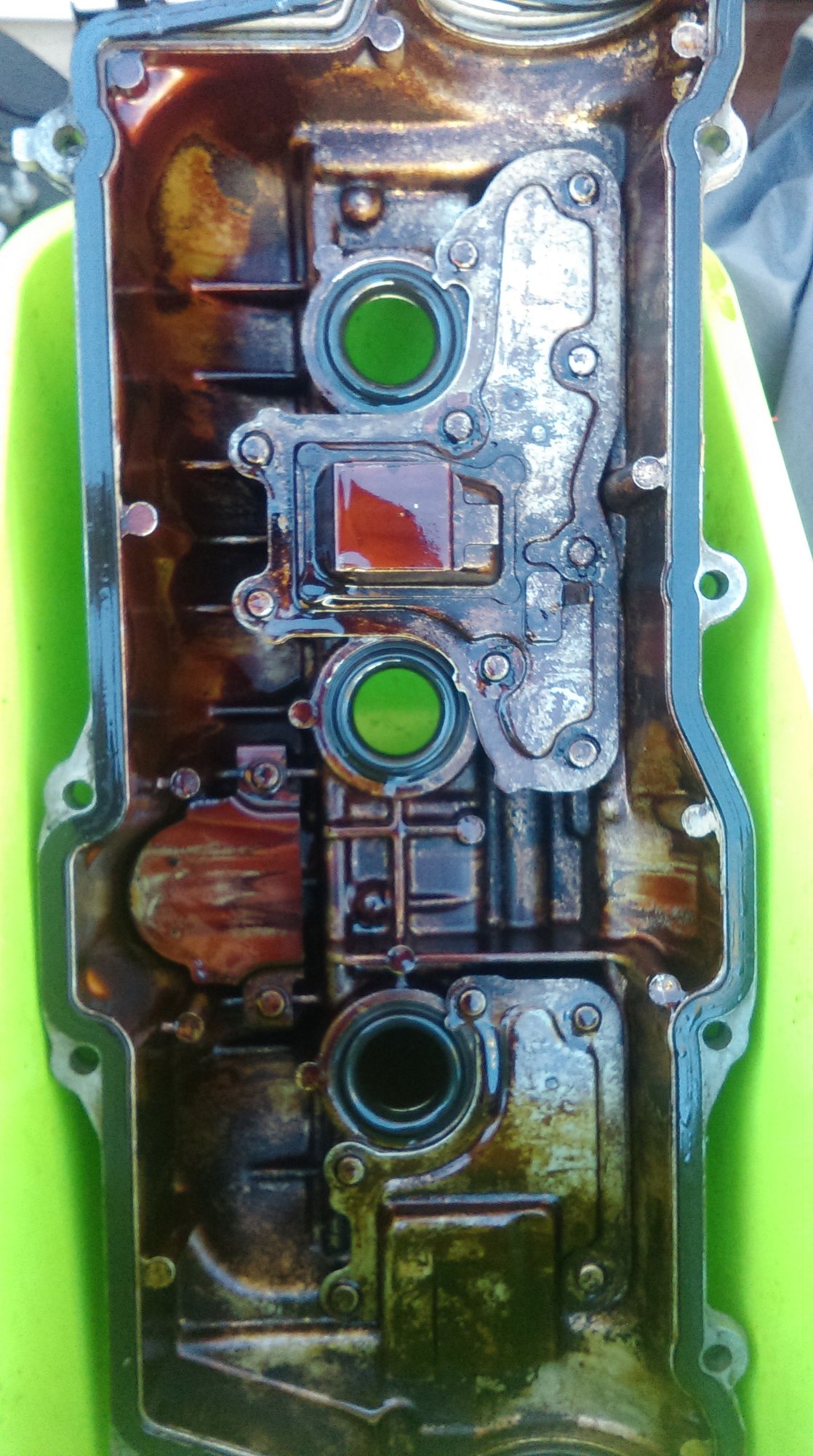

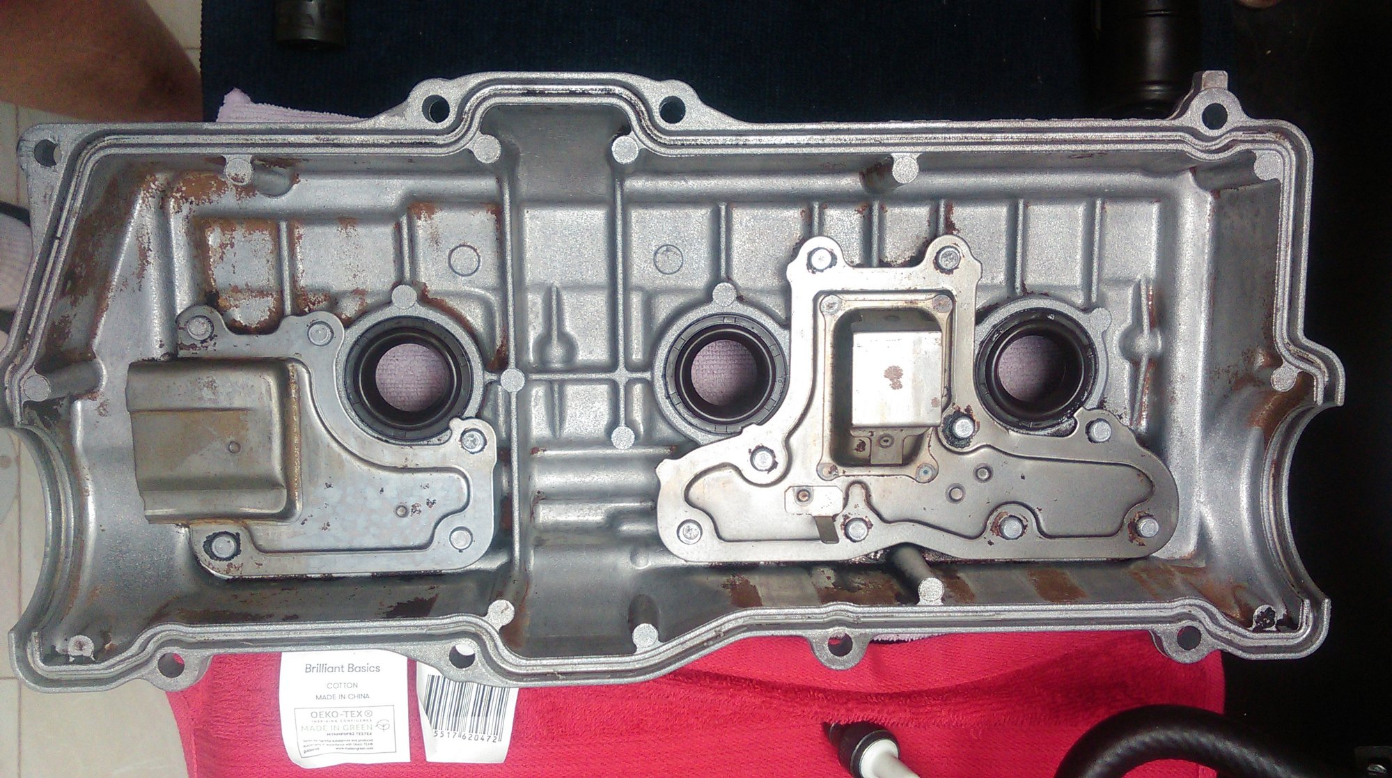

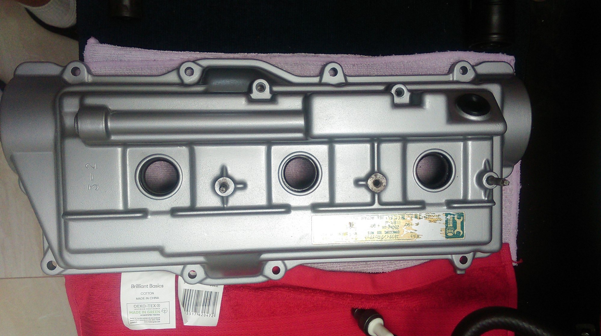

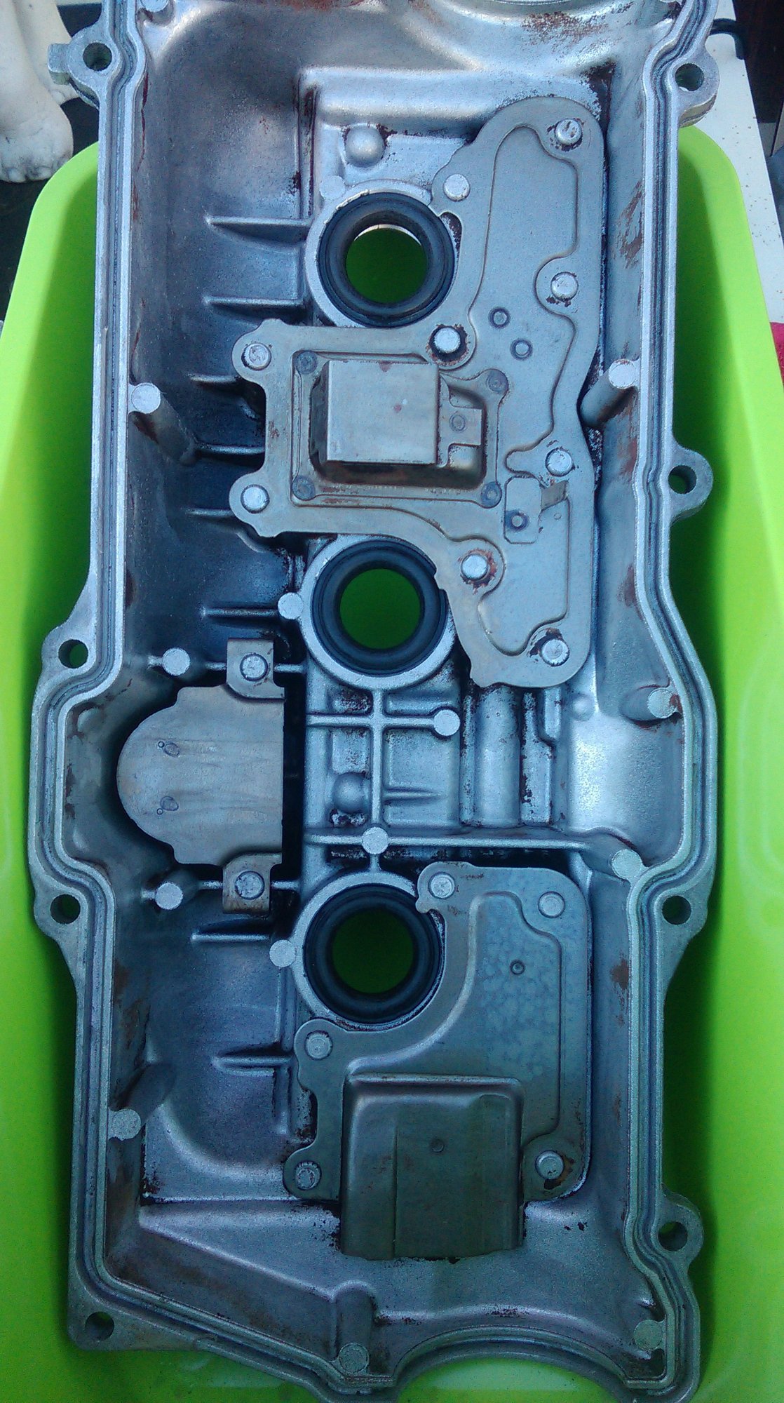

Also, if it's the valve cover gaskets that need replacing, properly clean the valve covers... like so...
In these next photos, the first two photos are the front valve cover and the next two photos are the rear valve cover.

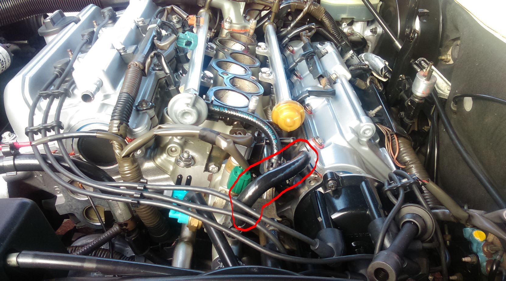

I personally removed the pipe which connected the exhaust manifold on the rear head to the underneath part of the inlet plenum.
I did that because it made things so much easier if I ever had to reach to the back of the rear head.
The EGR pipe was previously bolted to the back of the inlet plenum, specifically, to a an EGR appendix which then fed EGR gases into the bottom of the plenum.
Deactivating the EGR system also provided an extra benefit...
It was no longer necessary to route engine coolant through the throttlebody, the Idle Air Control valve, and the EGR appendix and then back to the manifold.
The reason? Super hot EGR gases are no longer being fed into the inlet plenum, hence the coolant route is longer required.
IAs a result, all of those little coolant hoses are removed and the connections on the throttlebody and IAC valve are now shut off with bungs.
In this next photo you can see the bypass hose that I installed. This in turn allows me to remove the inlet plenum, or the throttle body anytime I want.
It makes life so much easier when it comes to doing maintenance. And I daresay it will for anyone running an early 1MZ-FE too.
I also screwed a 27mm bronze "pipe fitting" plug into the exhaust manifolfd.
In the above photo, note the fine red circles. That's the EGR pipe that I removed. This photo is from 2019 when I dropped the engine to do some maintenance.

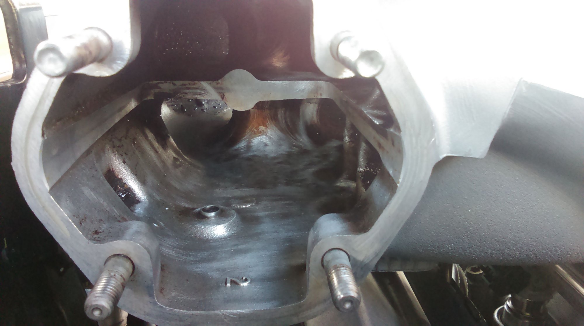

Take a look at the inlet manifold. See how sooty it was? That's what decades of EGR soot buildup looks like.
And this is what my inlet plenum looked like when I put everything back together. Trust me, it was filthy with decades of EGR soot.
I still have PCV gases running through the inlet plenum, but that's mostly fine mist engine oil, and PCV gases don't ruin manifolds like EGR gases do.

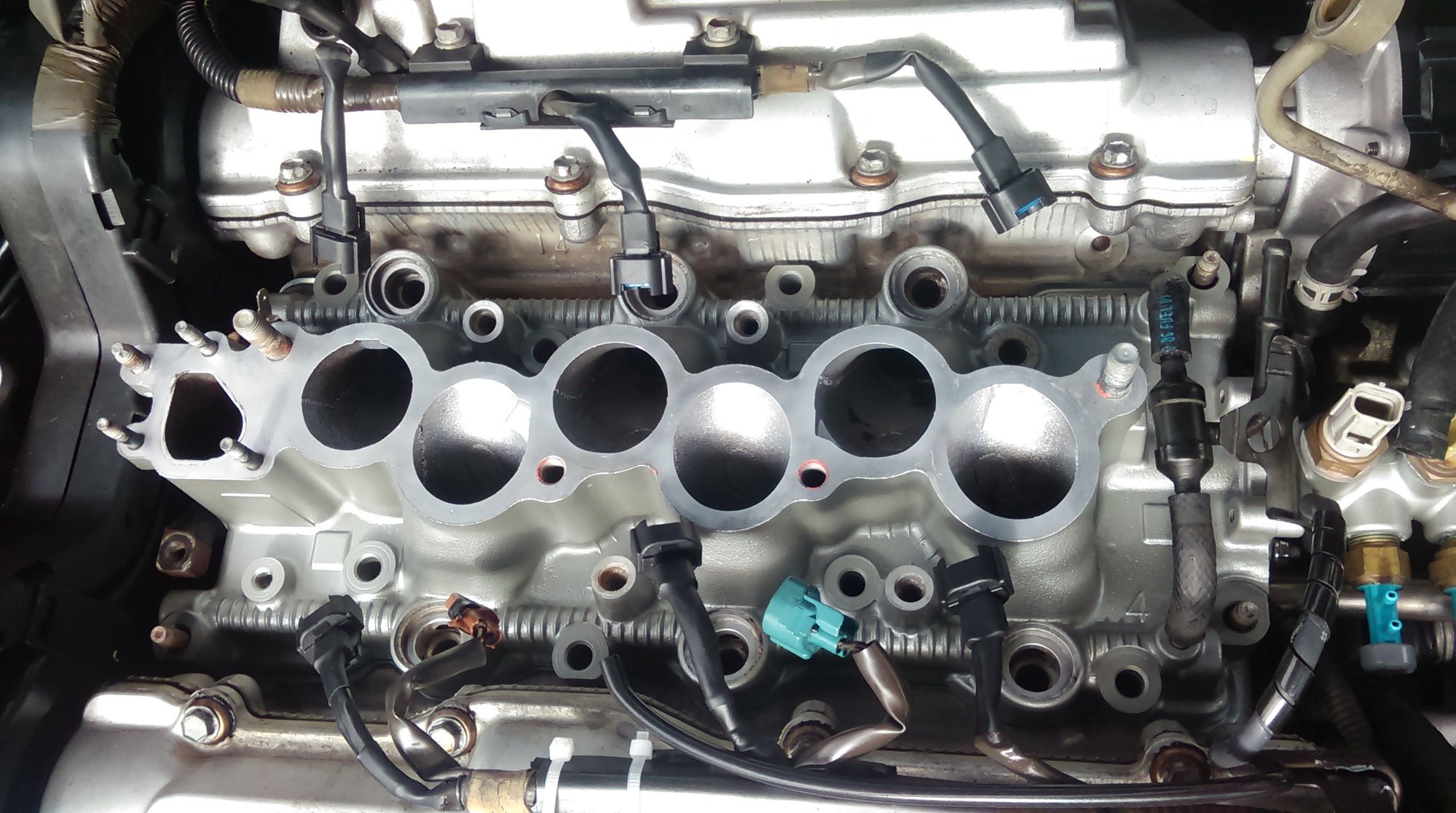

Also, last year when I doing all this work, I removed and cleaned the lower inlet manifold too. This is what it looked like when it went back in.
My point being, never waste an opportunity to do this sort of work if you can do it.

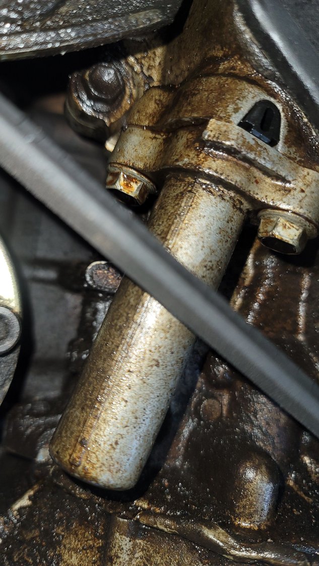

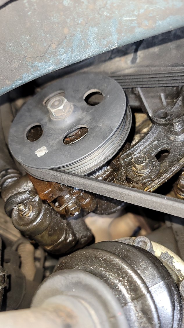

Did a brake job and got that tire off and was able to see a little better up in there. Im definitely going to pressure was the crap out of it today once I get the brakes back on and outside but for now. The two red circles I just had questions as to what they are, I gathered the pulley is the power steering pump? Im not losing any power steering fluid but could this be leaking oil from where its bolted to the housing? The other red circle where the arrow is pointing, its actually forming drips at the bottom there. Was wondering what that part is.
Old Aug 26, 2023 | 11:50 PM
Posts: 26,000
Likes: 4,313
Power steering pump and hydraulic tensioner for the timing belt. Tensioner only contains a small amount of hydraulic oil that is not your leak.
