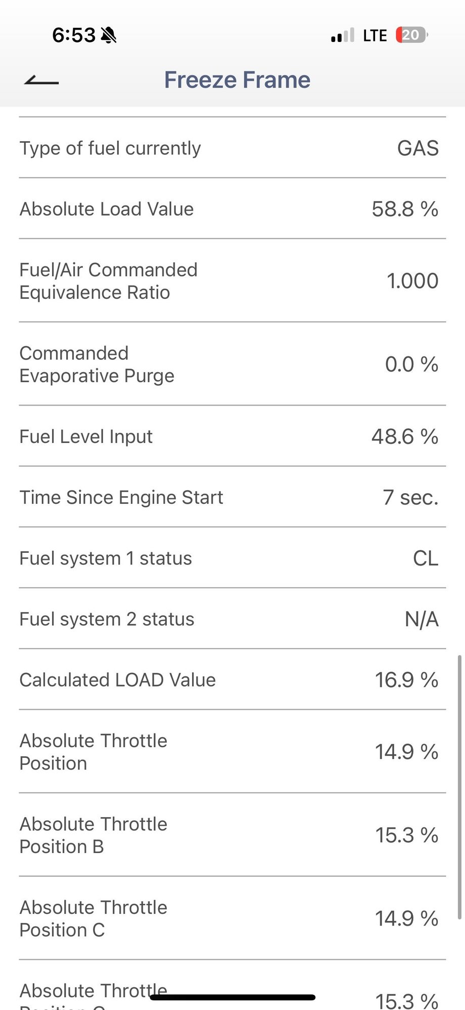

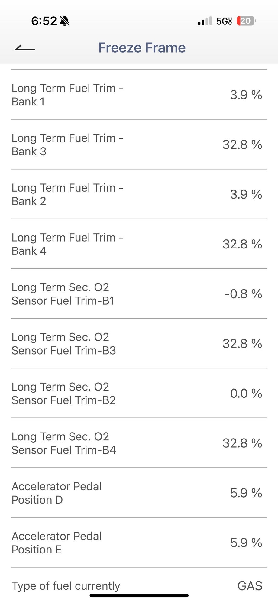

Allright, got the scanner. Here's what I have, its throwing code P1B95, which googling gives me:
Code P1B95 DescriptionThe diagnostic trouble code P1B95 indicates an issue with the Hybrid/Electric Vehicle Battery 59 Circuit High Voltage. In hybrid and electric vehicles, the high-voltage battery is a crucial component that powers the electric motor and other electrical systems in the vehicle. The battery pack consists of multiple modules or cells connected in series to provide the necessary voltage for propulsion.
The code did clear and the CEL went off, its still storing the code. So, like I said before doesn't have anything to do with the oil. It took a snapshot of what was going on when it first registered the fault:

LOL, I had CELs in my S560 with no 48v system and in my Lexus cars too. Cars have faults that light up CELs, its not a big deal.
Look at all the Priuses running around with hundreds of thousands of miles, there is nothing inherently unreliable about a hybrid system.
