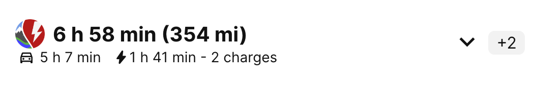

Hey all. So, driving our new Pacifica plug in hybrid in full EV mode has re-piqued my interest in an EV for myself. The main impediment for me is my several time a year trip to WV to visit my family. Charging on the way there and on the way back is one challenge, but the trip back without a full charge starting out really makes the trip back hard, with two charging stops resulting in 1.5 hours off the road according to ABRP.
This is my trip there starting with a full charge, this is quite manageable. There are only 4 slots at that EA charger in Stanton, but there is another charger in Raphine I can go on to if those are not functional or are clogged:
However, I arrive with a 12% SoC, and charging the i7 from 12% to 100% would take like 60 hours on a 140v Level 1 charger. There is a charger in town that is level 2 but you're only allowed to sit there for 2 hours. So, assuming I am only able to get recharged to 50% before I leave to come back, this is the return trip which is not manageable. That entire stretch along I64 in WV and through VA there are not DC fast chargers. Zero:

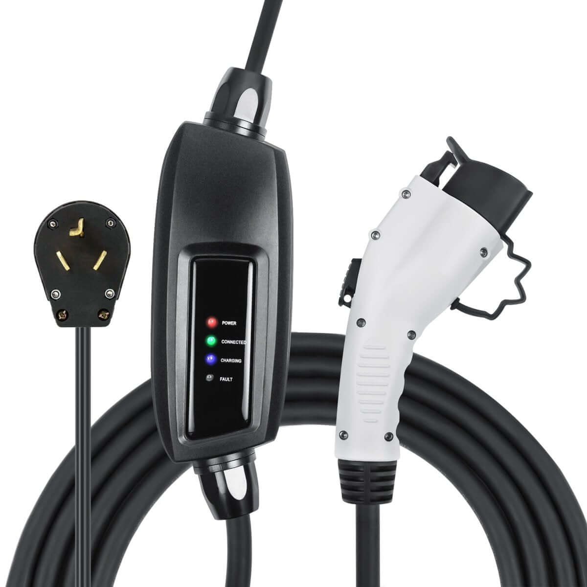

This should be what I need, right? The amperage is restricted because its a 10-30 outlet, so it would still take 22-24 hours to charge to 100%, but thats better than 5 days.
https://ev-lectron.com/products/lect...with-j1772-evs
If it's 16amp, depending on battery size, it will probably take 12 to 15 hours. 3.86 kW is a bit slow, you want to at least be charging at 8 or 9 kW/hr
