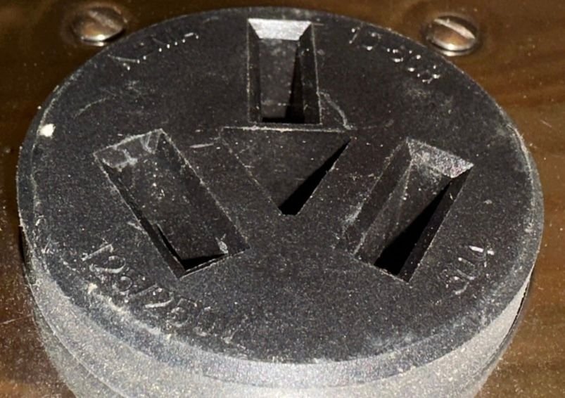

So I got back from WV, this is his dryer plug, it is a 10-30...but as I feared its very old. Not sure I would want to charge an EV through that
There is a 220v outlet in the building like I thought, but its this, what is this?!
Plug type should be etched on it. I can't see it from the picture posted
I got it, it’s a 10-50r

If wired by a pro meaning done correctly there is nothing wrong with that plug.

just looked closer... even says 10-50r, 125v/250v and 50A on the receptacle itself
Just check the breaker 1st. If it's a 50, or 60A, you should be able to safely charge at 42A.

It’s a 50 amp breaker, it’s a sub panel wired into the building off the main panel in the house.

looks ideal then to charge your new i7
