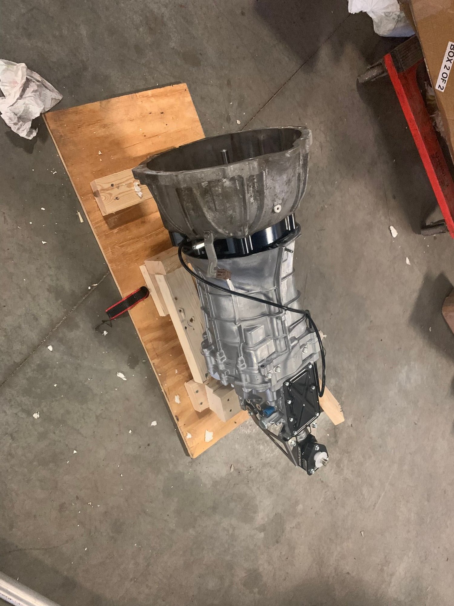

I also purchased a brand new 370z 6-speed CD009A transmission from them as well, which worked out great as they will cust the Nissan bell housing off and will install the necessary hardware to the new transmission to make the installation very plug-and-play. You will have to hammer our the transmission tunnel to make the transmission fit, this was one of the worst parts of this install.

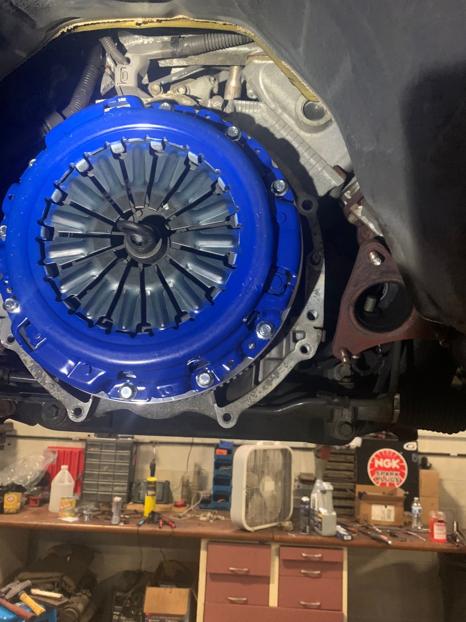

Went with a SPEC Clutch Disk Stage 1 - Nissan SR20DET-S15 2.0L turbo instead of what was included in the kit as I wanted a reputable brand with a full-face streetable clutch.
https://www.lmperformance.com/630628...20l-turbo.html

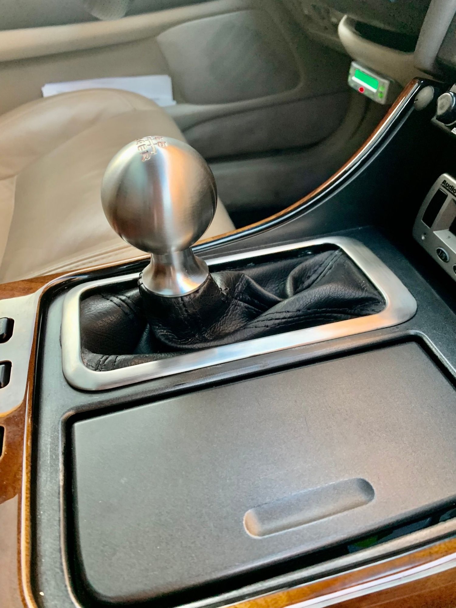

For the shifter, I went with the CD999 Technical Shifter as from what I've heard and read the ones included in the Collins kit is not the greatest.
https://www.serialnine.com/product-p...ter-relocation
The CD999 Shifter is a bit pricey but it is very high quality and offers great adjustability which was a huge plus for the shifter location. The shifter feels great, it clicks into gears. I had an AP2 S2000 before and for shifter feel this is pretty close.
Huge plus you get to keep the cup holder with this shifter. Other shifters force you to cut out the cup holders.

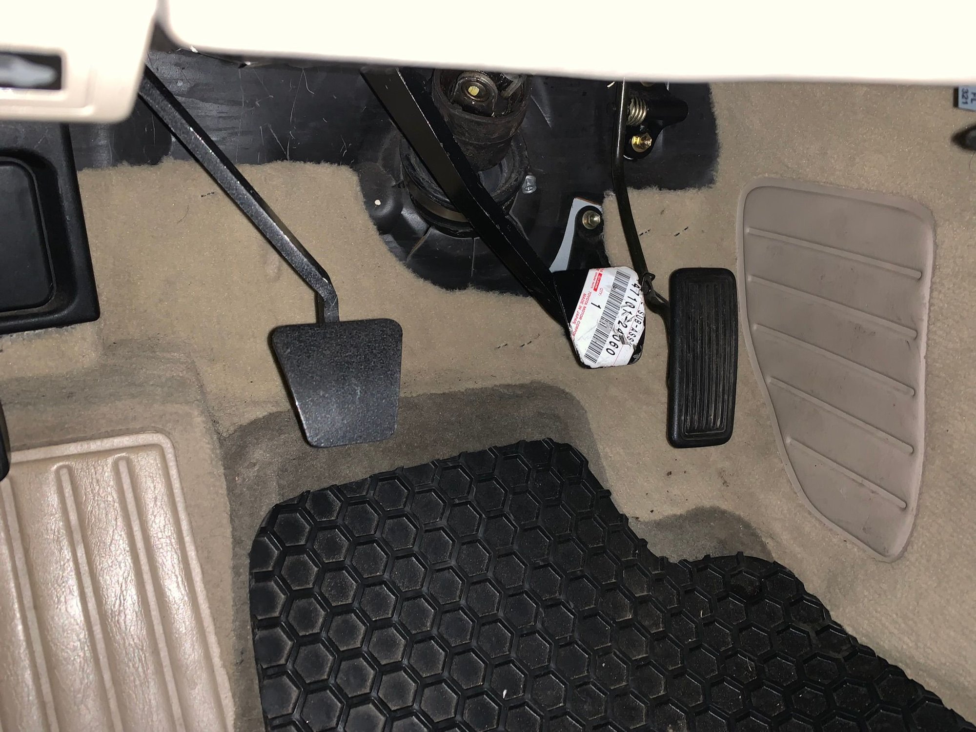

For the brake pedal, I went with a manual SC300 brake pedal setup was able to get this new and it fits well enough with a little modification. If you don't get the SC300 manual brake pedal you have to cut your stock one in half to fit your feet in there. I originally cut my brake pedal in half but couldn't wear shoes on my left leg as my shoes would hit the break every time I pressed the clutch.
https://www.lexuspartsnow.com/parts/...101-24060.html

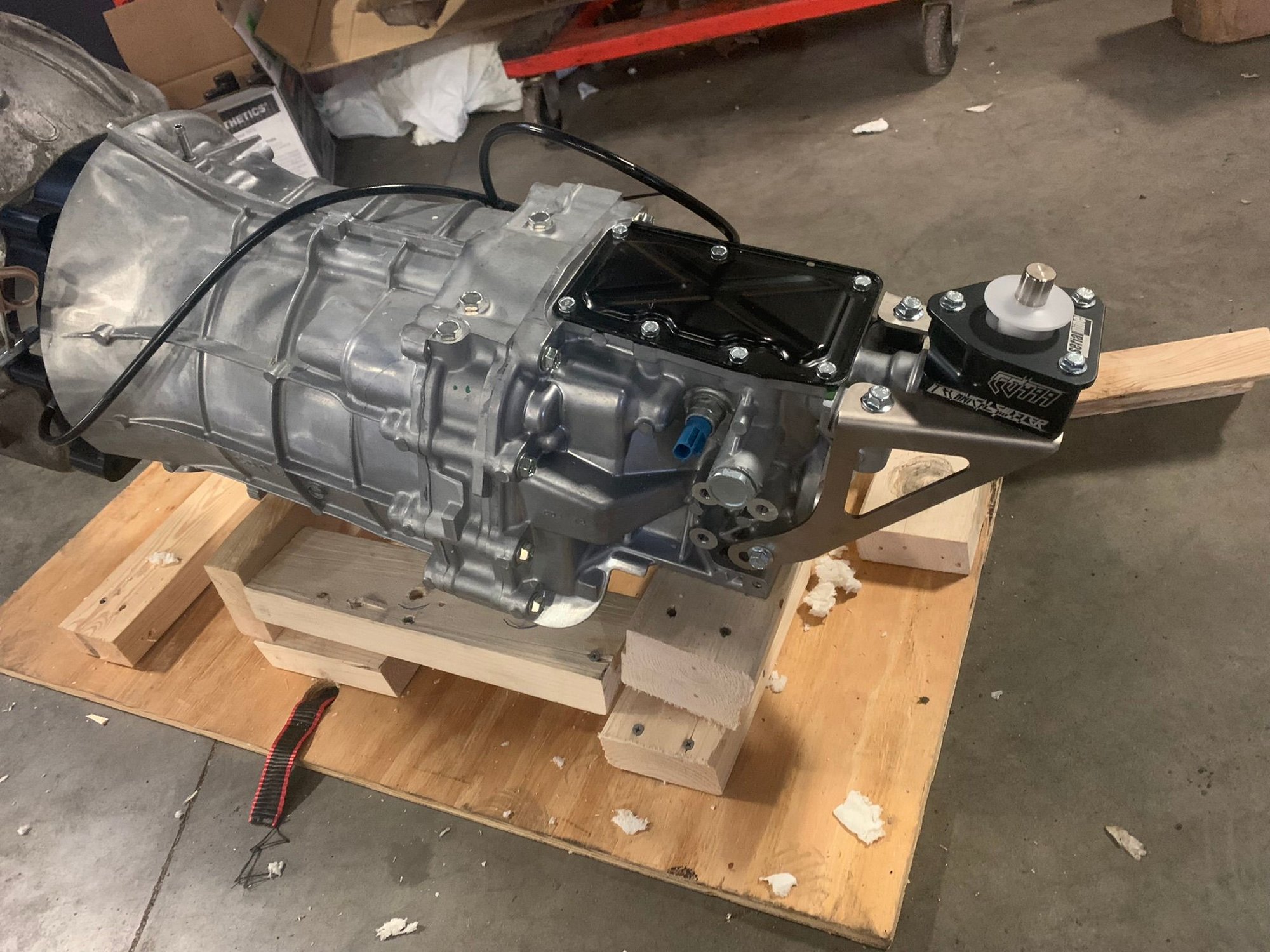

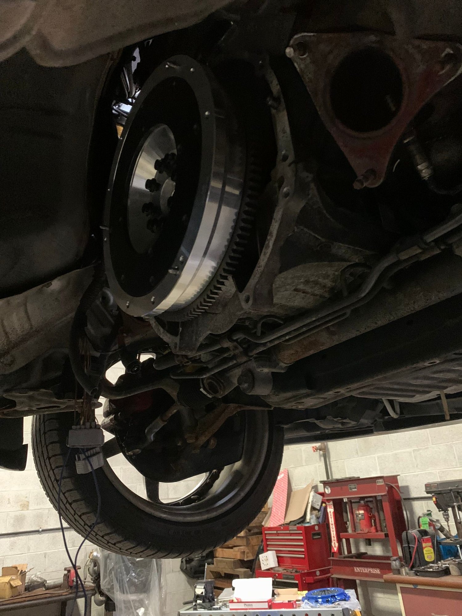

Some Pics of the flywheel and pressure plate along with the transmission before installation, you will have to bolt on the oem auto bell housing to the manual transmission.
Due to the size of the OEM bell housing and the new transmission, you will have to modify the transmission tunnel to make room for it to fit nicely. Enlarging the transmission tunnel was probably the worst part and most labor-intensive part of this swap.

Pedal setup

Thanks to the adjustment of the CD999 serial nine shifter this was the final product. Looks OEM and I get to keep the cup holders.
