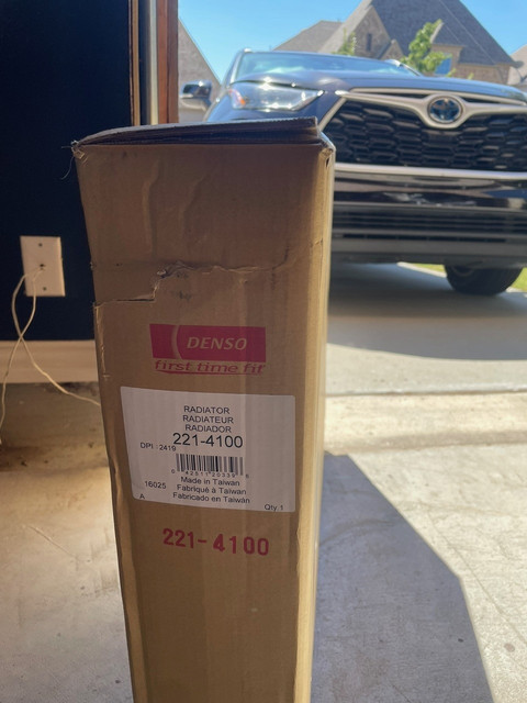

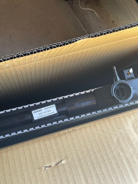

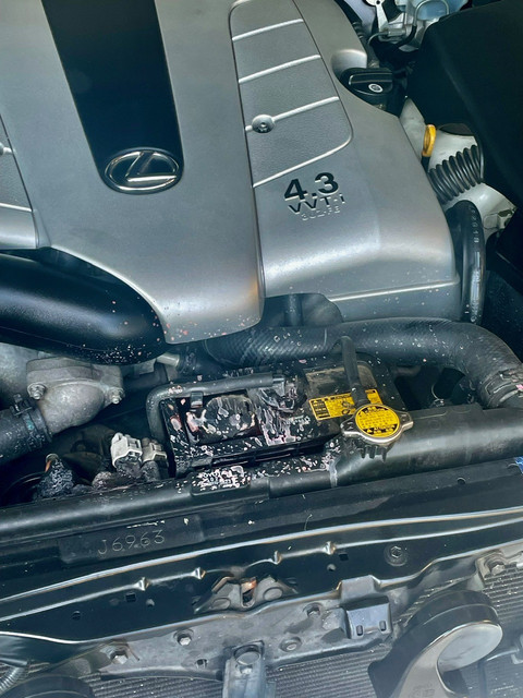

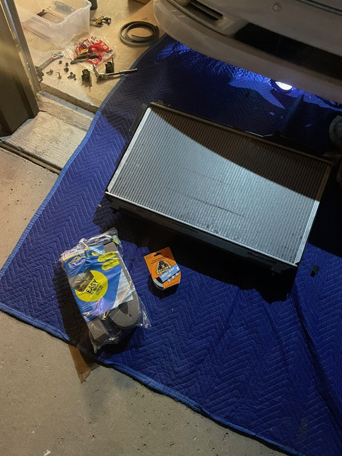

The radiator decided to start leaking in October 2025, so I replaced it with a Denso unit:
Part number: 221-4100
new radiator:

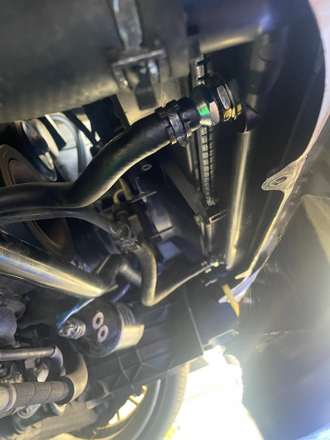

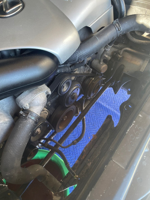

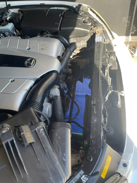

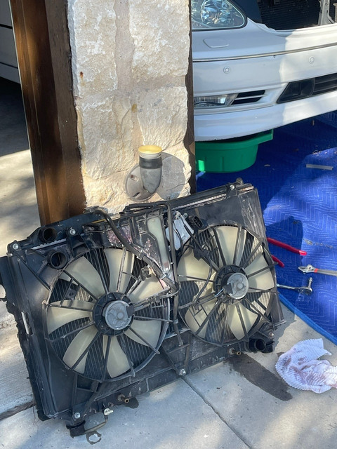

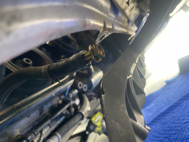

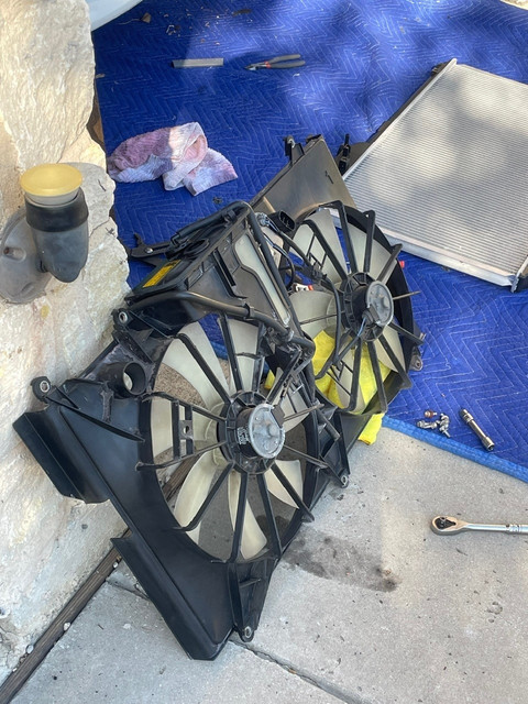

Drained the coolant and removed the radiator:

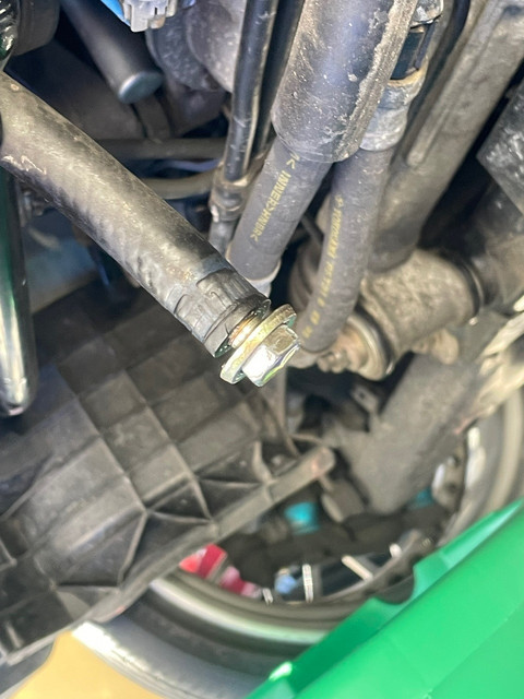

Plugged the transmission hoses than run into the radiator

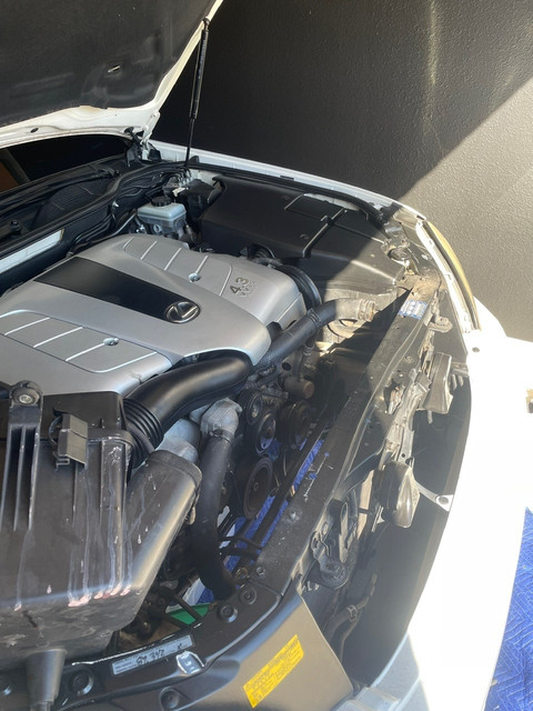

Added some aftermarket foam on around the whole radiator as the old one was disintegrated.

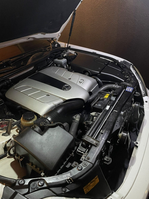

Radiator back in:

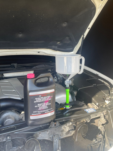

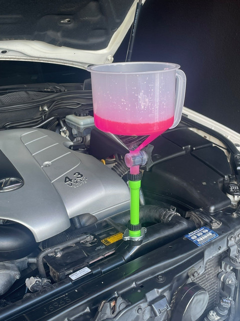

Bleeding the cooling system:
Made sure the transmission hoses than run into the radiator were back on and not leaking.

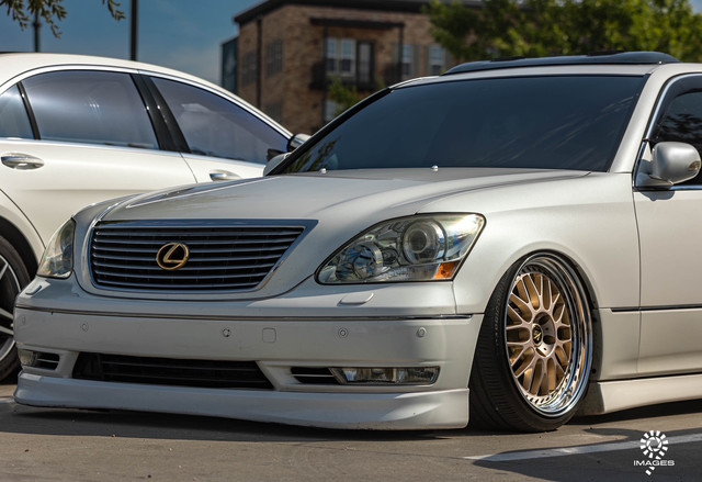

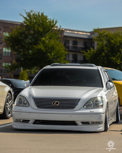

Local car show:
