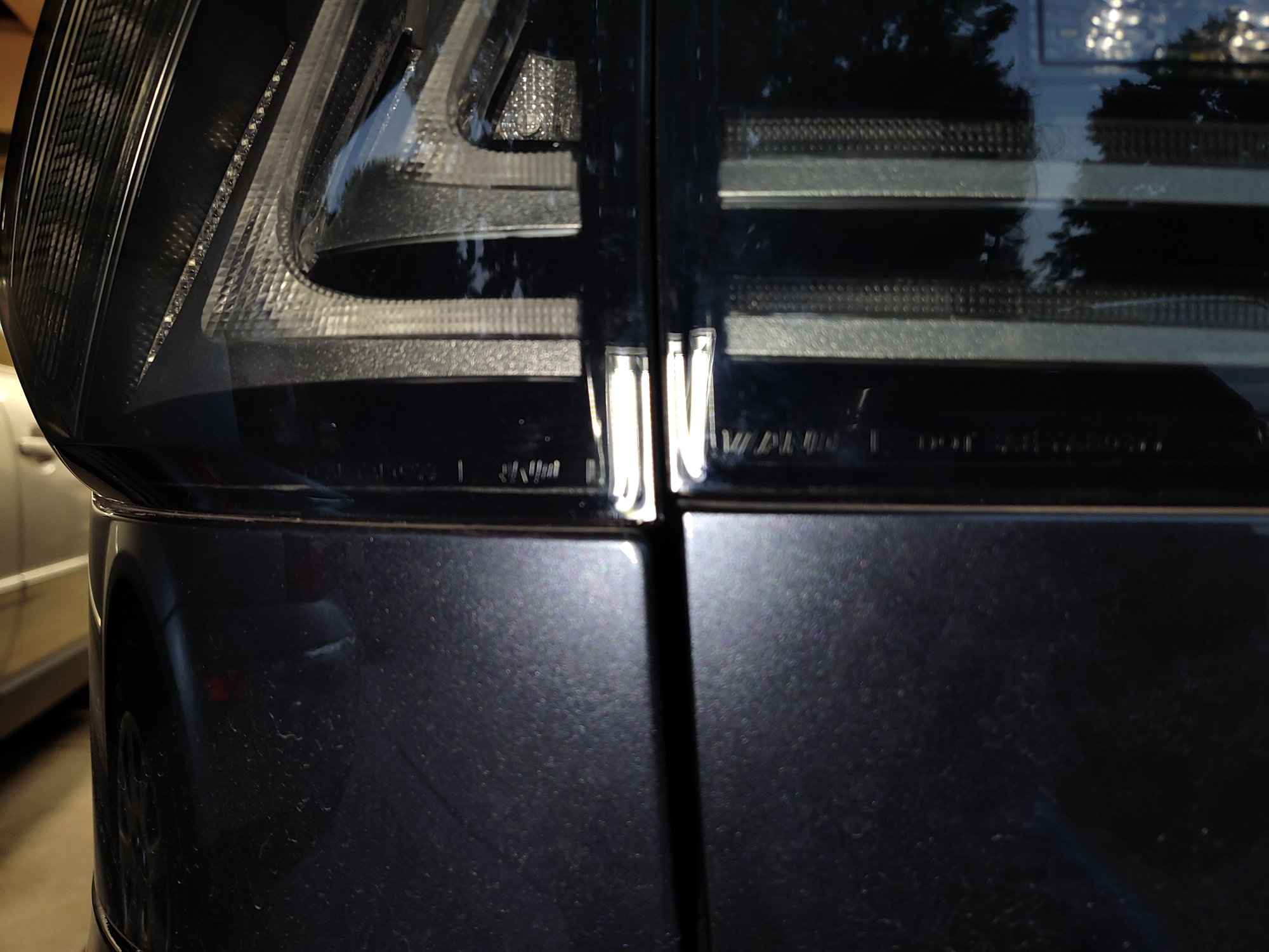

The fitment of the Vland taillights is suboptimal... However, the aesthetic upgrade is stellar. The two pieces of the taillights almost rub when the trunk is closed.

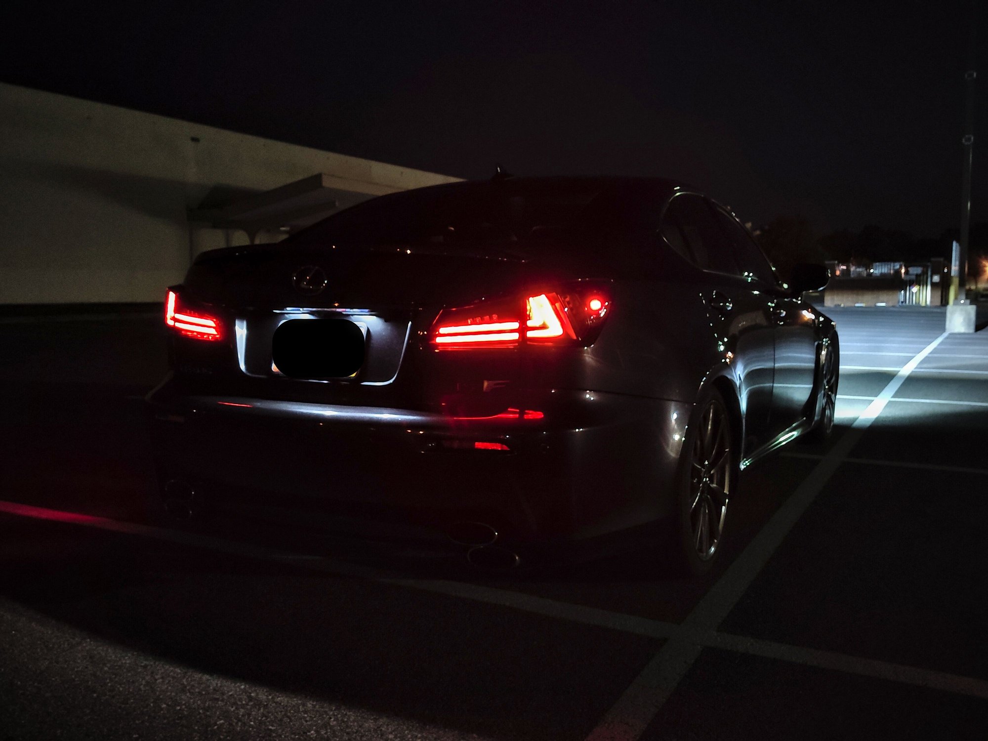

I cruised for about 200 miles today. I'm excited to begin modifying it. The muffler delete should make the experience even more enticing. I'm pleased with the difference that the taillights made.
