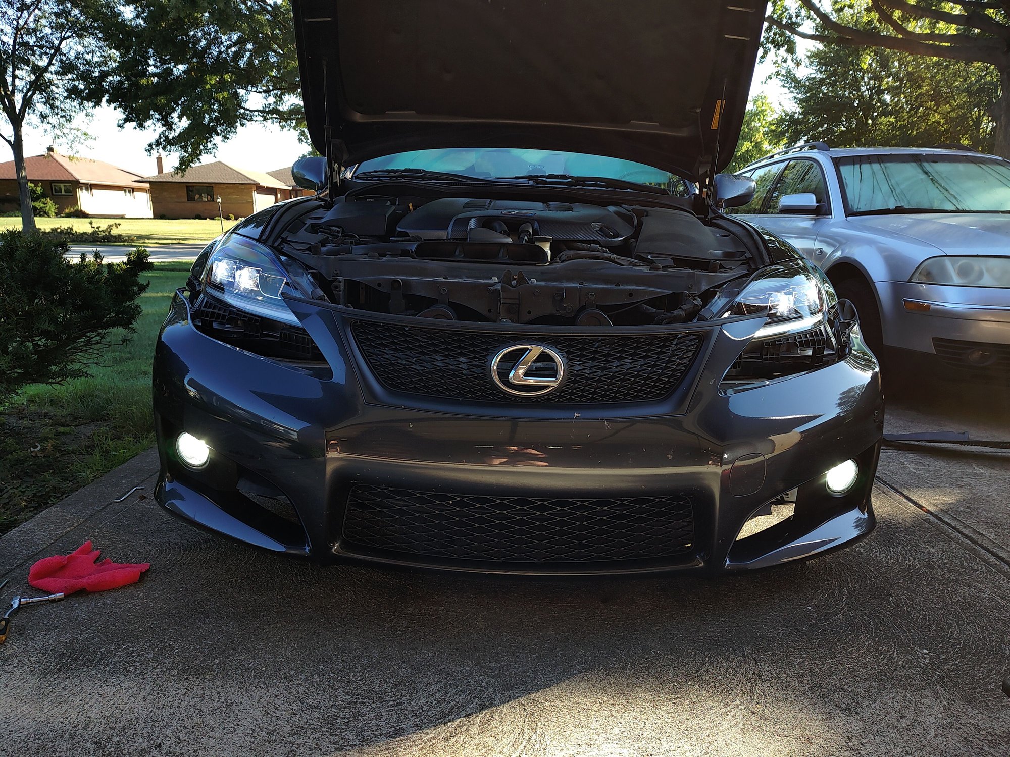

I removed the front bumper to try and remedy the passenger's side DRL today, however, it seems that the light has malfunctioned. Unplugging, cleaning the pins, and replugging didn't solve the issue. Since the low beams, high beams, and turn signals work, I won't be replacing the headlights. I'll just drive the way it is.

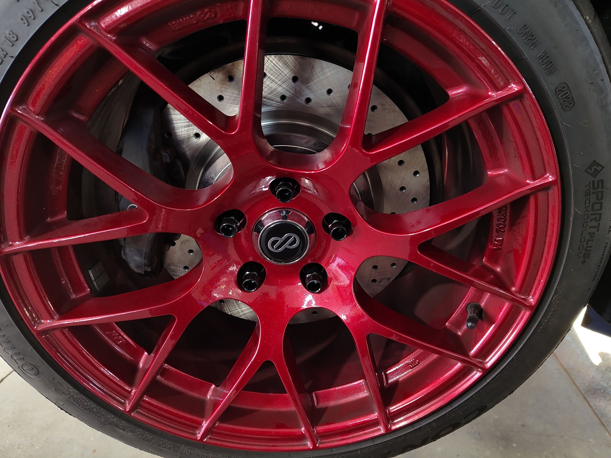

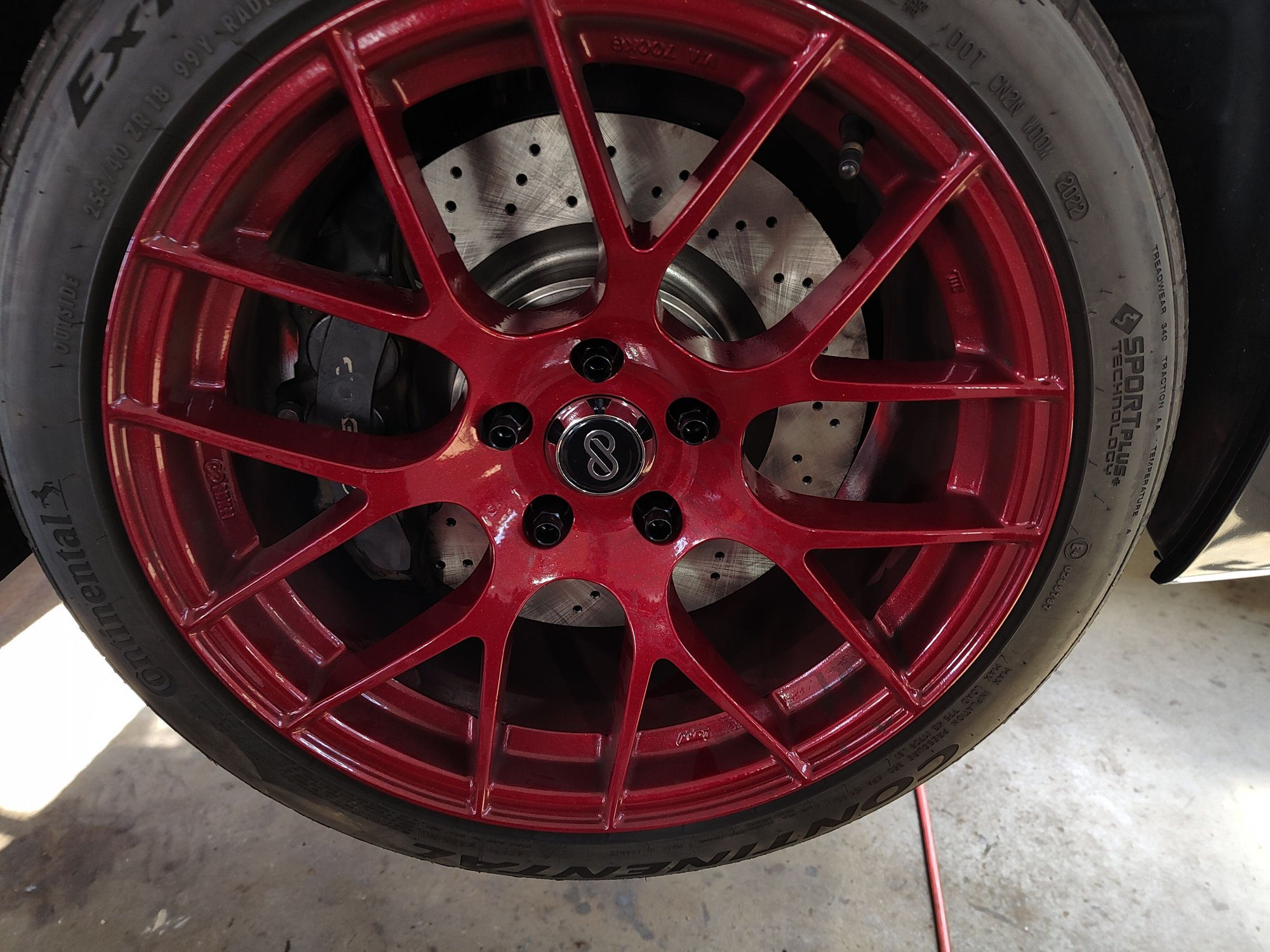

There was a local listing on a set of wheels that I wasn't certain if they'd fit the IS F. The forum suggests that the wheels should fit. I took the gamble and purchased them regardless. If they don't end up fitting, I'll have to resell them. From my research, there isn't an IS F online with this set of rims. The tires are Continental ExtremeContact Sport 02, the exact summer performance tires that I've been desiring. I'm actually more excited to test the grip of the tires, than the aesthetic transformation that the rims will offer. The rims are powder coated a custom color, and they are absolutely stunning. I need to order hubcentric rings and lug nuts. I anticipate that I'll have them mounted in the next two weeks, or so. After I mount them, and test drive to ensure that there truly is no rubbing, then I'll take some proper pictures.

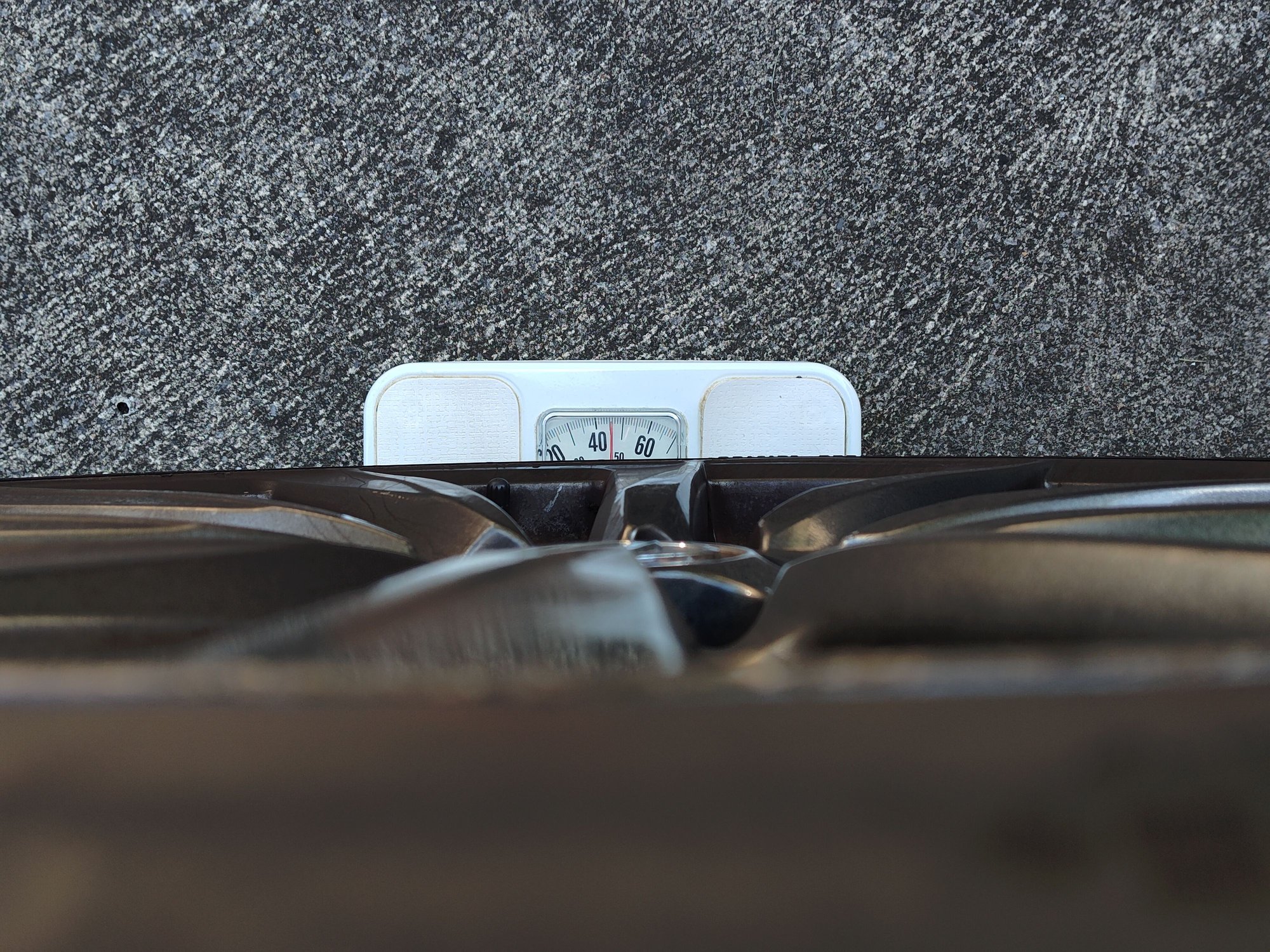

I will weigh both the stock wheels, and the aftermarket wheels, when I swap them out. From reading, it seems that the stock rims weigh about: 23 lb for the fronts, and 27 lb for the rears. The DWS06 tires in OEM sizing weigh about: 22 lb for the fronts, and 25 lb for the rears.
Stock front wheels weight: 45 lb
Stock rear wheels weight: 52 lb
Total = 194 lb
The Enkei Raijin weigh about 21 lb in 18x9.5" +35. The Sport 02 tires weight about 26 lb in 255/40R18.
Raijin wheels weight: 47 lb
Total = 188 lb
While it's not exactly a 20 lb difference as I initially anticipated for the NT03M rims, the grip should be extraordinary. We will find out the true weight difference soon enough.

I'll post all of the pictures in the thread I created for the wheels.
https://www.clublexus.com/forums/is-...r18-tires.html

Here are the weights that I captured for the OEM wheels:
Stock front wheels weight: ~46 lb
Stock rear wheels weight: ~50 lb
Total = 192 lb
The tires are worn, so that may potentially alter the results?
Here is the weight for the Enkei Raijin wheels:
Raijin wheels weight: ~48 lb
Total = 192 lb
Even though the weight is the same, the car feels completely different driving normally. I probably won't get around to testing the tires to their full capacity until next weekend.

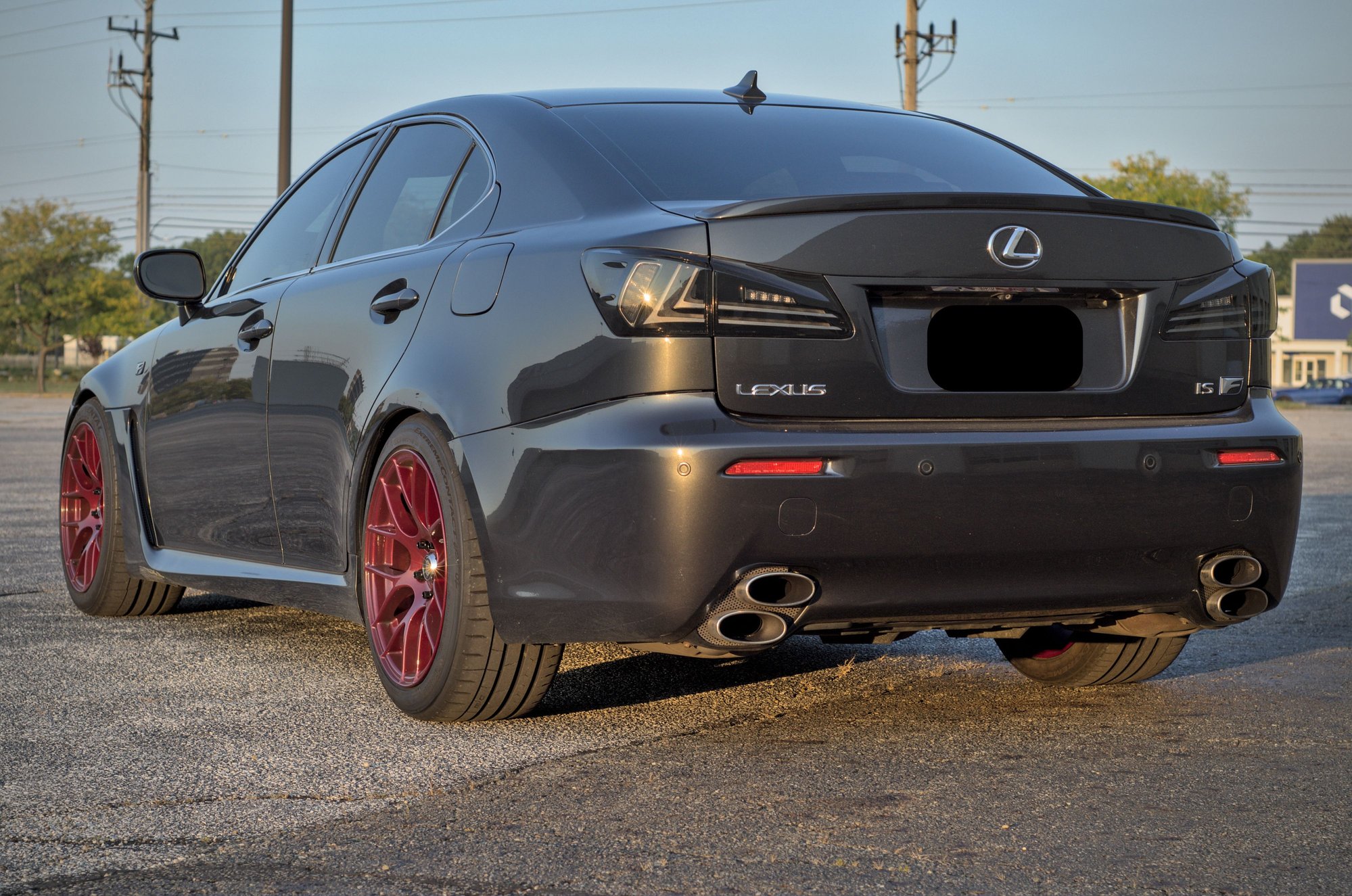

The roads where I can test handling are closed due to repaving, so I wasn't able to push the tires yet. Even with these tires, traction control still interrupts WOT's. I expected that the best summer performance tire would grip more optimally, not still be limited by the 255mm width. I love the way the car looks right now, though. These are the newest pictures:

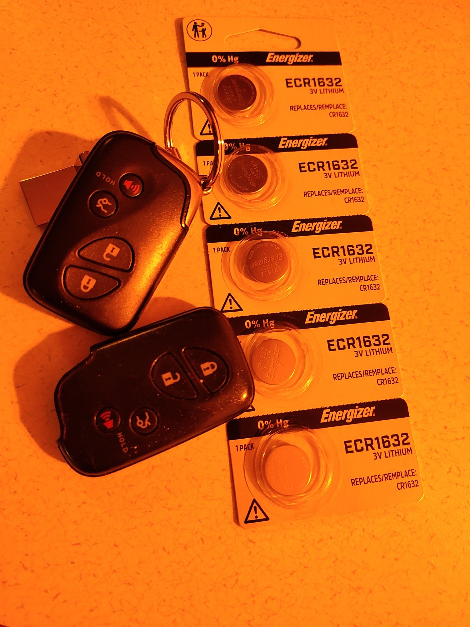

I'll be replacing the remotes' batteries since I don't know when they were last replaced.

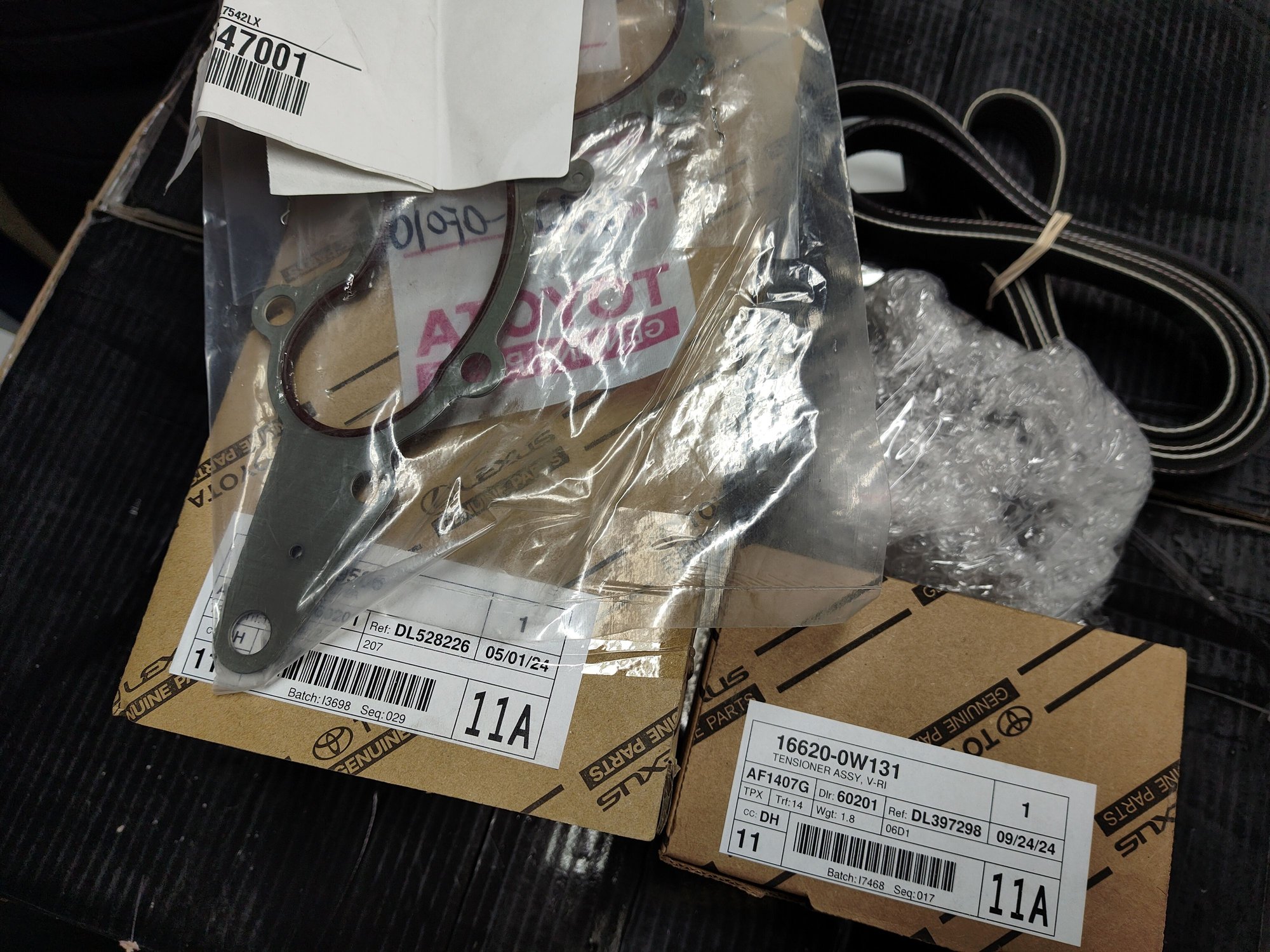

I scheduled an appointment on 10/26 to learn how to replace the brake pads and rotors. I'll research in the meantime on the procedure and the torque specs necessary.
The parts pertaining to the water pump, pulleys, and belt scenario have shipped and are scheduled to arrive on Tuesday. We'll find out if I end up replacing them before storing the car for winter.

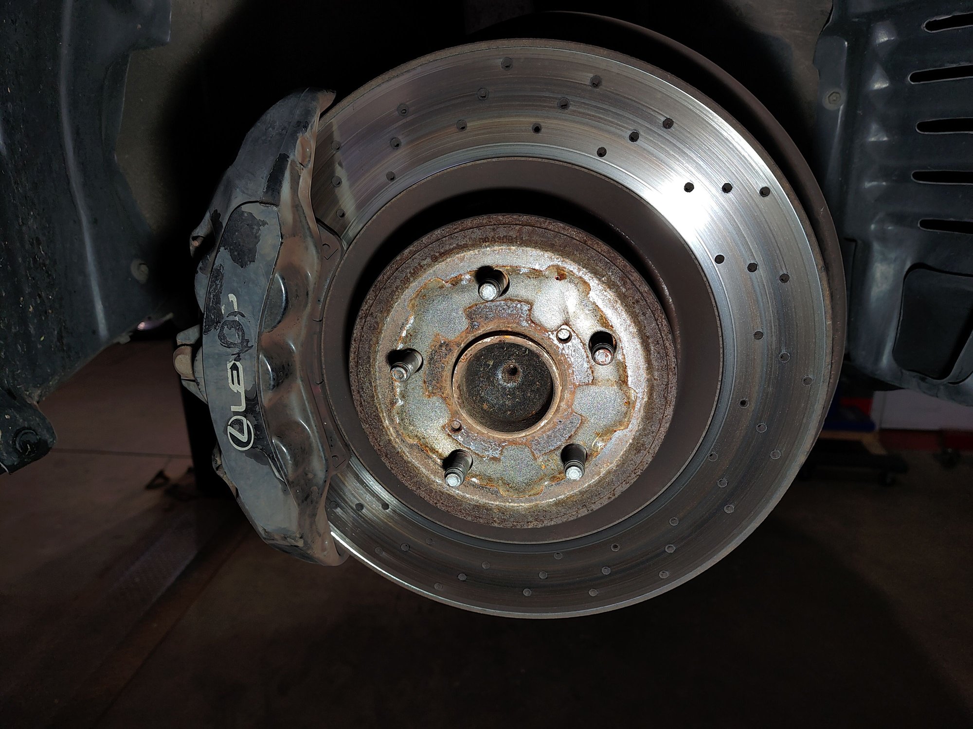

There is no sane reason to expect the threads in the caliper will be a problem. Besides, Helicoils are a poor fix for something like that. I would Timesert it for sure. My experience with Timesert is vastly better than Helicoils.
I replaced the brake pads and rotors today. This was the first time I've done this task myself, and it ended up being quite easy. The caliper bolts loosened out fairly easily, and you were correct, I didn't end up needing the taps. This car has much less corrosion than my STi had, though. So, I used brand new bolts on the calipers and I expect that they'll loosen out easily the next time I replace the rotors.
Thus far, I've replaced the transmission filter, transmission oil, rear differential oil, and now the brake pads and rotors. I should be able to replace the serpentine belt, tensioner, water pump, and coolant, as well then. That'll be a project for next spring.
