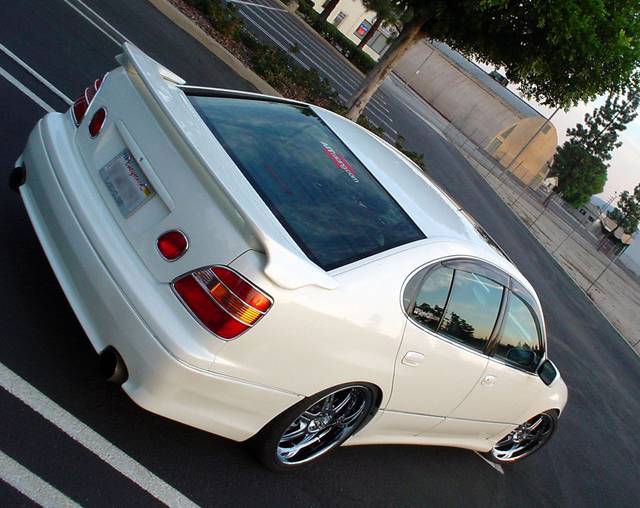

Let me show you my old set up.
These are 20x8.5 and 20x9.5 with +35 on both, running on Dunlop SP9000 245/35/20 and 285/30/20. I think this is a nice set up for sitting almost flush.
