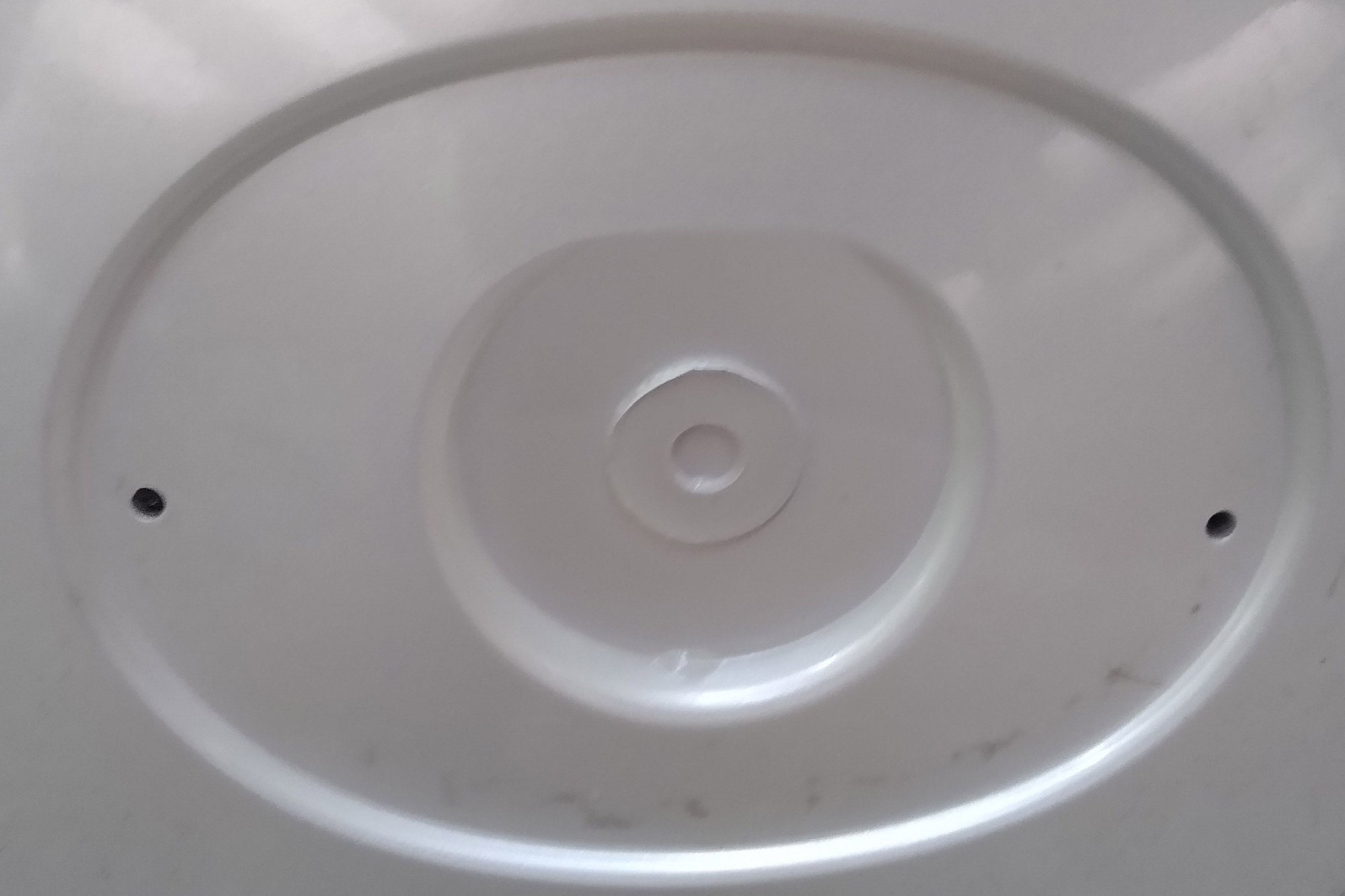

Houston, we have a problem...
...an indentation where the rear emblem is mounted... Now I need to summon my mastery of redneck engineering skills, to get my new, black Lexus "L" emblem mounted cleanly. I also need to get the Goo Gone out, and remove the last few bits of adhesive...
The original Lexus rear emblem, came off easily, with a hair dryer to warm the double sided tape and a minute or two to cut the gummy tape with some dental floss...

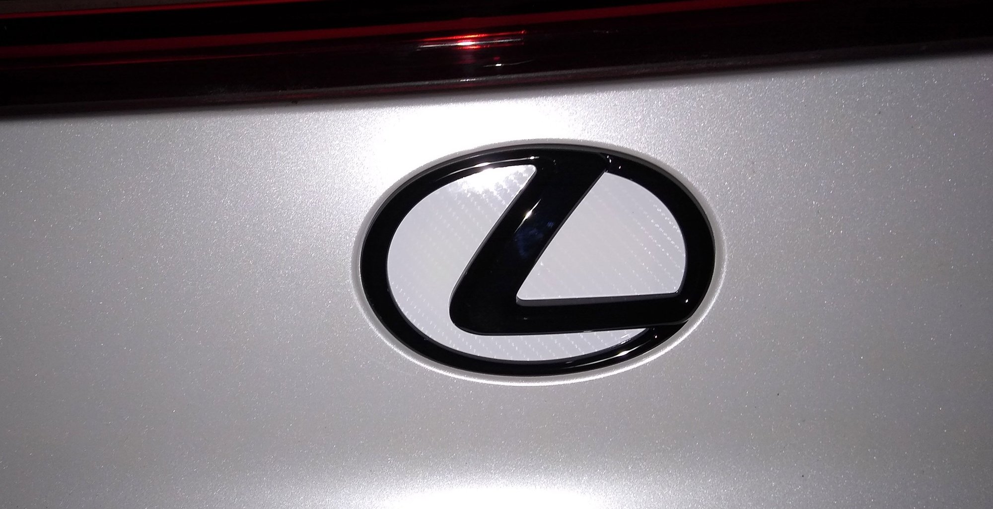

No expenses were spared... A high tech purple sharpie, a paint can lid to make a piece of backing cut to size, glossy white carbon fiber vinyl for the background.
The black Lexus "L" logo emblem on top of the custom backing and white carbon fiber vinyl...
Some of the free mini roll of double sided tape I received with the previous order of faux carbon fiber seat control button covers, used for mounting my new custom emblem...
Another successful feat of redneck engineering(in my opinion) "hybrid incognito" mod. Only the front emblem to go to enter full hybrid stealth mode... ... and I think I have a hookup on a paint matched, handmade Lexus "L" emblem...
Tomorrow when it warms up in the afternoon, I'll get to stripping the tape backing off, line up the emblem with alignment pins and holes, and VIOLA! Another custom, one of a kind emblem mod on my UX...

Finally got around to mounting my new black, rear Lexus "L" emblem tonight, in the dark of course...
One more hybrid moniker deleted. One more on the front to go...

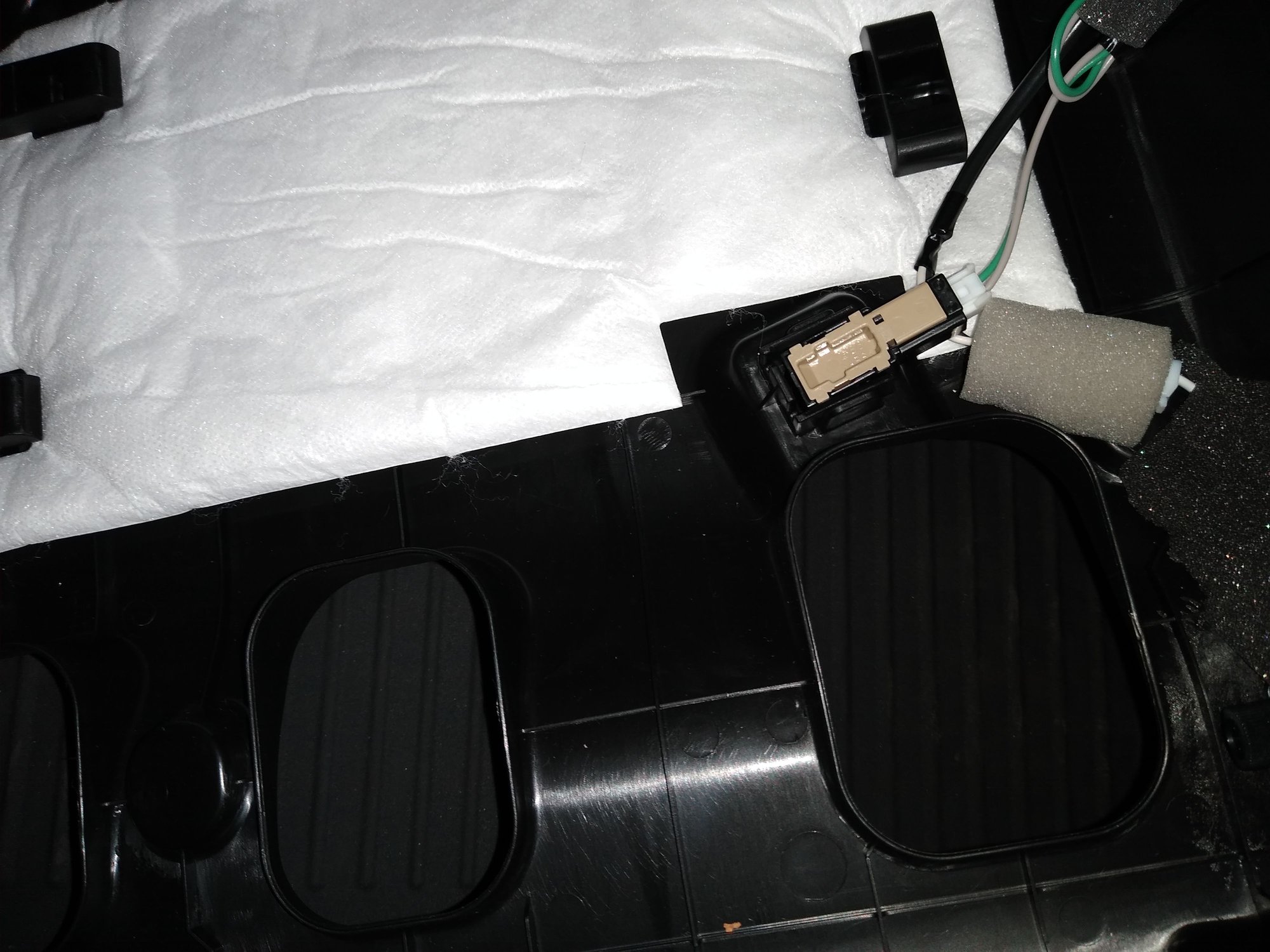

Passenger side footwell LED successfully installed...
Lexus OEM(photo taken in the dark)
My LED footwell mod(photo taken in the afternoon, sunny and clear)
This is a "minimal tools required" mod. The most difficult part is the location of the LED. CAUTION: Some planking on the door sill is required. Removing the dash panel involves 4 spring type clips, undone with my fingertips. Once the panel is dropped, there is a pair of plugs to disconnect. 1 of the plugs is inside the foam wrap, but the clip to disconnect is easily accessible. Once the plugs are disconnected, you can unclip the Lexus OEM LED while working in the location of your choice(bench, table, cargo area, etc.). I used a small regular screwdriver and my favorite plastic pry tool.
My new LED snapped into place. Fits like it was made for a Lexus...
All plugged back in and working as intended.
