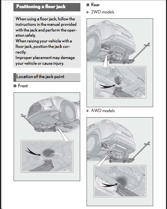

Does anyone have any photos of the front jack point? It’s not very clear in the user manual.

Bringing this back up - anyone have an updated link or a copy of the pdf file above? Can anybody help me understand where the jack points are for the ux250H?

Same, I have to do an oil change soon and would like to know the two jack points in the front and rear. Rear is probably the diff or something, but need to be sure.

I got this from the owner's manual
