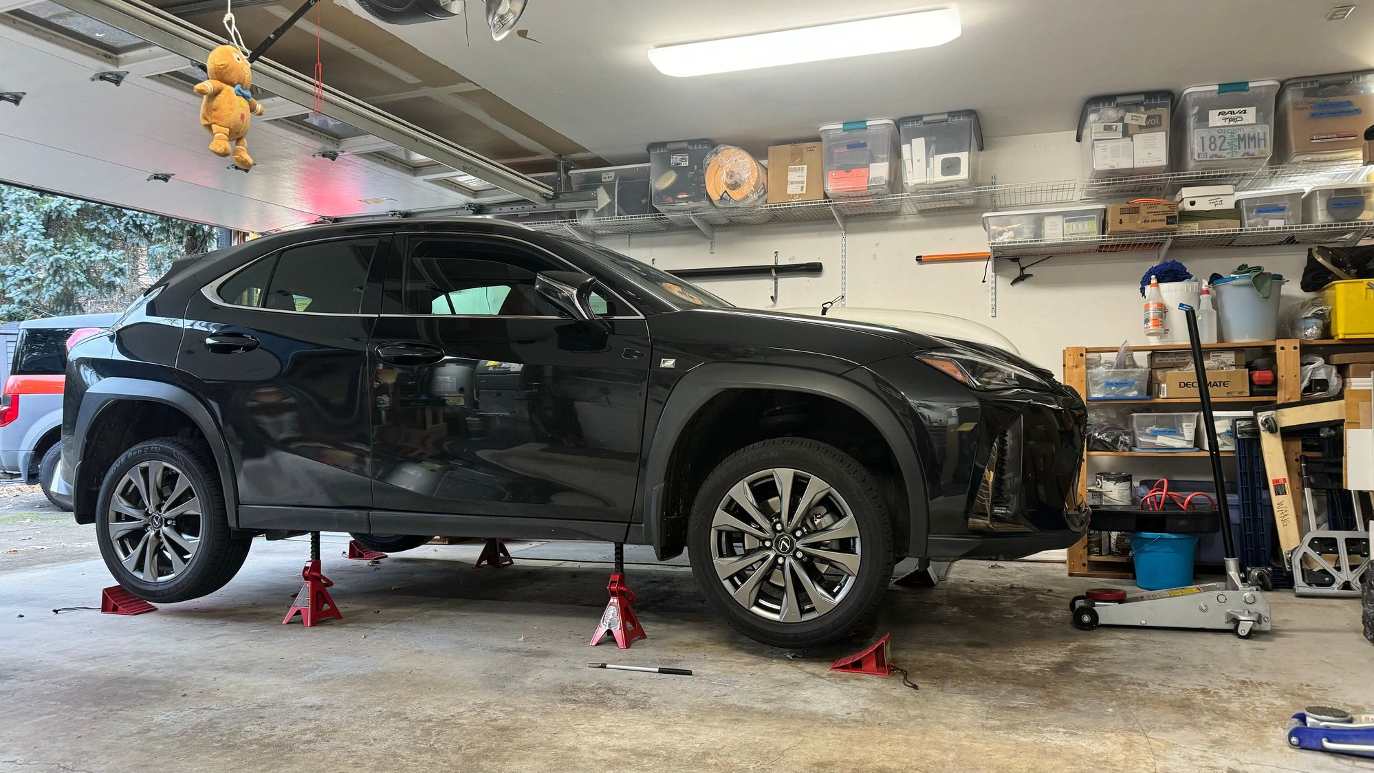

That’s really high and good to hear you haven’t needed much maintenance. My 2020 is at 80k miles. Brakes are still great but may need new rotors before I hit 100k miles. I replaced my transmission fluid this weekend out of caution.
update: I also replaced my rear differential fluid, the old fluid still looked fresh.
Viktor’s videos have been very helpful. I just had to figure out the jack points since I don’t have a lift.

yes, I did it myself in my garage. I used the OEM fluid Viktor mentioned in his video. I purchased the fluid and washers from Lexus parts online (search by different dealers, their prices vary wildly). In my case Santa Barbara Lexus had the best prices. I needed about 3.5 quarts to refill.
The hardest part was figuring out exactly where the front jack point is. The Lexus service manual has a line illustration of the spot that is a little vague.

I noticed in one of your other threads you mentioned the front jack point was tricky. Before I start jacking it up, I drive it up on a couple 2x10 scraps I have laying around the garage. That buys me just a enough room get the jack under, and make tiny little wiggle pumps for the first few.

Transaxle fluid should definitely be replaced. It's cheap and easy to do. I believe you have to install new drain plugs. Get a fluid pump as well to get the fluid in. I did a writeup on the CT200h forum a while back you can check it. Always add extra support under your lifted/jacked car by throwing a wheel or two underneath it, or some other solid heavy tall object. Extra security.

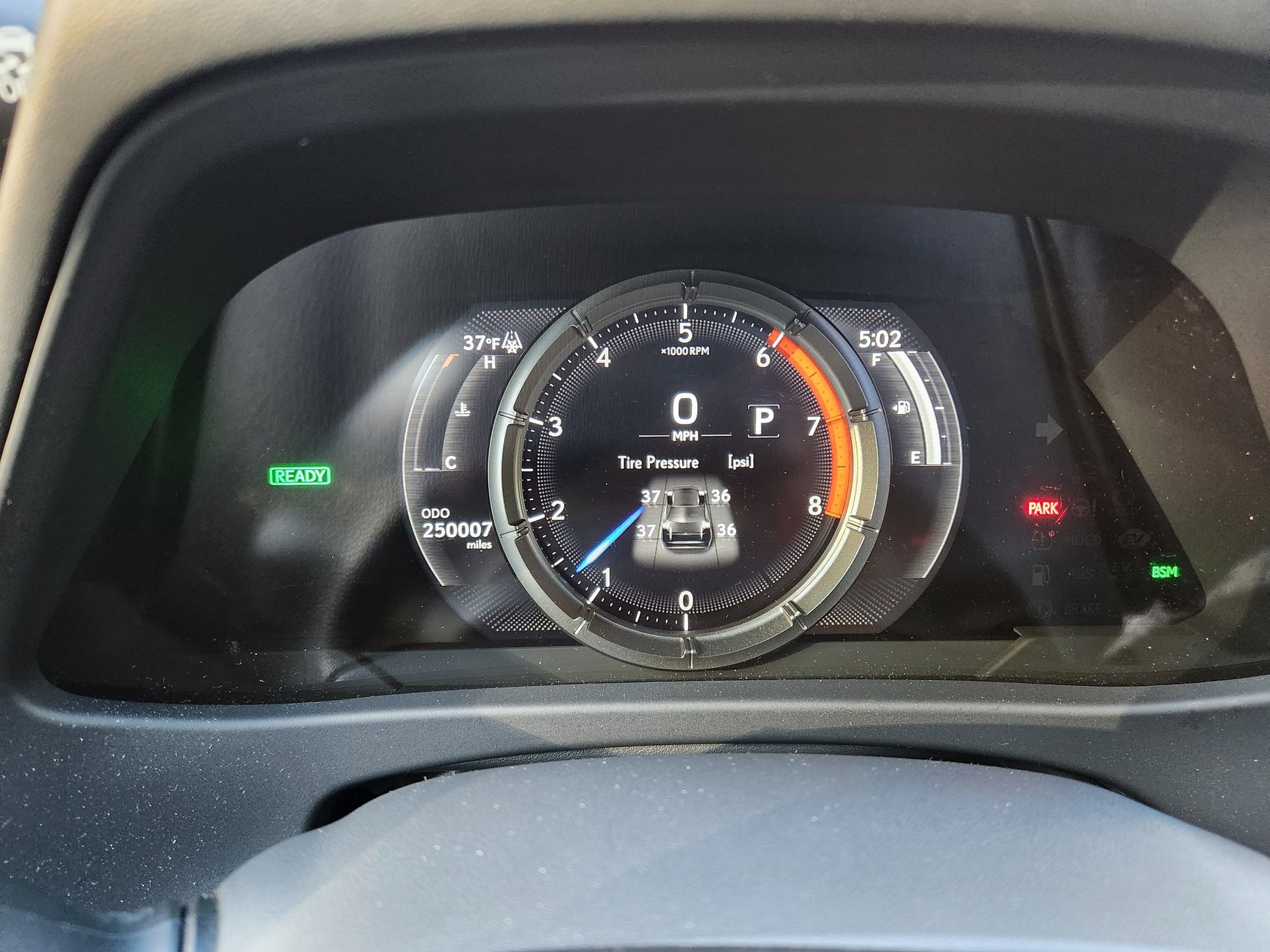

I joined the quarter million mile club on my way to work this AM.

Well done! I'm at 210k now. Also I didn't realize they changed the dash from 19 to 20.

What is different with the dash from the 19 to the 20?
I have had several vehicles that have ticked the 1/4 million mile mark but none have felt as good as my UX does. If we were still in the days of mechanical odometers I think you could easily clock my car to under a 100k and no one would second guess it. These cars are built incredibly well.

The F Sport Handling dash is different than the base trims.
