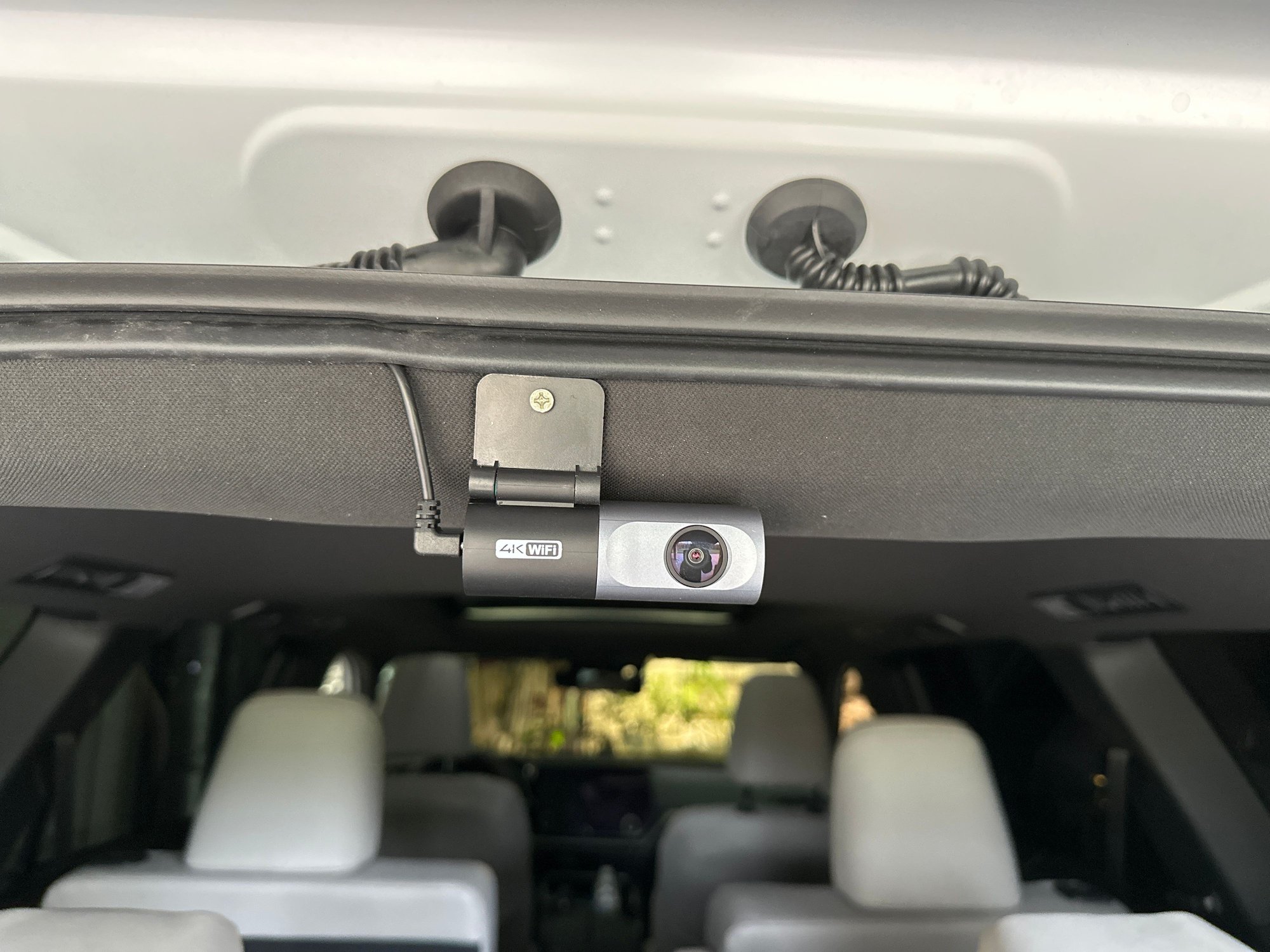

Default 2nd dashcam for the TX
Originally Posted by unknownone
I was considering installing a 2 channel dashcam with parking mode enable. Can anyone tell me where the interior fuse box is and whats the best way to route the wires?
there is a power outlet at the lower left corner of the truck, you can install the 2nd dashcam there, it is much better than the two channel rear camera ‘s resolution . It is slim design with WiFi connections to your cell phone when needing to watch the video. You can route and hide the wire in the trunk rubber seal

The front fuse box is on the left side of the driver foot rest. You need a tiny flat screw driver to pop out the cover clip and you can tab in the power outlet fuse. Negative wire you can connect it to a metal part. You will need a power voltage regulator to downsize the 12V to 5V, you can easily find it on Amazon
