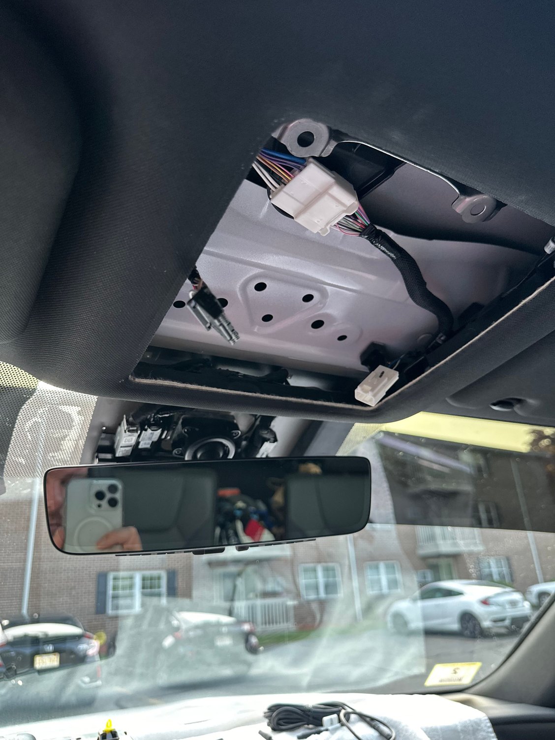

I just put in a FITCAMX. I took the oem one out because I wanted a uniform window tint strip and also a front plus rear channel camera.
the factory dash cam is wired into a harness with a connector next to the dome light in the headliner and is easily accessed by gently popping the 4 clips that hold the dome light assembly into the roof. There is one harness that attaches to the dome light assembly.
I personally spliced into the factory harness in the headliner to install my new dashcam. This allows me to get battery positive, accessory, and ground to the new camera so it functions the same with a parking mode. FITCAMX gives you a plug and play harness that taps off the adaptive cruise camera but it won’t give you parking mode because that camera is only powered when the ignition is on.
pics for reference. I can walk anyone through this who wants help. Feel free to shoot me a PM…

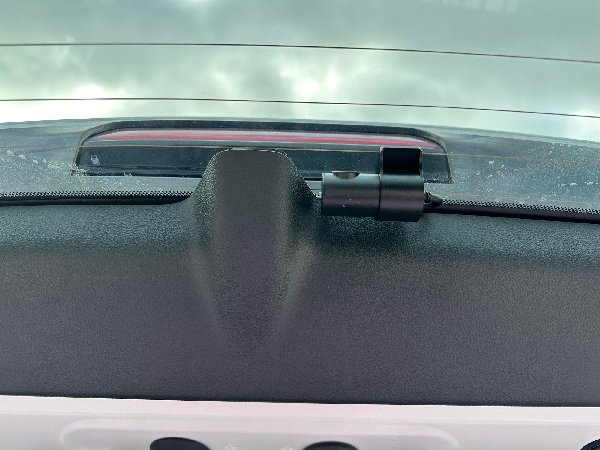

Not exactly a full how-to, but you can see some pics of my install here:
https://www.clublexus.com/forums/tx-...l#post11683746
To get to the rear of the car you can EASILY tuck wires into gaps between headliner. The hardest part, by far, was making it look "clean" by using OEM grommets from headliner into trunk door. If you're willing to make sacrifieces there, its super easy. If you're not willing, it could take an hour--or two--depending on your level of comfort of fishing wires and prying trim.

So far so good for the front and back. The most difficult part as someone mentioned was having the rear camera wire go through the OEM grommet. But mission accomplished with a little patience. Looks great and pretty simple to install.
pics for reference. I can walk anyone through this who wants help. Feel free to shoot me a PM…​​

Reviving an old topic. But how did you splice the Fitcamx to use the existing roof console open harness that was originally for the OEM camera? Which rear famera did you end up getting? Thanks!
i bought the one for the TX. I spliced in before the OEM connector by splitting the wire insulation and soldering it. I paired it with a rear fitcam option which plugged right into the fron fitcam so it was seamless. Would take pics but i now drive a BMW where the 360 parking camera has a built in drive recorder which is pretty slick
