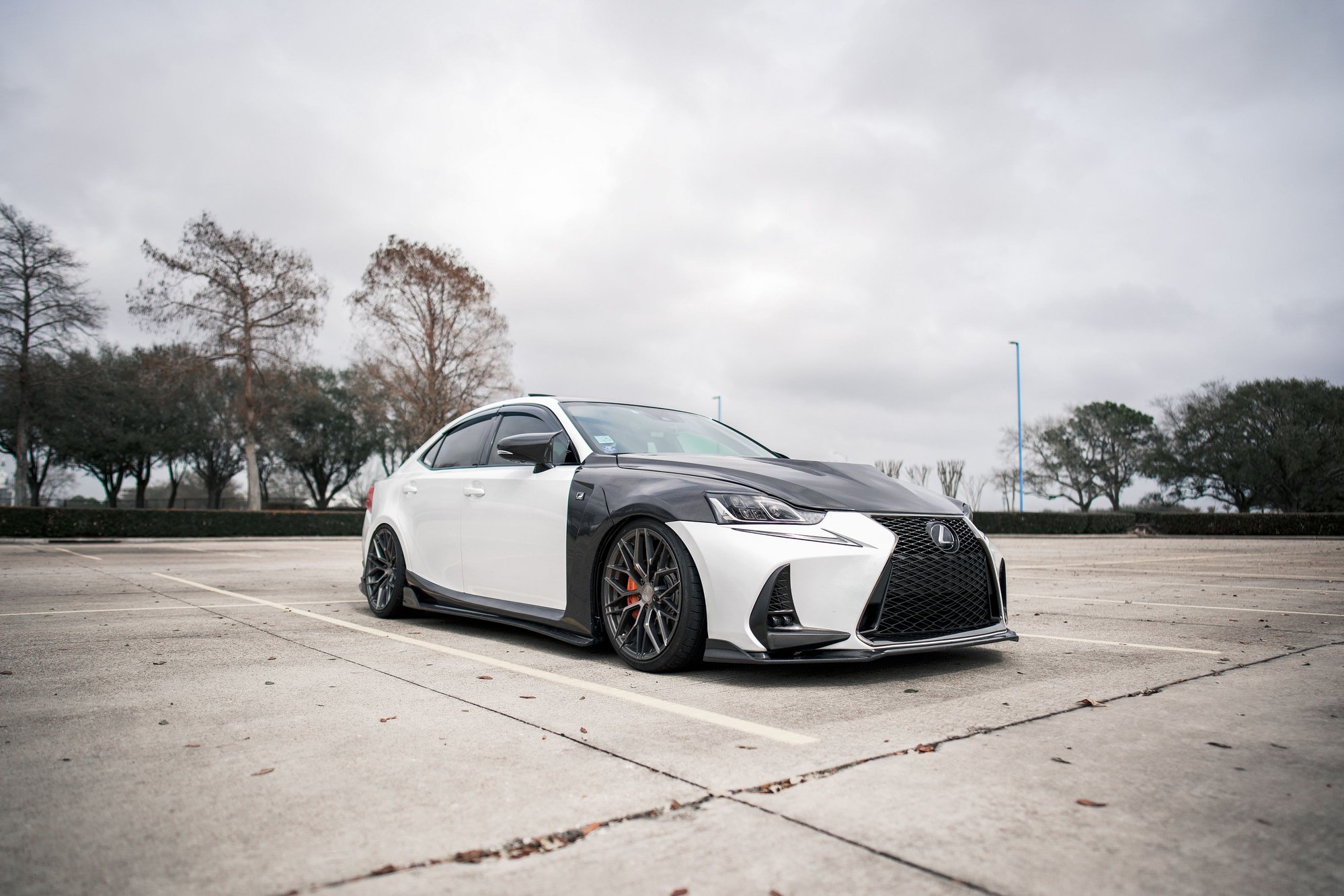

I’m in BC coilovers with upgraded swift springs and I slammed my car, depending on the dampening it’s really not terrible but it’s definitely oem ride quality especially if you run 19s. As for springs, super downs are doodoo ride quality and rsr is not terrible but not oem
Old Mar 4, 2021 | 06:10 PM
Getchkix's Avatar
Getchkix
Joined: Dec 2019
Posts: 17
Thanks for the recommendation, love the car by the way. I had to assume that lowering springs would only be good for lowering, but would jeopardize ride quality. Out of curiosity where did you get those side mirrors?
