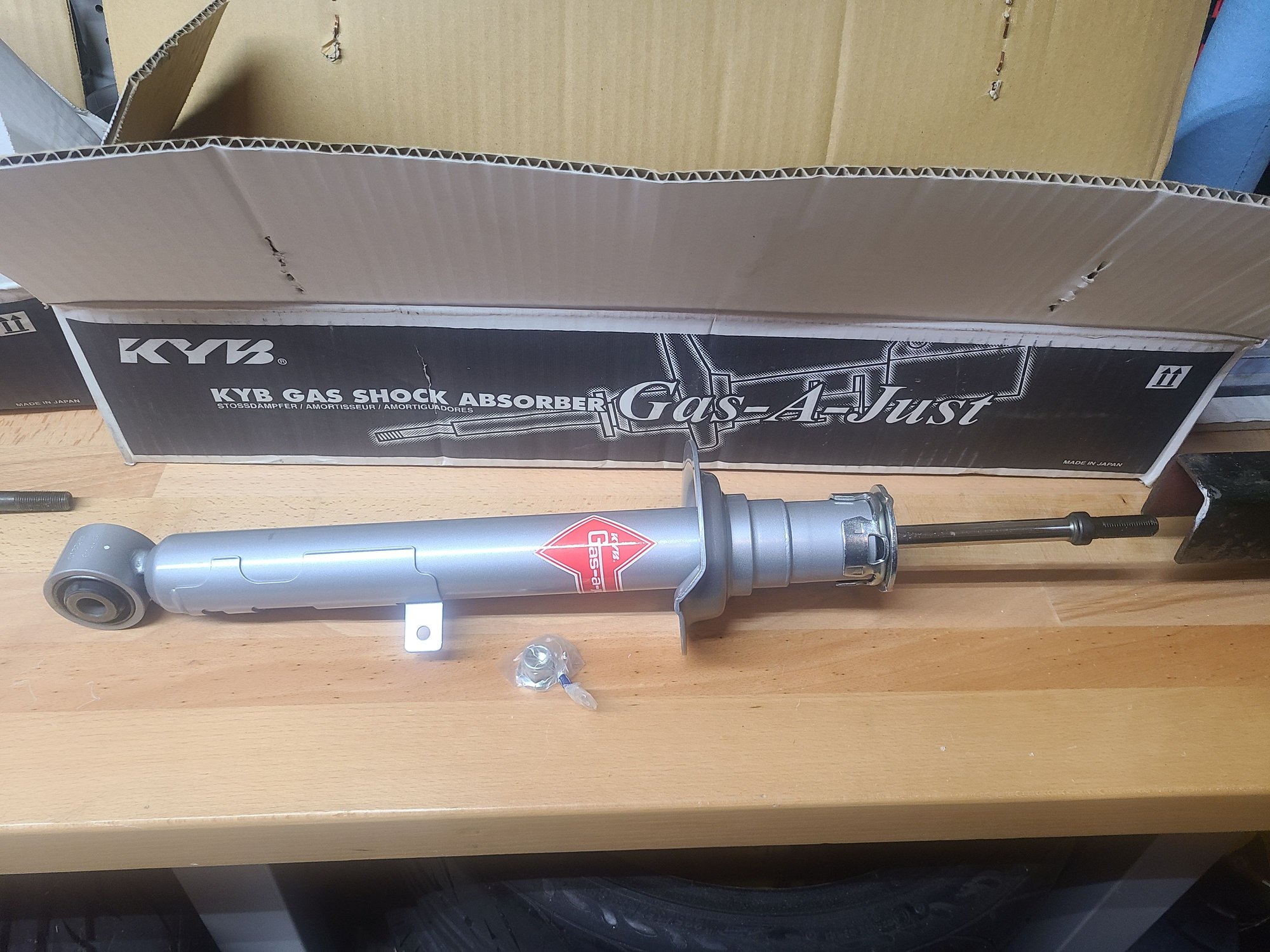

All, since my 2IS has now taken up near permanent residence in the garage due to COVID and my working from home, my Lexus doesn't get driven daily any longer. Sees maybe one trip outdoors a week.

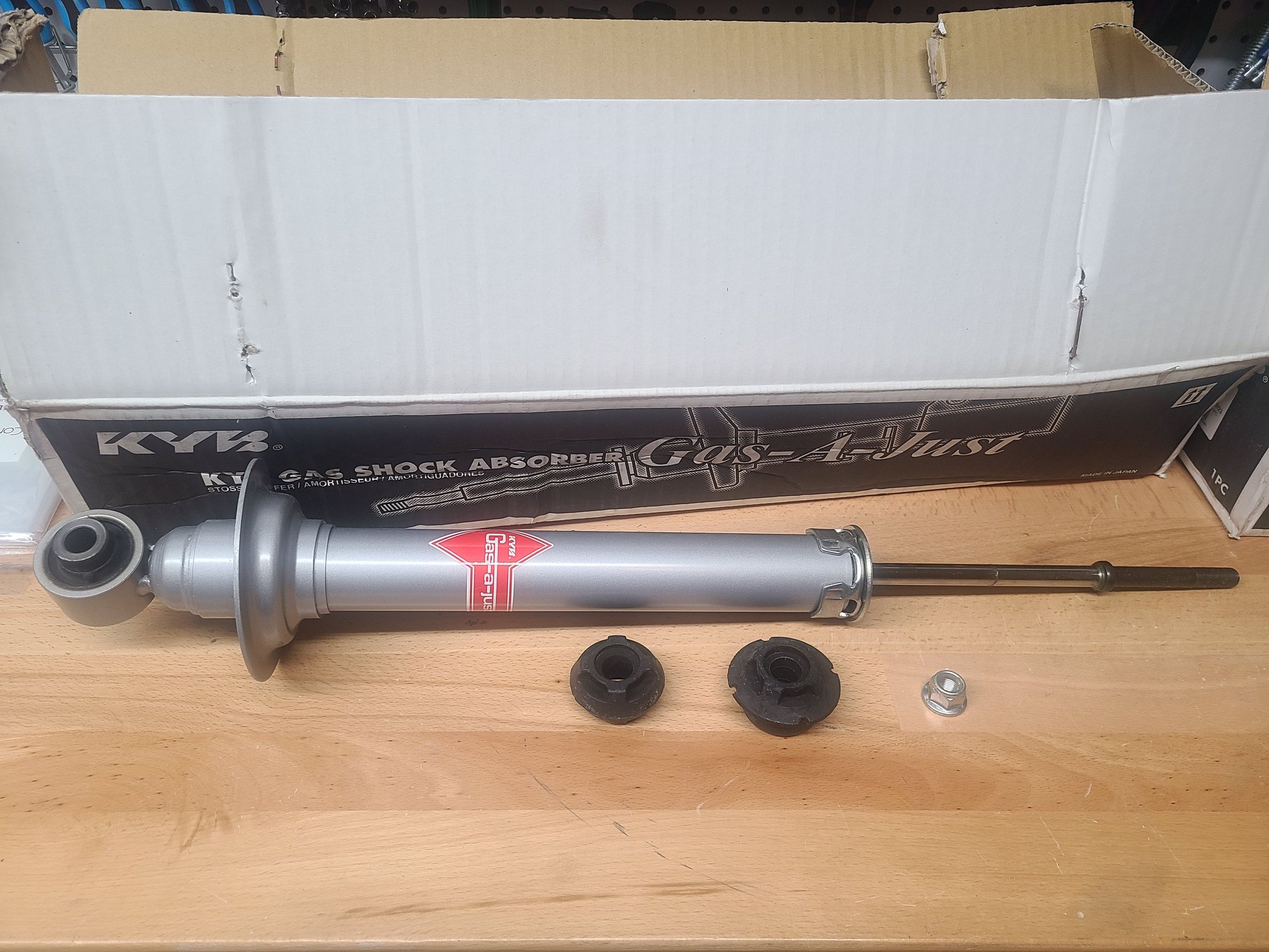

With this said, I've found the unused and worn factory suspension has officially met its useful life and it is time to install the KYB/H&R combo. Upon inspection of the new, aftermarket components from KYB and H&R, I probably have everything needed to replace my factory sport suspension with this KYB/H&R combo. BUT, before I get to the point of uninstalling the suspension, removing the factory top hats for use on this aftermarket combo, I want to be certain I have everything needed to complete this install as best as possible.
After some attempted researching, I was unable to locate any component-by-component pictures breaking down what all goes into the factory suspension setups (top hats, dust covers, bumpstops, washers, shocks, etc etc. So I'm left wondering, might there be any "wear" items that would be good to replace while in the middle of this install? Or is it simply uninstall the factory top hat and reuse on the KYB/H&R combo using the supplied hardware pictured below?
Thanks in advance!

If your front upper strut mounts need to be replaced I suggest you get them OEM from the dealer. I installed Swift springs and MOOG upper mounts from RockAuto and after 2 years the dust boots are completely ripped in pieces. The original ones lasted 7 years and were still ok when I took it apart, but decided to put all new hardware in when doing springs change over. Should've put the original upper mounts back on or get the new OEM ones. If you want longevity pay extra and use OEM boots (too bad they don't sell boots separately). If you don't care too much about dust boots then get aftermarket.

For the front, consider doing new upper mounts (they include the rubber boot and spring insulator), as well as the lower spring insulator. For the rear, consider doing new upper and lower spring insulators and bump stops.
48680-53031 - Mount, Front Suspension (Qty: 2)
48158-30020 - Insulator, Spring Lower (Qty: 4)
48257-30070 - Insulator, Rear Spring Upper (Qty: 2)
48341-30110 - Bumper, Rear Spring (Qty: 2)
Jeff

Finished the install on Labor Day. Was straight-forward, no surprises. LOVE the change from sloppy and bouncy to firm and planted EVERYWHERE. Oh, the lowered stance is a nice bonus too.
