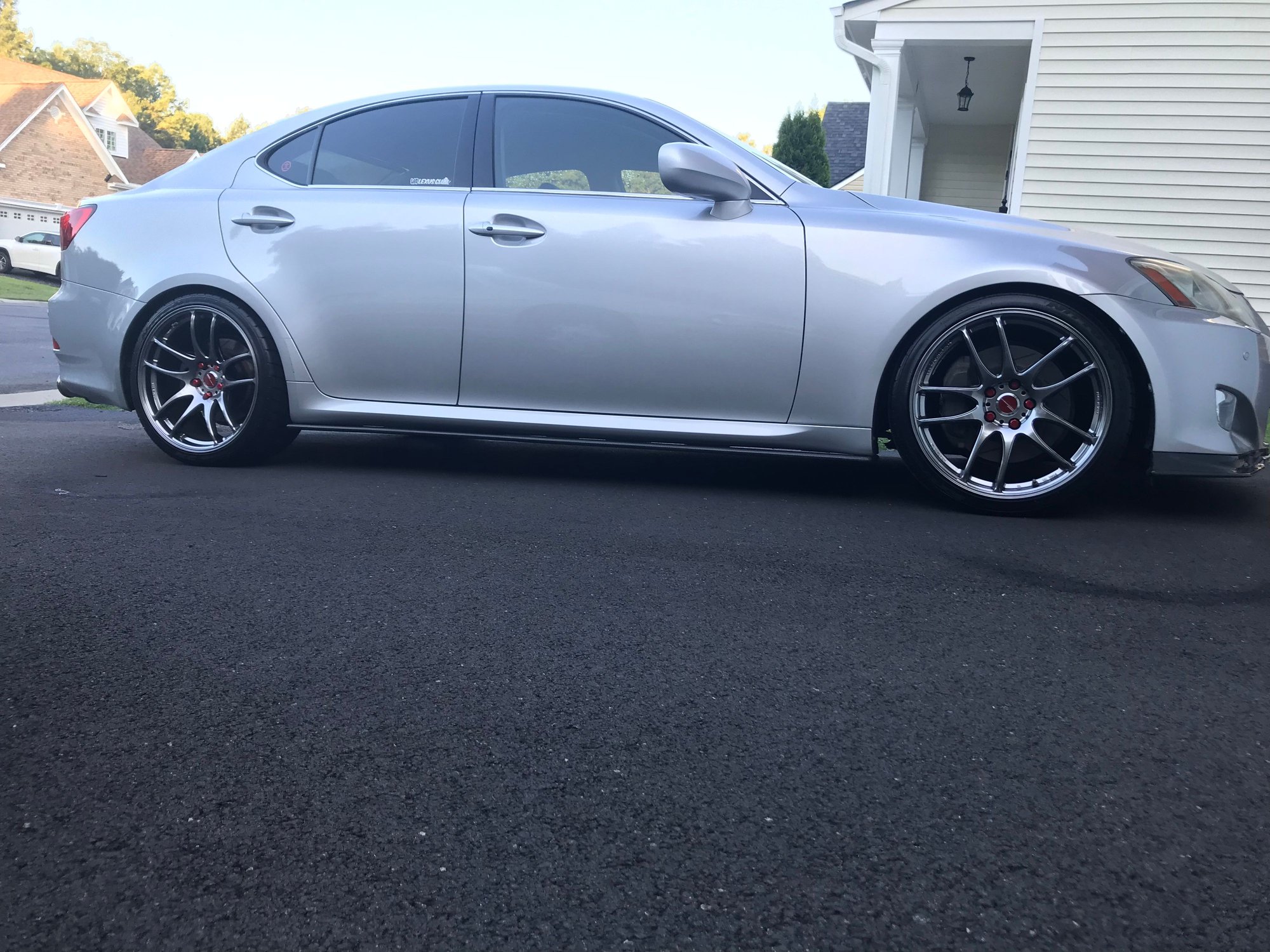

I have H&R lowering springs for now. Just ordered some Fortune Auto 500 series coilovers. The springs ride well and eliminate the gap perfectly. I actually won’t lower it too much more with the coils since I actually enjoy driving my car.

I never bought any additional parts to align my car. And I have minimal tire wear. Youll be ok on springs.
