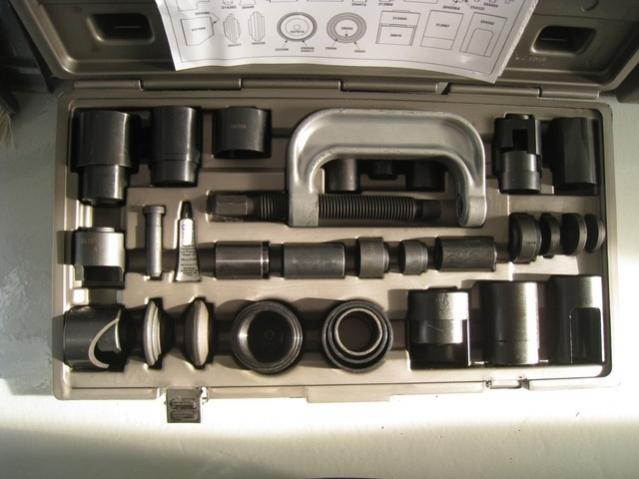

Lyonkster, how difficult was it to get the bushing in and out? I have the same ball joint press. I torqued it up to around 90 ft-lbs and it still didn't look like it was about to budge. Don't want to break anything, so I'm asking. Did you use a breaker bar or something? Also did the clamp ride up to axle boot. I tried to push it out without the 30 mm first and the clamp was pushing but it was rotating into the axle. I then used the 30 mm to push, but it still rotated some. I don't want to damage the axle boot.

^^^ You're torquing a bushing press tool to try and remove the bushing???

yes, look at the bolt in the tool (left end). as you turn the hex end, the bolt moves to the right and pushes the bushing out.
Yeah, I'd say it was probably around 90-100 ft-lbf. I used a 24" breaker bar, so I am just estimating. You are not going to break anything (except maybe the tool), so I would not worry about it. My car is rust free, but if there is rust on your suspension, it may take a bit more umpf to get it moving. Just make sure that the back side of the clamp is not resting on the bushing, but on a receiver tube. Otherwise you are just "clamping" the bushing itself, so it won't go anywhere. Hope that makes sense.
Looking at my first photo with the clamp in place, it looks like it may touch the axle boot. But for the left side, the torquing of the clamp tends to make it rotate down, away from the boot. If I recall correctly, I held the clamp with my left hand to keep it from moving, and torqued the bolt with my right. Once it built up some load, the clamp no longer wanted to rotate, so I put both hands on the breaker bar.

Actually I am in socal. West Covina to be specific, I just never changed my location. I'll try again tomorrow morning. I'm doing the passenger side, so the clamp is trying to rotate into the boot. I tried to hold it with my hand as well. But it still rotated once I moved both hands to the torque wrench. I'll shoot some wd-40 on it tonight.
Sounds good. You might want to start with the driver's side if you are right handed, I found it easier to work on that side for a rightie - you end up holding the clamp with your left hand and torquing with your right, plus the clamp would want to rotate away from the axle boot, all good things. Then once you get the hang of it, you can do the passenger side. Just a thought.
And not to insult your intelligence, but I have no idea of your skill level, so let me ask again - you do have a receiver tube on the back side of the clamp big enough to clear the OUTER diameter of the bushing, right?
i'm kinda lazy, so i think i'll just do the drivers side since that's the one making noise. i was going to do both, but changed my mind. and yes, the receiving tube is large enough, guess i just need to use some more force. i was just worried about damaging the axle since the clamp was turning into the boot.
