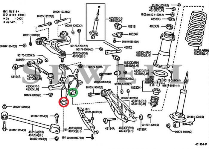

This question often comes up. This is NOT the correct bushing, this one is for the trailing arm (lower left corner), not the control arm (lower center). It goes into the red circled hole in the knuckle, but the one we are talking about here goes into the green circled hole.
Attached Thumbnails DIY - Rear Axle Carrier (Knuckle) Bushing Replacement-rear-suspension.jpg

That is a good point, I didn't even consider trying this because with my CA car, there was not a hint of rust and all the bolts came out easily, so it just seemed like an easy way to go. But you are right, if the bolts are rusted in place, and you can get the arm and the knuckle to separate enough to tdo the work without disconnecting the shock and the sway bar, then that's the way to go!
The bushing wouldn't go in WITHOUT filing it down!
This is surprising - was there a rusted lip on the knuckle? Hopefully you are talking about filing just the leading edge to create a chamfer, not the entire surface area?
vince that is the same bushing as this one from carson
http://www.l-tunedparts.com/product/?id=3322
